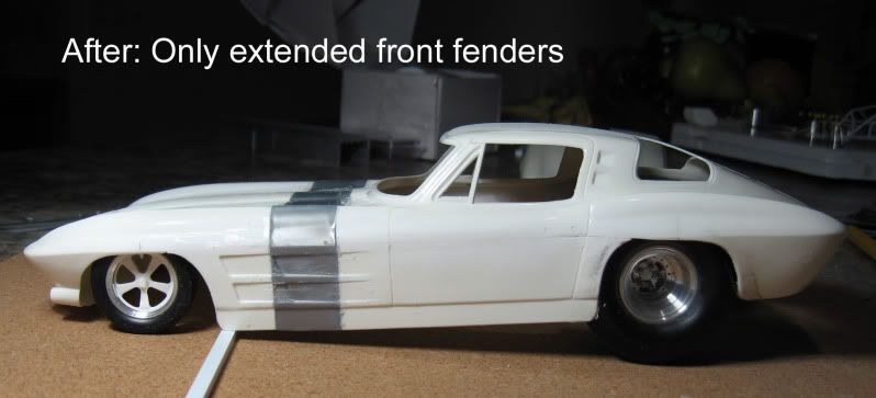

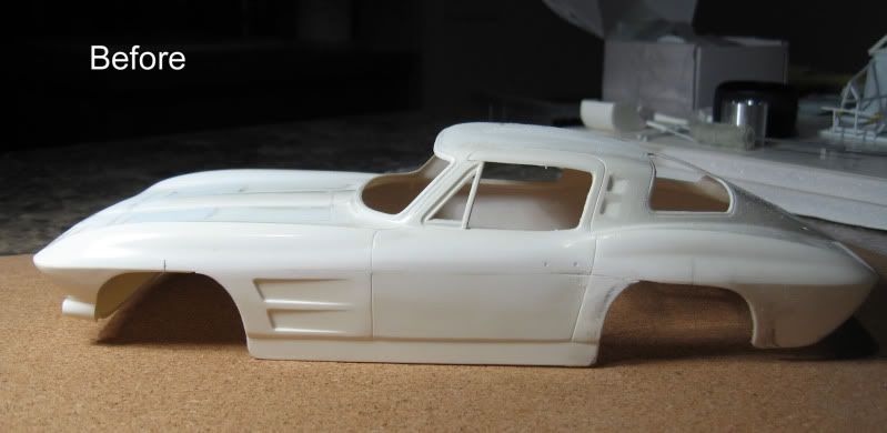

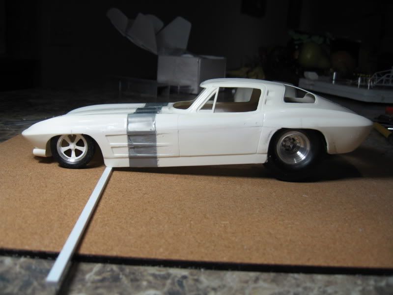

eviltwincustoms Posted January 20, 2012 Posted January 20, 2012 (edited) Not sure that I have graduated to the Big Boyz section or not... still wearing my training pants. lol Here is my next Pro Mod project, decided to play with the body a little bit since I am waiting on parts and getting frustrated with my block on my other project. Started with two of the 1/16th 1963 Corvette's and started hacking away... So far, I have been able to cut Horizontally down the side of the car to widen the lower section of the car and in the process of adding in 7/8" scaled up roughly 14" to the wheelbase to get 112". Once that is completed I will move to the nose of the car to drop it and lengthen it, so I come up with the 45" from center hub to the furthest point on the front end. Once I get that completed... hopefully tomorrow, I can begin to work on the rear section to fit those big meats out back. Edited May 18, 2012 by eviltwincustoms

eviltwincustoms Posted January 24, 2012 Author Posted January 24, 2012 Thanks Guys for the complements and checking in on my New Build progress. Well needless to say I have removed the front clip and Thanks to Dave (Comp1839), he has set me straight and now I am down the road to an extensive "Accurate Reproduction" of the 63 Pro Mod Corvette (The way it should have been done in the first place. LOL.. ). If I am going to go to this much trouble, I might as well do it right. In less than three day's I think I have learned a crash course in 1:1 Pro Mod body modification and what exactly goes into stretching these Vette bodies out to the 115" wheelbase that most are running these days. Like the old adage goes, Measure twice and cut once... Well I think I have measured 5X's that in every direction, that I have numbers running out my ears just to make sure I am scaling this thing out to be as accurate as possible. You realize Chris, that once your Funny Car goes to the side and you start working on the Pro Mod. That will be it! You will be hooked. Hey Niko, I use to like the smaller scale a lot better as well due to more parts and bodies to choose from. However... this is the BIG "BUT".. The larger 1/16 and up, is such a great challenge, it may be easier to see, but you have more room for details that the smaller scale doesn't lend itself to. In addition to that, the larger scale is more like working with 1:1. I have found this out first hand with this build. I can't just extend the nose on my Vette, like I could have done in 1/25th scale and still look right. I have to do much more to my car, and I will point those things out in this thread as I go. Rick (pharr7226), Thanks for the complement, I really appreciate it because the positive reinforcement will keep me focused on this new side project. Actually at this current stage, I have updated pictures just need to get them posted. But I have removed the nose, due to other modifications I have to make before getting to the front of the car. I will try and get my latest pic's up for everyone!

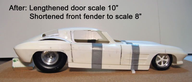

eviltwincustoms Posted January 25, 2012 Author Posted January 25, 2012 (edited) Here is a small update after going back and completely taking things back apart. Since the first mod of just extending the front fenders was WAY OFF! I had to take it apart and follow the more extensive way of just doing an accurate reproduction of the 63 Vette. So after extending the Doors and going back and reducing the extension of the front fenders I am now sitting at 115" wheelbase and I have to say it looks much better with the changes. I have made some slight changes to the body thus far in addition to extending it. Rear fenders have been opened up for tires to fit, started to mold the rear fender well, so the tire will sit in its resting place. Also made a slight change in the trailing end of the passengers side window and adjusting the doorline. Next is to address the A-Pillar by laying them back and bringing the top down to be more Horizontal to the main plane and not slope back as much. Then address the front fender in front of the front wheel. Edited January 25, 2012 by eviltwincustoms
eviltwincustoms Posted January 26, 2012 Author Posted January 26, 2012 bart, bart, bart,.........what can i say. you are heading down (in my opinion ) the path to awesomeness. this body is coming out to be very close to the real mckoy. are you planning on having this thing re-popped? if you finish as well as you've started it would be a shame to not have this thing molded and cast. keep up the go for it attitude and don't accept second best. Thanks Dave for the feedback, I really appreciate the feedback you have been providing! My intentions are to get this thing as close to the real thing as possible.... As long as my skills will let it happen. lol.. I never gave it much thought but getting re-popped, but it would be cool to have it cast. I wouldn't have to worry about it as the body ages.

eviltwincustoms Posted February 13, 2012 Author Posted February 13, 2012 gonna be sweet! love that look with the nose stretched out!, they should have come from the factory that way! nice work Bart! Thanks Bill for the nice words... It was a pain to extend the front fenders.. But not just the fenders, I have extended the doors and in front of the centerline of the front wheels. Still a lot of body work to go.. And then getting everything to lay down smooth will be the challenge.

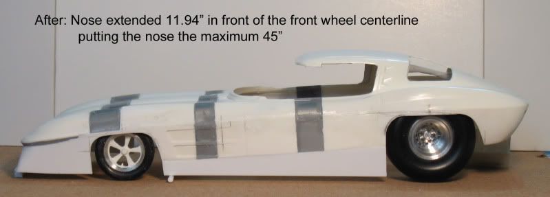

eviltwincustoms Posted February 14, 2012 Author Posted February 14, 2012 Okay.... so... I have a small but mighty update for everyone. I had been contemplating just how I was going to do the front clip and get my angle, but I think I pulled it off quite well considering. I cut the nose off at the Centerline point of the front wheel and extended it out so that now the car meets the Maximum requirement of the 45" by ADRL rules. And where she sits currently with the nose extended and addition of the Rockers in place. Let me know what you think of the new updates. Thanks,
Mooneyzs Posted February 14, 2012 Posted February 14, 2012 Bart that is sure looking great man. You are doing a heck of a job on this build so far. I have been enjoying following along with this build. you are making me want to start on my pro mod lol
Prostreet Posted February 14, 2012 Posted February 14, 2012 Nice work Bart, your becoming a styrene master.
