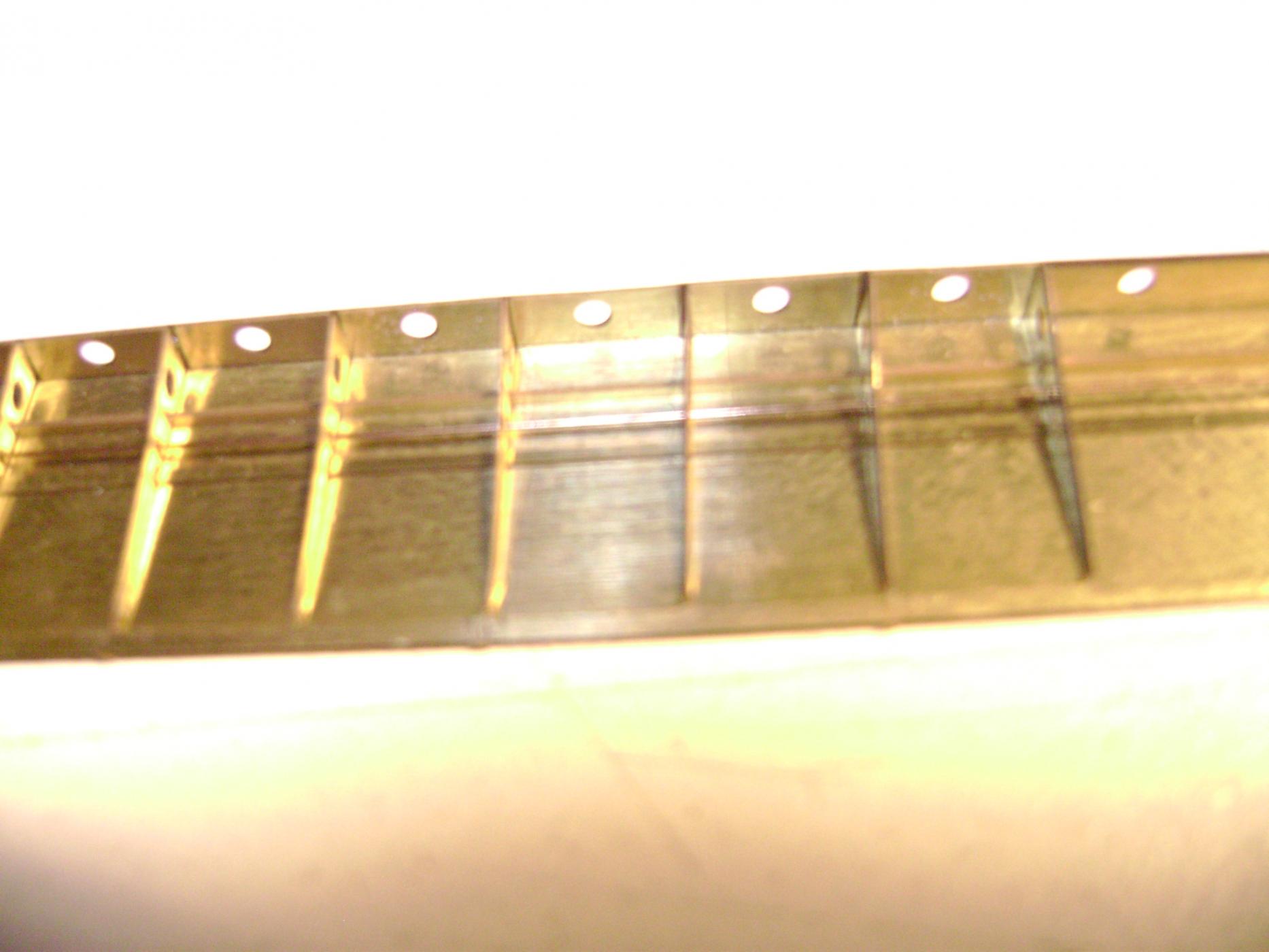

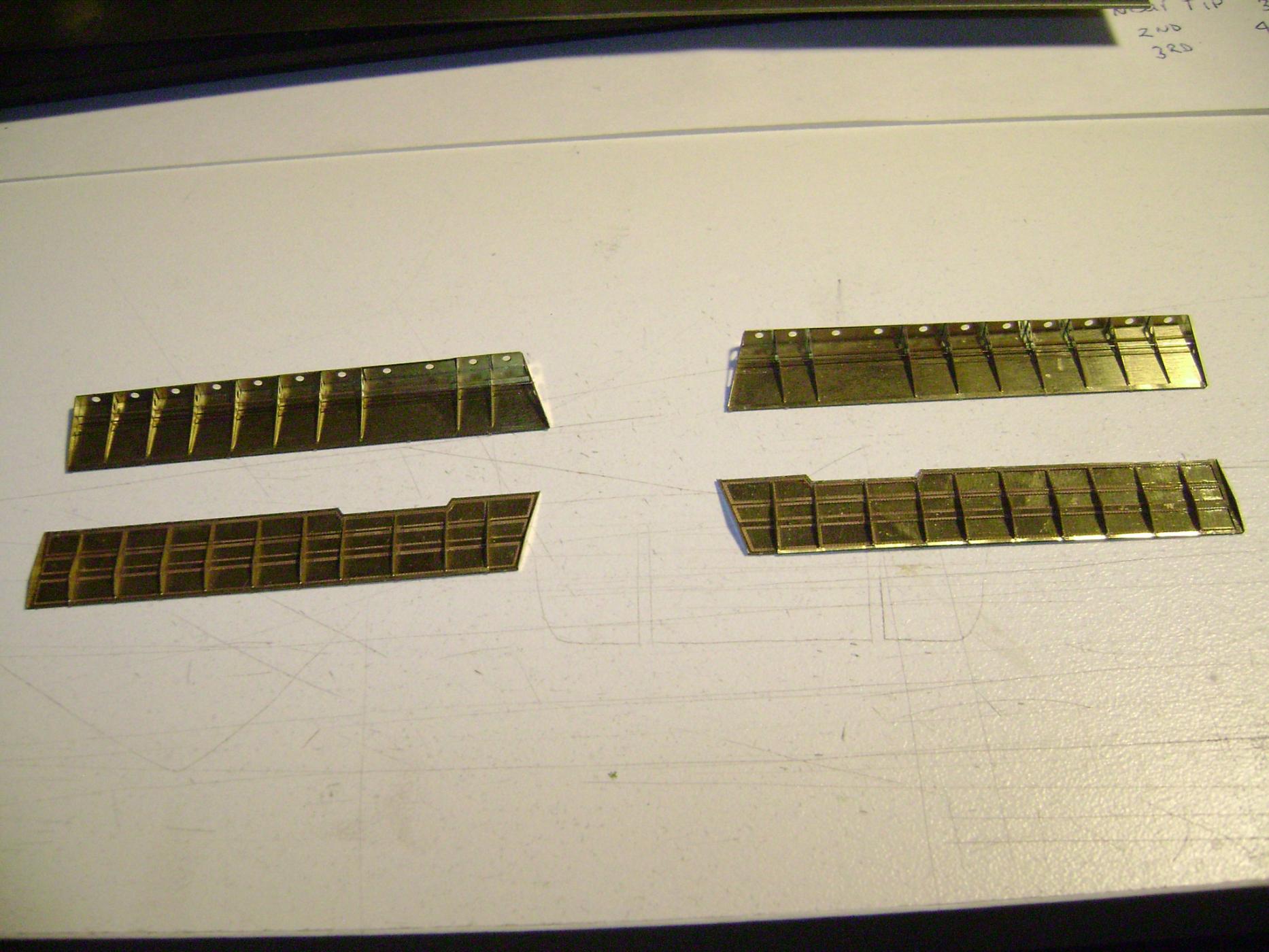

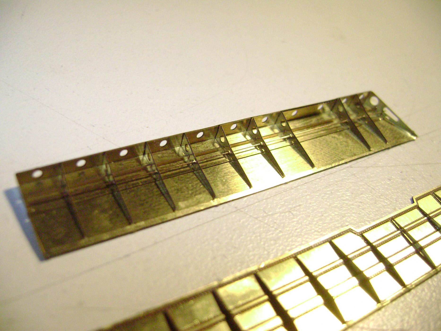

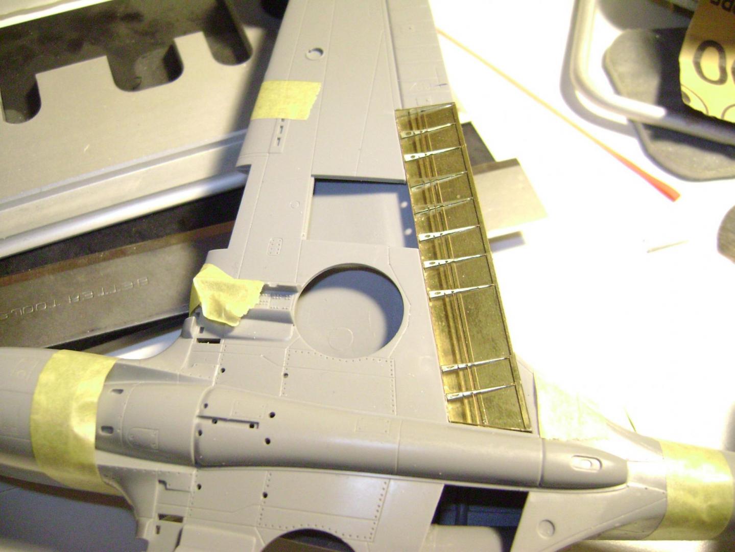

wisco8 Posted September 21, 2016 Posted September 21, 2016 Here is some really cool stuff to use, its Micro-scale decal restorer. Its used over older decals that have been cracked. I used it to do the photo-etched flaps on this 1/48 P-40N Warhawk, it shrinks to invisible. The way I used it was I dabbed a little where I want to place something and held it for a few seconds then added more until I was happy it wasn't going to fall off. I did a pull test also and it worked pretty good. Try it with a spare and see if it works for you. Best regards, Steve Cook
