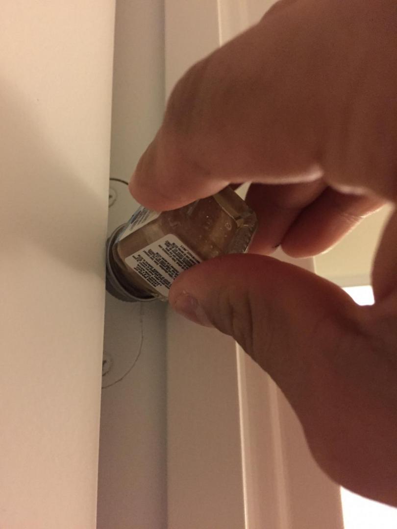

Andres Posted November 5, 2015 Posted November 5, 2015 (edited) This method always work, grip it hard with a door and then twist it. Edited November 5, 2015 by Andres
