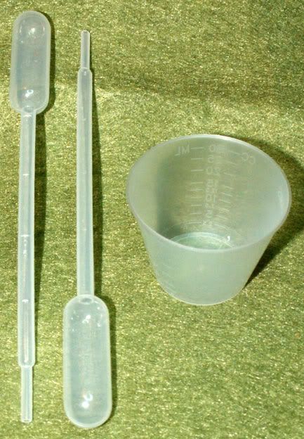

Longbox55 Posted March 31, 2012 Posted March 31, 2012 I use dose cups for measuring and mixing paint. For thinner, I have used syringes, which work very well. Never had an issue with the plastic clouding, even with laquer thinner. I did have problems with the rubber on the plunger gumming up, though. Anymore, I tend to use the pipettes that Testors sells. You can get them pretty cheap, last time I got some, they were in a set that had 6 1/2 ounce jars w/ lids.
Erik Smith Posted March 31, 2012 Posted March 31, 2012 I use pipettes. Google them online and buy them in bulk - they are considerably cheaper and you will get so many you won't feel bad every time you are too lazy to rinse it out.
Mike Kucaba Posted March 31, 2012 Posted March 31, 2012 Pipettes are the way to go! Get them in bulk like the others said.I think I've even seen ones as large as 1/2 oz. You can also use empty paint jars like the Testors ones. They have 1/4 oz. 1/2 oz. and 1 1/2 oz size. I never or rarely toss a jar,they go in my super clean bucket to get the residue out.
tabsscale1 Posted March 31, 2012 Posted March 31, 2012 I use the pipettes and the dose cups that way if the paint says 4 to 1 mixing ratio I can put 1/4 once of the thinner in one dose cup and then 1 once in the other. the pipettes are just to transfer the 2 componets out of the can or bottle they are stored in. Most of the time though I just mix the paint to a milk consistency.

Tonioseven Posted March 31, 2012 Posted March 31, 2012 (edited) Like the others, I use the plastic pipettes; lacquer thinner doesn't cloud the plastic ones. Edited March 31, 2012 by Tonioseven
MikeMc Posted March 31, 2012 Posted March 31, 2012 I use graduated epoxy cups from great plains... I get them thru Tower for 3.00 for 50...they are lacquer proof

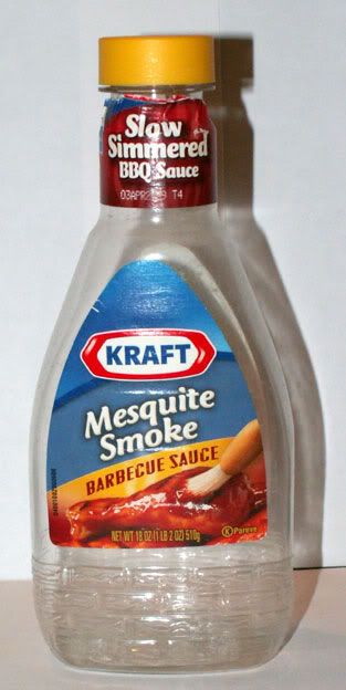

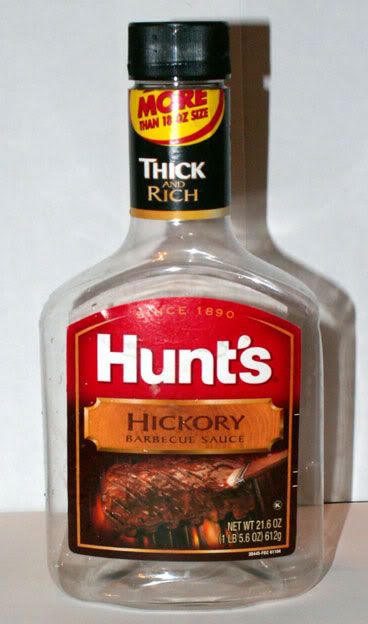

CadillacPat Posted March 31, 2012 Posted March 31, 2012 Look in your local Yellow Pages for Medicinal Supply Stores. You can purchase 1oz. graduated medicine cups usually $4 for 100. I buy mine online by the 5000 lot for about 1/2 cent each. I also purchased a 10,000 lot of graduated Pipettes but since the Medicine Cups are so easy to read I rarely use the Pipettes except for adding small amounts of prepared paint directly into the AirBrush cup. I've sold most of my Pipettes to other Customizers online. Both Pipettes and Graduated Medicine Cups are made from LDPE (Low Density Polyethylene), the soft squeezable type plastic you find in Ketchup Bottles or Barbecue Sauce Bottles. These type plastic bottles are great for storing premixed paint or paint you have removed from aerosol cans. This LDPE will not react to Petroleum products as does HDPE (High Density Polyethylene) similar to Styrene. CadillacPat
