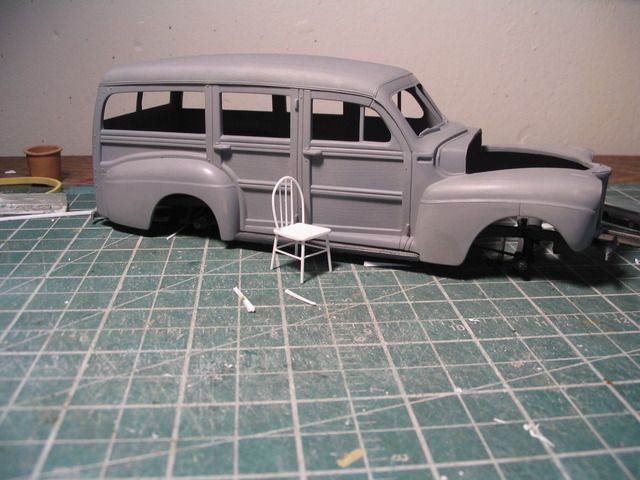

noname Posted May 10, 2012 Author Posted May 10, 2012 (edited) Good one Nitro Neil. Thanks for your comments guys. Here is a pic. Even though the chair looks a bit bigger in this photo, don't ya think it still looks a tad small? It is the chair I actually model in. Edited May 10, 2012 by noname
sjordan2 Posted May 10, 2012 Posted May 10, 2012 So, show us the chair you model in next to your own car. Looks good to me. As for the conversion question, just bookmark a conversion site like the one listed above.
noname Posted May 10, 2012 Author Posted May 10, 2012 I thought of doing that. The chair really does look smaller in real life. Any other opinions?
Dr. Cranky Posted May 10, 2012 Posted May 10, 2012 It's hard to say from the picture, but I find it works fine . . .

Jordan White Posted May 11, 2012 Posted May 11, 2012 I have the same kit, so I took a measurement of the body height, which is about 2.5". In the picture, the chair appears to come up to just below the door handle (taking in to account the angle), which is approximately 1.375" high. Converting to 1:1, the body is about 62.5" high, or just over 5 feet. The chair is then approximately 35" tall, or just under 3 feet. That seems a little short to me. What are the dimensions of the actual chair?
noname Posted May 11, 2012 Author Posted May 11, 2012 (edited) Thanks for all your opinions and charts guys. Math was never my strong point. The chair has legs 16 inches long. My little guy has legs 14mm long. The back of the chair is 32 inches high from the floor. My scale chair is 31mm. The width of the front of the chair is 15.5 inches wide, and mine is 15mm. So I am off a tad, probably from sanding. I wouldn't think that little bit would make that much differnce. I did a rocking chair before this chair and that appeared small as well. Although it looks a little bit better than this chair. I actually took the 1:1 chair out and sat it beside my car. It actually looks small beside my car as well. So maybe I'm not that far off. It does come up higher to my door handle, but I'm not driving a Woody either. I am in the process of making a chair slightly bigger in mm than inches of the 1:1. It could be that this one "appears" more in scale. In starting this thread I was mostly interested in weather 1mm=1 inch is a good rule of thumb. It would appear that most of us is comfortable with this. I will have to look more at all the supplied charts. Edited May 11, 2012 by noname

SSNJim Posted May 12, 2012 Posted May 12, 2012 The chair has legs 16 inches long. My little guy has legs 14mm long. The back of the chair is 32 inches high from the floor. My scale chair is 31mm. The width of the front of the chair is 15.5 inches wide, and mine is 15mm. <snip> So maybe I'm not that far off. I took the liberty of figuring out what the size of your chair would be in 1/25 versus your model. First I divided 1 by 25, and came up with .04. I multiplied that times the length of your 1:1 chairs leg (16"), and multiplied that times 25.4 to get the size in mm: 16" = 16.25mm 32" = 32.5mm 15.5" = 15.75mm Looks like it is fairly close, but I would be interested in seeing the results of the second chair just for comparison's sake.
