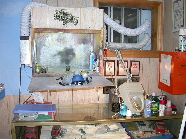

dptydawg Posted July 14, 2007 Posted July 14, 2007 I used the booth pictured here for several years and just recently built a new downdraft version that also vents through the window. This booth is built from plywoood wall paneling and a pair of bathroom fans that are ducted via dryer ducts to the window. The overhead fan causes dust to fall on the models so I recomend either side or downdraft fans. The organic vapour mask is not an option, It is a must! My new booth vents through the same window but the unit is now portable and I used a piece of P;exi with a couple vent louvers to hold the hoses in place in the window. I use this setup all year round and it seals well against the sub-zero temps we get up here Thanks Carl Avis

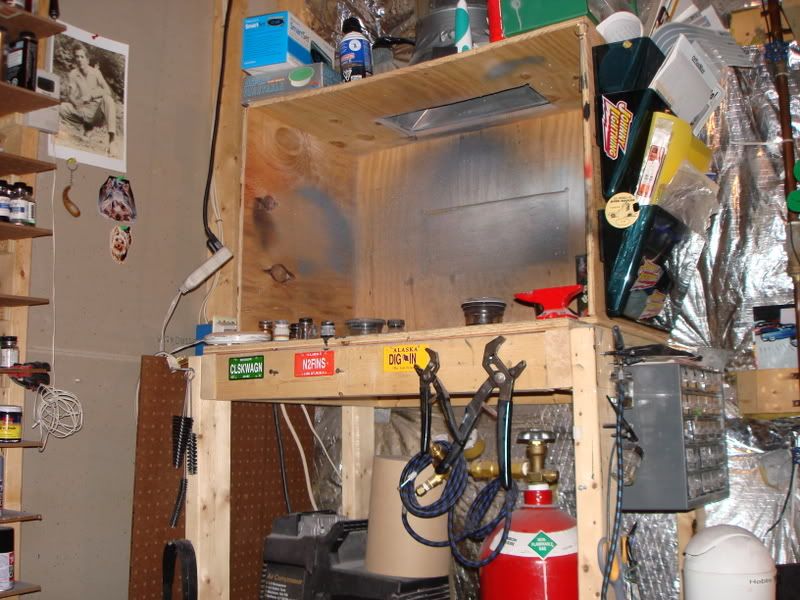

hookedonplastics Posted July 15, 2007 Posted July 15, 2007 m408 (I would use your real name if it was posted ): Here is a photo of my set-up: And here is the layout for 2 booths cut from one 4x8 sheet of plywood: I used an 80cfm bathroom fan for the down draft exhaust. The booth itself is made out of 1x2 pine furring strips and 1/4" underlayment plywood for use under vinyl flooring. The 1/4 ply helps keep the weight down. After I made the layout plans and built the booth, I added a cut-out at the top for an aquarium light. I covered the hole with thin Lexan. I hope this helps. If you have any questions, please feel free to e-mail me! Russ
didgeytrucker Posted July 15, 2007 Posted July 15, 2007 The computer cooling fans won't flow enough air to remove the fumes. And the fumes are flammable (explosive!) Be careful with a fan with the motor in the airflow such as computer fans. The best is what is known as a squirrel cage where the motor is outside the airflow. Look at the fan on your car's heating A/C system for an example (if you have ever replaced it you know what I'm talking about. Tracy
