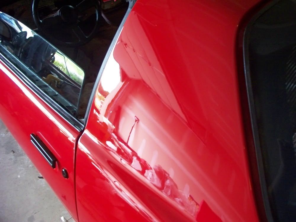

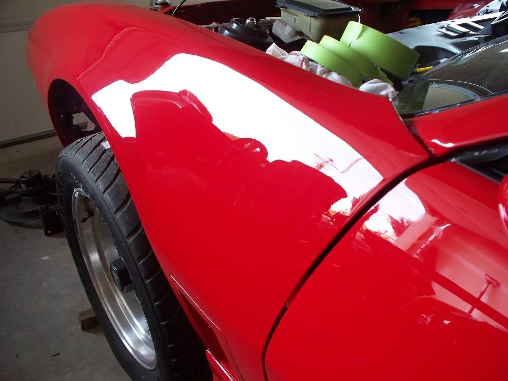

Hawk312 Posted June 15, 2012 Posted June 15, 2012 Here is the two part urethane mentioned above on my 1:1. It sprays on beautifully, but the pattern is *very* large...so large in fact, that it is similar to my 1:1 spray gun! The pics are after sanding and buffing of course. And as someone else mentioned,it is very durable. Also, I`ve used duplicolor clear for years on my models with great results! The Big Scale Beauty was sprayed with it, color and clear.
