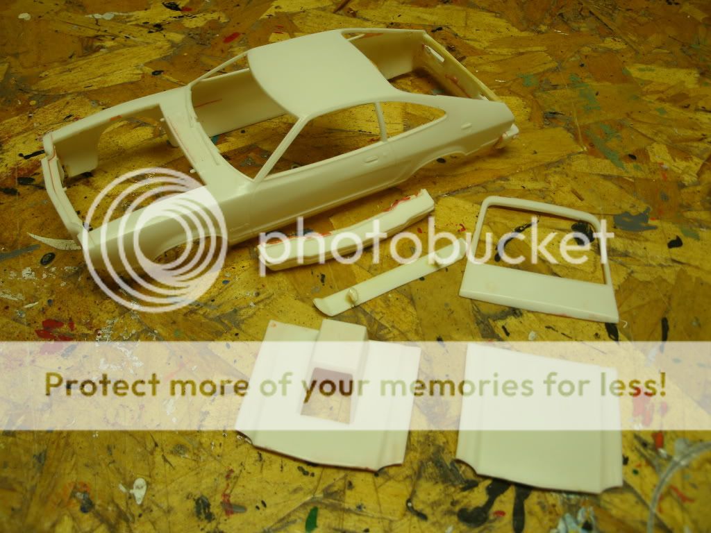

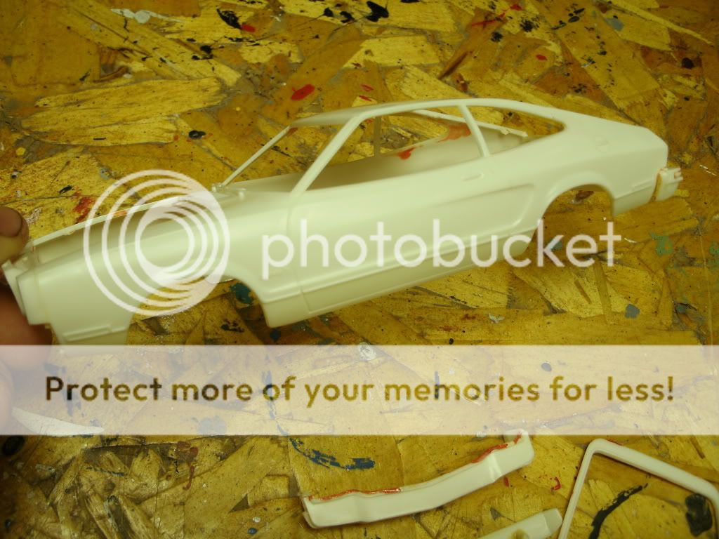

Nick Winter Posted July 28, 2012 Author Posted July 28, 2012 Thank you very much Dan, I like the idea of the spoons, I will try that for sure. I will also wash the body and its parts down in dawn soap. I have just pulled out my AMT '76 Mustang II and well I'll let the photo's do the talking. Really do appreciate the help everyone. Nick
