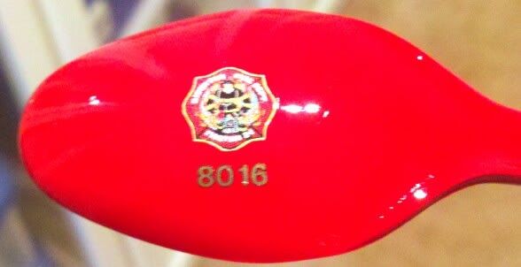

hooknladderno1 Posted February 9, 2013 Posted February 9, 2013 I recently did the old "spoon test" over white, gray, red oxide and black primers to see which one would give me the shade closest to what I was trying to match on some 1:1 replicas. I always knew that the primer color would make a difference , just not how much! Boy, was I surprised! Do yourself a favor, get a pack of plastic spoons at the dollar store, Walmart, etc, and give it a try! You will be amazed... The color that I sprayed was Krylon Cherry Red, to match some fire apparatus that my hometown once ran. Before having "custom paint" mixed up, I thought I'd give it a whirl.. Turned out the gray primer worked best.
