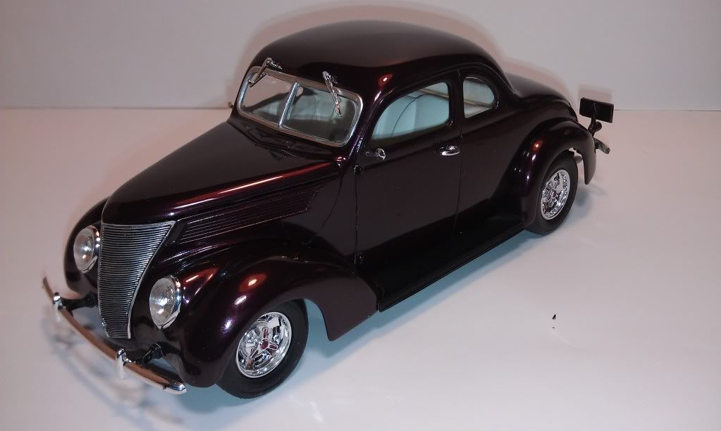

azers Posted March 14, 2013 Posted March 14, 2013 (edited) I have paintjobs as old as 11 years old i used tamiya clear. Close to the same formula as testors and have had no yellowing problems. This was painted in 2002 and cleared with tamiya clear. I wait a day or two so paint gasses out then i spray a few light coats of clear. Let that dry a few days. Sand any dust bunnies or fuzz out. I put on a few more coats of clear for coverage and polish out after a week. Thats my way. As far as decals i polish out then put decals on. I havent had the confidence to clear over decals after applying them. After my last disaster. Edited March 14, 2013 by azers

ForcedAWD Posted March 14, 2013 Posted March 14, 2013 I [img=http://i1304.photobucket.com/albums/s530/99jeepdad/misc%20reference%20photos/IMAG0004_zps279c6a98.jpg] have paintjobs as old as 11 years old i used tamiya clear. Close to the same formula as testors and have had no yellowing problems. This was painted in 2002 and cleared with tamiya clear. I wait a day or two so paint gasses out then i spray a few light coats of clear. Let that dry a few days. Sand any dust bunnies or fuzz out. I put on a few more coats of clear for coverage and polish out after a week. Thats my way. As far as decals i polish out then put decals on. I havent had the confidence to clear over decals after applying them. After my last disaster. Do you recall what paint you used above? I would love to use that color for a build I'm working on.
azers Posted March 14, 2013 Posted March 14, 2013 It is called cranberry wine pearl. It was used on chrysler pt cruisers. You can get the color in duplicolor spray and use the m.m. lacquer spray on it since tamiya clear is unavailable. I have even sprayed the testors clear over the tamiya clear with no bad results. By sanding between clear coats and putting on two more wet coats you get virtually no orange peel. By the way if you want the duplicolor number i can get it for you.
