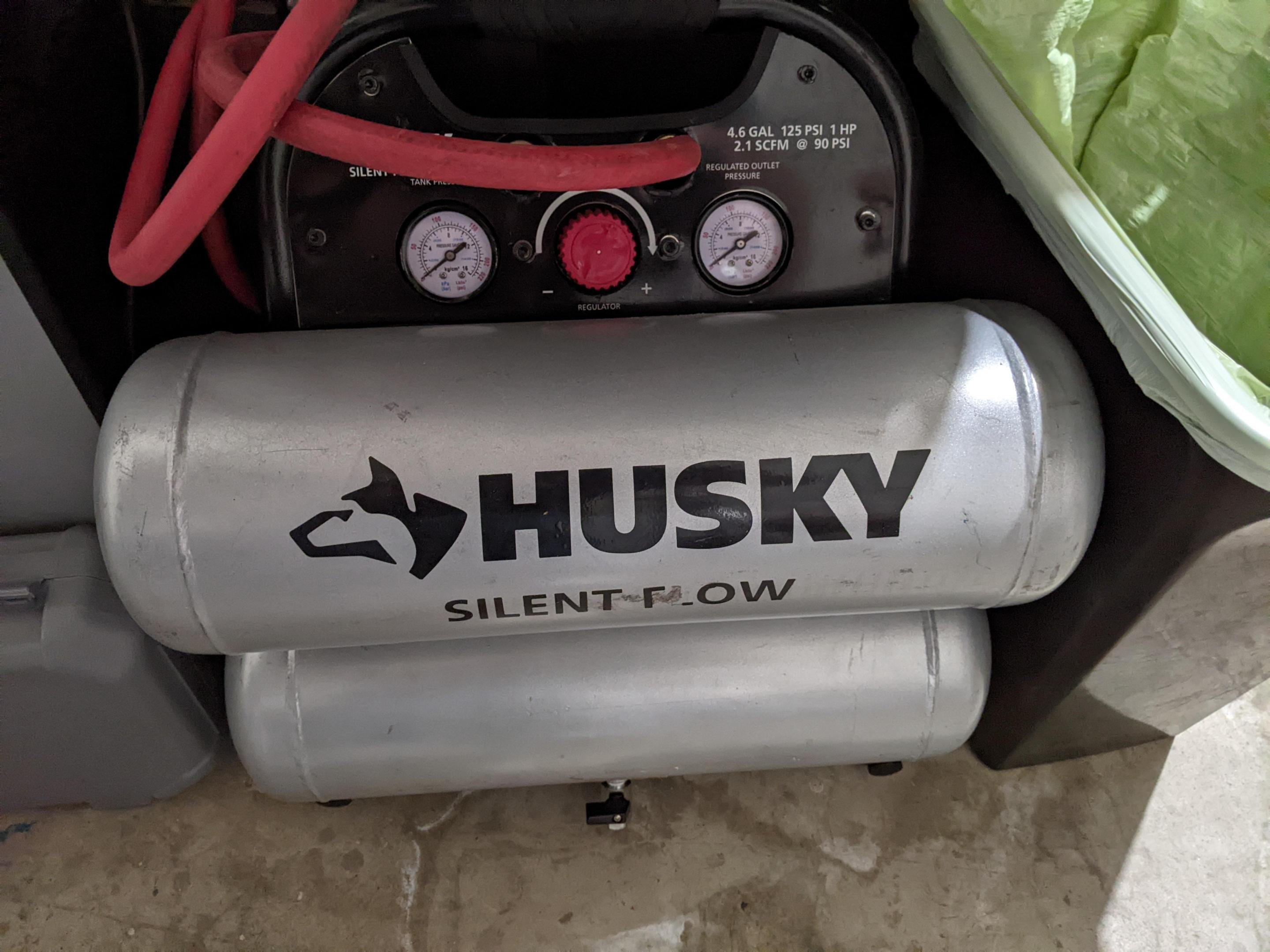

Rodent Posted January 6, 2022 Posted January 6, 2022 I got this from my boss a while back for pennies on the dollar. I previously had an El Cheapo that sounded like someone was jackhammering the driveway. It's perfect for car and bike tires and the airbrush. And it's amazingly quiet.
