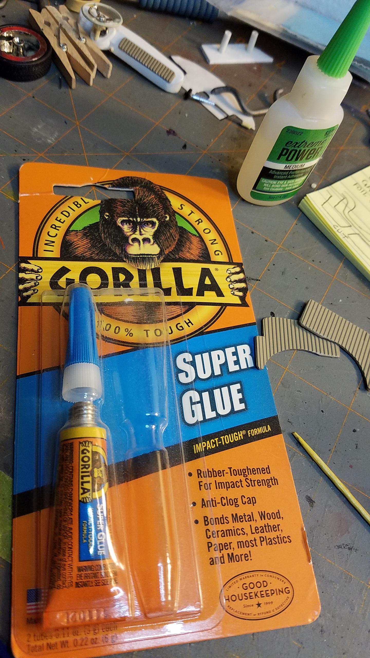

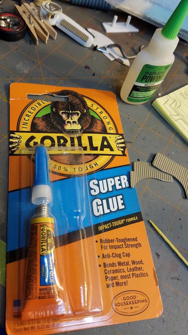

Jon Cole Posted April 24, 2019 Posted April 24, 2019 (edited) Anyone familiar with this type of super glue? Does it work as good as the bottle stuff also shown? Edited April 24, 2019 by Jon Cole
DON-T2 Posted April 24, 2019 Posted April 24, 2019 I use the Gorilla super glue a lot. Prefer the twin pack set at Lowes or Home Depot. It has more working time than the other super glues I have used in the past. I usually use a tooth pick for application as a little works quite well.

dshue76 Posted April 25, 2019 Posted April 25, 2019 On 4/24/2019 at 11:54 AM, Jon Cole said: Anyone familiar with this type of super glue? Does it work as good as the bottle stuff also shown? The Gorilla glue works fine. But the tips clog with dried glue really fast. I have had bottles of the extreme power last for years after opening.

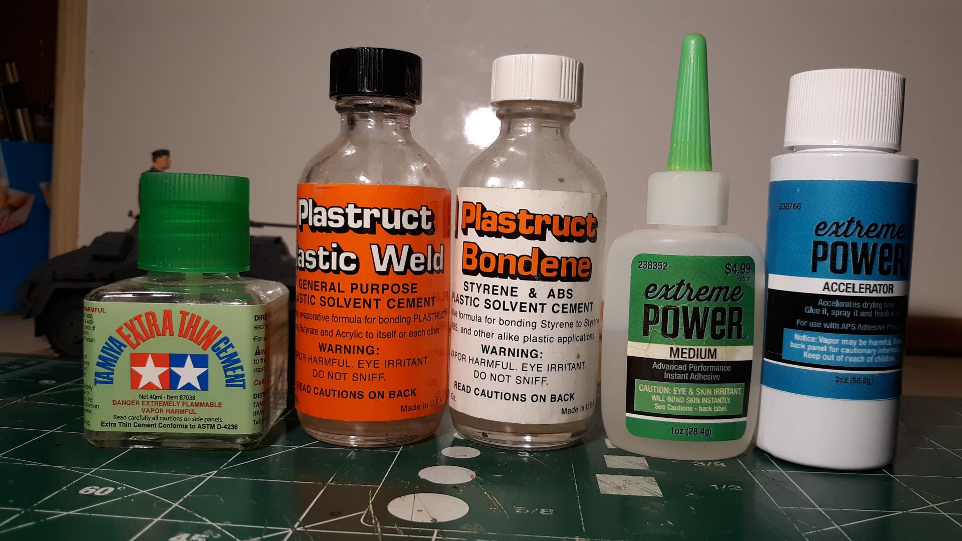

peteski Posted April 29, 2019 Posted April 29, 2019 On 4/25/2019 at 7:28 PM, dshue76 said: My glues of choice. Yes, all those (although I use BSI brand CA and accelerator). I also use 3 different CA viscosities. And of course 5-minute epoxy is also another adhesive indispensable for my modeling tasks.
