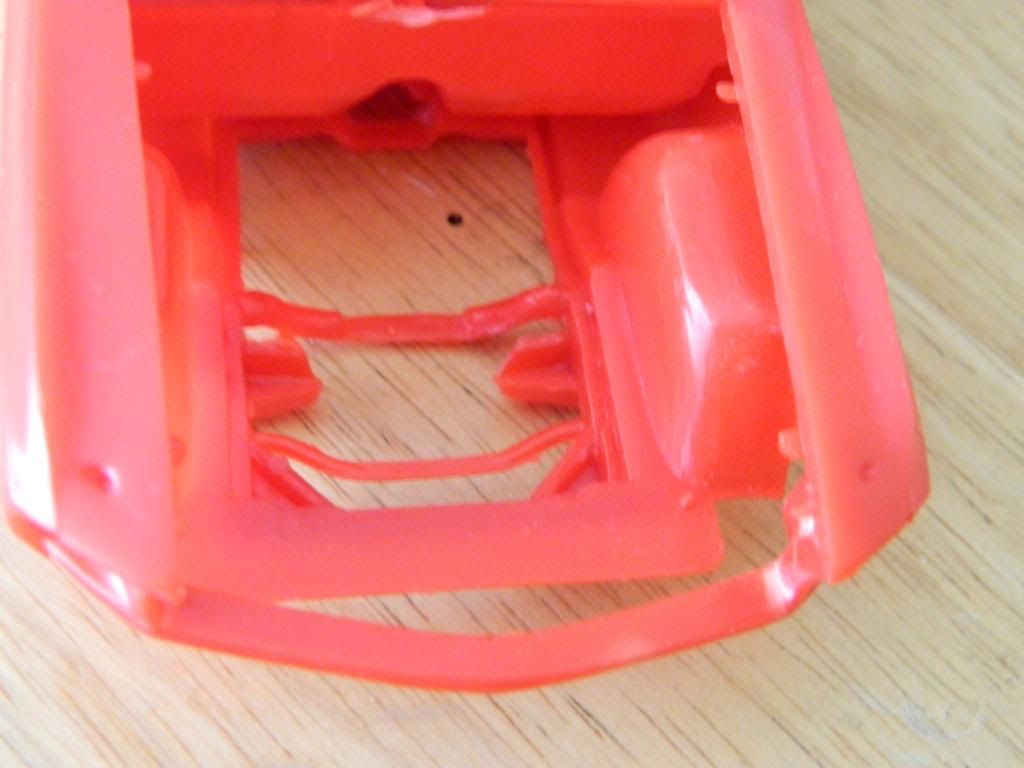

o-man Posted April 29, 2013 Posted April 29, 2013 Got MPC 69 Mustang with rather large sink holes in each front fender. What would you guys recommend to fill?
John Pol Posted April 29, 2013 Posted April 29, 2013 you can always use plastic rod stretched. What mean by that is put a flame to it and stretch it with a lighter. Drill the sink marks out and install the plastic in the hole.Once dry sand it down to the body prime it and see if it needs spot putty. if so put some spot putty on the area and sand and prime again. I hope this helps you out. John Pol

Skip Posted May 1, 2013 Posted May 1, 2013 The sink holes you showed on the Mustang, probably Bondo 801 glaziing putty or CA glue and baking soda and lots of block sanding with what ever fills the holes.
