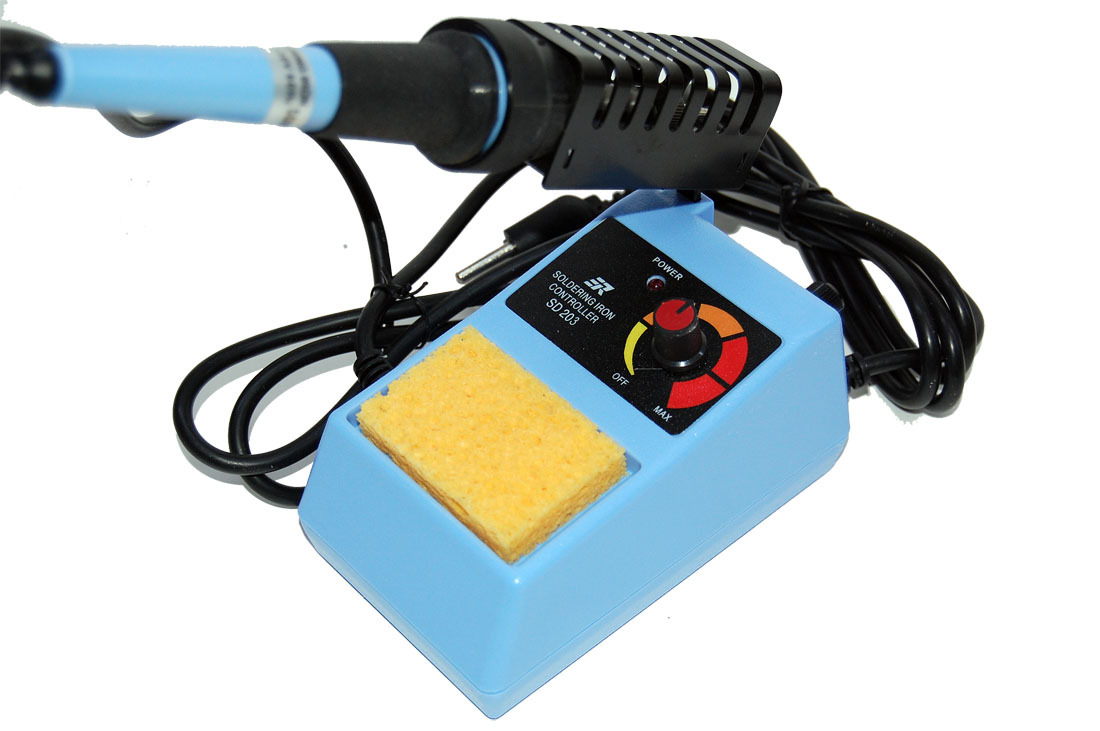

vypurr59 Posted May 11, 2013 Posted May 11, 2013 http://www.microcenter.com/product/391342/Low-Cost_Soldering_Station They sell a Velleman low-cost 50 watt station here. The link takes you directly to the exact tool I purchased.

vypurr59 Posted May 11, 2013 Posted May 11, 2013 (edited) 50 watt would be over kill for what you are looking to solder. I am thinking legs of LED's and small gauge wire. A basic iron should be able to do what you need it to do. You not doing micro/ miniature repair. I have an old Weller, I think it's a 12 watt model and you can replace the tips with pencil tips if need be. Seriously, go look at Radio Shack for one that can use different tips. It's for a some times use, not how you make your bread and butter ($) so it should work out fine for you if you can solder well enough. This is a station, 50 watts is the upper limit. It has a temp control, and goes down to 1 watt. 16 different size tips are available, as well as a tip, that can load a xacto blade into to use as a heat cutter. Also has a heat sink coil to hold the iron, not just a flimsy wire stand, and a sponge to clean tip. I have used this iron to solder FET's into RC Car speed controllers and surface-mount capacitors. Edited May 11, 2013 by vypurr59

vypurr59 Posted May 11, 2013 Posted May 11, 2013 Still overkill. I do Navy 2M repair. And you reinforced what I was saying. You use yours for detail oriented work as well as melting solder to motor cans. If this is a purchase he plans to use more than for soldering every now and then, then I would agree it would be a worth while purchase. An inexpensive iron with proper technique and thin low melting point solder will do what he needs. Wasn't trying to be offensive, just not trying to "up sell" him into something he might not have a need for. Really would not be a up-sale, compare features and cost, radio shack 12 watt iron 1 tip, 1 temp $12. suggested station, variable temp, 2 tips, pencil and chisel, $19.95

vypurr59 Posted May 11, 2013 Posted May 11, 2013 Jeff you put 130. I was like o my cow that's high. So $25 is plausible. Unless yours was $130 That was actually G. Holding in post #5 I replied with post #8, link to the $19.95 priced station. I wasn't trying to make you spend more than needed, just looking out for ya. The stuff I got from radio shack, would never hold up, like mine has for over 20 years, and only had to replace the tips.
Guest G Holding Posted May 11, 2013 Posted May 11, 2013 (edited) That was actually G. Holding in post #5 I replied with post #8, link to the $19.95 priced station. I wasn't trying to make you spend more than needed, just looking out for ya. The stuff I got from radio shack, would never hold up, like mine has for over 20 years, and only had to replace the tips. The post I did showed a station for 23.95...NOT 130.00 and the Iron vypurr59 posted should work quite well. I use a bench quality unit...NOT the 23.95 unit listed. I cannot see spending 15.00 on a fixed wattage unit, give me the heat adjustability and interchangeable tips I can use all solders, tix, silver. and resin core ( i prefer multicore) and get the most out of my money The most important soldering tip I will share is to keep uour tip clean and well tinned. If you turn it off or down between uses, the tips will last longer. DON'T BE CHEAP >>>BUY QUALITY TOOLS ONCE >>> QUALITY LASTS LONGER Edited May 11, 2013 by G Holding

vypurr59 Posted May 11, 2013 Posted May 11, 2013 The post I did showed a station for 23.95...NOT 130.00 and the Iron vypurr59 posted should work quite well. I use a bench quality unit...NOT the 23.95 unit listed. I cannot see spending 15.00 on a fixed wattage unit, give me the heat adjustability and interchangeable tips I can use all solders, tix, silver. and resin core ( i prefer multicore) and get the most out of my money The most important soldering tip I will share is to keep uour tip clean and well tinned. If you turn it off or down between uses, the tips will last longer. DON'T BE CHEAP >>>BUY QUALITY TOOLS ONCE >>> QUALITY LASTS LONGER That is also the best advice, cleaning tip, tinning tip, and turning down the power in inactive periods. With a set watt iron, the cord is your on/off switch. Also I read your post wrong, and saw that you spent $130. on yours, and pictured a similar one to the one I mentioned. I do also have a Weller station that ran about $250.00, but has 2 irons and a solder removing station. Used this for benchwork at Fluke, when working there through college. Would have never recommended this for what little need you may have for an iron.
