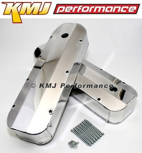

Ace-Garageguy Posted May 20, 2013 Posted May 20, 2013 (edited) Another point...just like you can put aftermarket or fabricated valve covers on any engine, not ALL 572 Chevys will have the valve covers that come with the complete crate engines. It's common to see fabricated covers similar to these on hot street rides and competition cars. Edited May 20, 2013 by Ace-Garageguy
