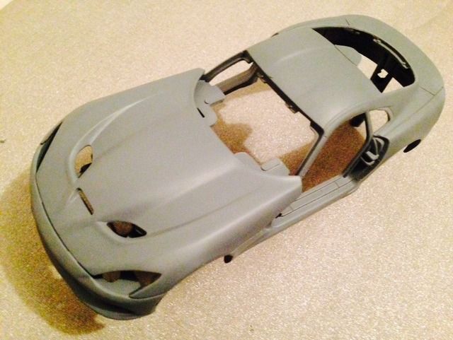

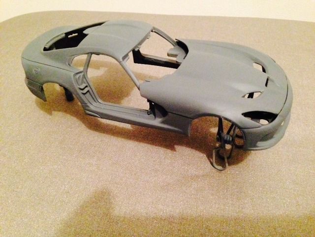

Hemified71 Posted June 30, 2015 Posted June 30, 2015 GTP... I'm actually in the process of stripping/re-painting a 1:24 2013 Viper. I've done this kinda stuff before & it's pretty easy. I used ordinary paint stripper to strip off the baked on paint... Cleaned up the body/parts... Sanded back with 600-1000 (wet ) then used some etch-primer to seal it up... Because I have it in my paint stash, I'll be using 2Pk Urethane Clear coat... IMO the best clear-coating for any model... Metal or plastic. Try your local auto paint shop or maybe you have a mate that has some? Cheers
Pete J. Posted June 30, 2015 Posted June 30, 2015 (edited) I will expand a little on my prior post. The paint on most die cast is what it is to hide the defects in the finishing. The inexpensive die casts are created as fast as possible and thus finish work is kept to a minimum. Clean up is not difficult but the smoother the base the better the finish. Clear coat is a good choice but be sure you use the same brand of clear that you did the base coat to assure that you don't have compatibility issues. Keep the coats as thin as possible. Priming is critical to getting paint that will stay down. A good metal etching primer is the only way to go. Painting with out stripping and repriming is a roll of the dice. You don't know what type of paint is on there and since most are made in China, it could be anything. Also, the extra layer of paint may cause fit problems with opening doors and other parts. Once the body is cleaned, prepped and primed you are down to the same thing you would do on a plastic model. Good painting technique from there on is all you need. Here are three shots of a die cast I did a few years ago to give you an idea of what you may face and how it will look when done. Original finish cleaned up and reprimed Finished with a very thin clear coat. Edited June 30, 2015 by Pete J.
