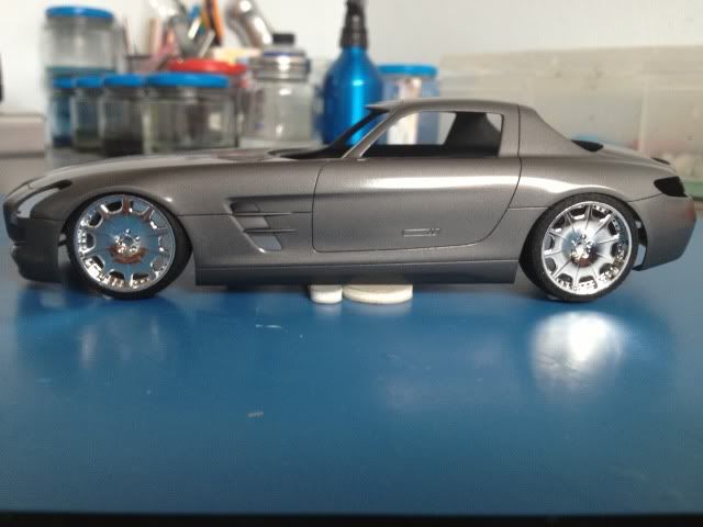

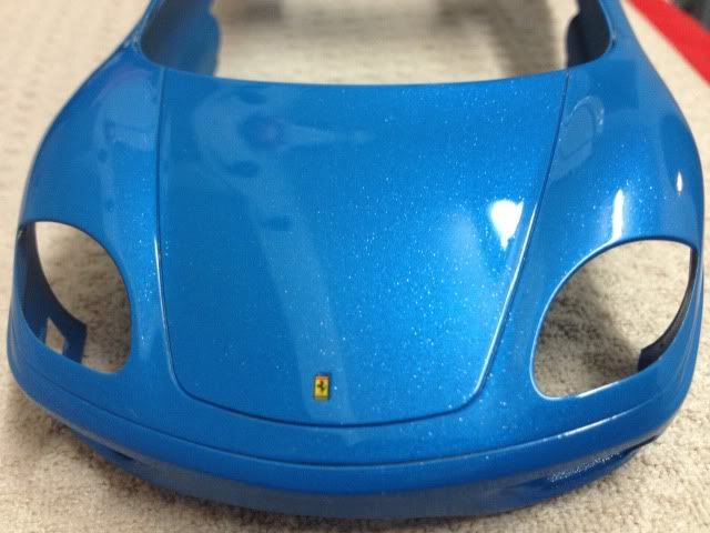

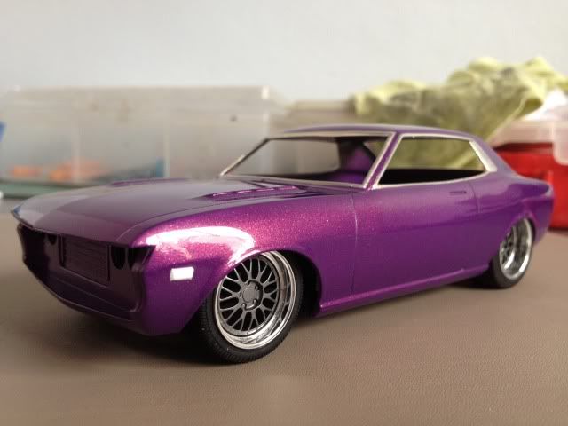

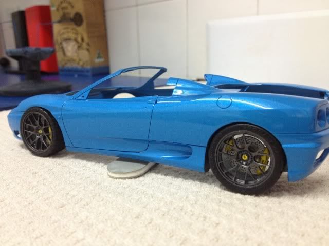

CJ1971 Posted July 14, 2013 Posted July 14, 2013 I have tried all matter of clears in my time modelling, enamels/acrylics/lacquers & 2pk automotive, be it from a can or through my A/B. It may not be as long a time as others here or across the globe but by far & away 2PK automotive clear is the best, in terms of results & durability. Over the last few years I've used ONLY 2pk clear exclusively. It's not a question of $ for me personally but it is when it comes to quantity Vs $. Over this side of the pond Tamiya Lacquer rattle cans vary between $12-15au per can & Duplicolour cans pretty much the same. Tamiya cans have approx' 100ml & Duplicolour 150ml. 100ml x 10 = 1 litre. Recently I purchased 1 litre of BASF Glasurit clear ( 1 litre ) along with its specific hardner ( 500ml ) & reducer ( 500ml ), totaling 2 litres. Total cost =$120au. On average I will use 6-8ml of clear & 3-4ml of the hardner/reducer for each mix, per 1:24/25 scale build. So comparing prices Vs Quantity I would need 10 cans of Tamiya Clear @ $14 = $140au. Duplicolour 7-8 cans @ $14 = $98-$112au. I always decant rattle-can paints & spray through my A/B, when I do use rattle can colours. Duplicolour cannot hold a candle to BASF Glasurit, nor can Tamiya's clear. Another really good quality with auto 2pk clears, as stated previously, is their durability & strength. They hold up to sanding/wet sanding & auto polish polishes, which I polish my builds with. Enamels/Acrylics cannot & although lacquers are more durable, can't either. Here are some builds that have been cleared with HOK 2pk clear & some current builds with BASF Glasurit.... Funnily enough I don't see any syrup? (HOK) (Glasurit) As has also been said earlier... Each to his own. Cheers

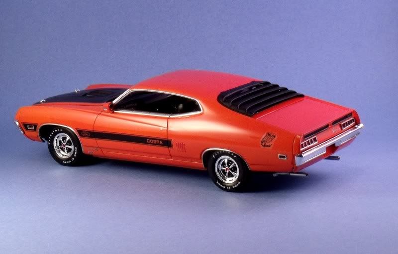

sjordan2 Posted July 14, 2013 Posted July 14, 2013 Here's a new post showing a model finished in polyurethane clear. You be the judge. http://www.modelcarsmag.com/forums/index.php?showtopic=77059
