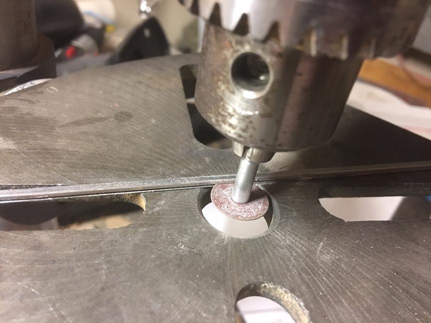

gasser59 Posted August 31, 2019 Author Posted August 31, 2019 A bit of progress and a few photos to share. For the longest time, I couldn't figure out a way to do the aluminum window frames that would look convincing and would satisfy me. Here's what I finally came up with. I put my Dremel cut-off wheel in my bench drill press and set it almost to the bed so I could cut a slot in the aluminum square tubing for the acetate window. Once a whole strip of that was done, I would cut out 45 degree notches in the frame without cutting all the way through for the corners. There are six of these windows so this will take some time. I'll post more progress pictures as I go.

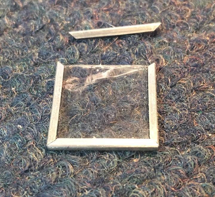

gasser59 Posted September 2, 2019 Author Posted September 2, 2019 Well that didn't go as planned. The window frames are way to wide. I went ahead and used the same set up on the drill press by cutting the other side of the aluminum square tubing to make a small aluminum angle. Worked and looks so much better. Pics tomorrow.
gasser59 Posted September 3, 2019 Author Posted September 3, 2019 That didn't quite go as planned either. I was putting the last aluminum side on the clear piece of acetate and ended up getting glue all over the glass. I was so frustrated, I had to walk away. This method is still the way to do the windows just need a different glue from my arsenal, one that's not so runny.
misterNNL Posted September 3, 2019 Posted September 3, 2019 On 8/31/2019 at 10:15 AM, gasser59 said: A bit of progress and a few photos to share. For the longest time, I couldn't figure out a way to do the aluminum window frames that would look convincing and would satisfy me. Here's what I finally came up with. I put my Dremel cut-off wheel in my bench drill press and set it almost to the bed so I could cut a slot in the aluminum square tubing for the acetate window. Once a whole strip of that was done, I would cut out 45 degree notches in the frame without cutting all the way through for the corners. There are six of these windows so this will take some time. I'll post more progress pictures as I go. Most impressive and unique method of solving a unique problem. I would waste a hundred feet of aluminum trying to get enough matching Windows to do w whole trailer.
gasser59 Posted September 4, 2019 Author Posted September 4, 2019 (edited) Here's the pic of the second method with the glue on the glass. For the next go around, I will use an adhesive product I got from Art Laski called Liquid Glass. I'm hoping to reuse the aluminum strips from this window if I can get the Zap-A-Gap off. Edited September 4, 2019 by gasser59
