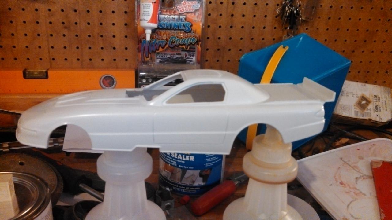

Riley Customs Posted August 15, 2013 Posted August 15, 2013 Well I am starting my own racing group this week. Zombie Motorsports is getting involved in all fields of racing...... Ok not really but I am starting a new project with left over parts from many model kits I have. Right now I am starting with the body. I sanded down any unnecessary body and mold lines, primed the body and put a couple coats of white on it.

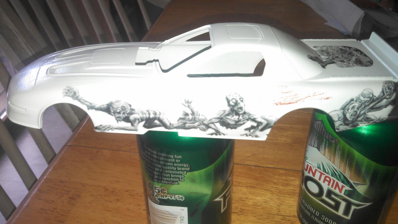

Riley Customs Posted August 15, 2013 Author Posted August 15, 2013 Instead of sitting there watching the paint dry ( which really is a talent you know ) I went in and started working on the decals for the car. I first printed them out on paper so I could make sure I had the sizes right. Then I laid them out a couple of time to make sure they were what I wanted. I taped them on another body which was the same to see how they would look. Once I got them just the way I wanted I grabbed a sheet of clear waterslide paper and printed them off. They came out great, just a little darker than I wanted them but the blood splatter ones came out just like on the computer. I used GIMP brushes to make the blood splatter look as real as I could. Trial and error is how I learn most things much like the rest of us. Once I was sure the ink had dried I coated the paper with a Matte clear coat. I found that if I do it with a Matte clear they don't come out as shinny as if I would have used the Crystal clear once I clear coat the car at finish.

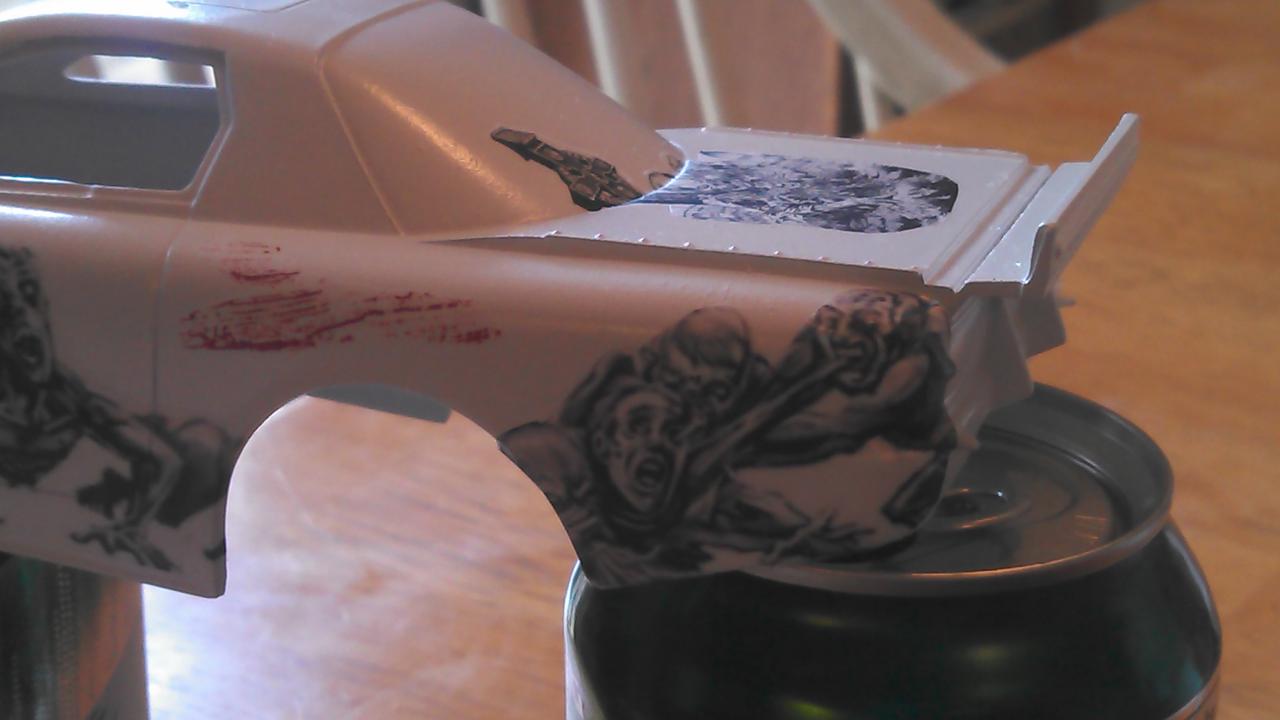

Riley Customs Posted August 15, 2013 Author Posted August 15, 2013 well everything seems to be dried so here I go with the decals. Once I have sprayed the decals I usually wait an hour or so to make sure they are really sealed but this build is really calling me so I started early. 30 mins after spraying I started cutting them exactly as my paper ones are that I used for the mock up. I only did one side for now. Don't want to put to many on at once risking the possibility or messing them up before they are dried.

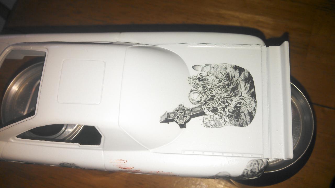

Riley Customs Posted August 16, 2013 Author Posted August 16, 2013 well finished up with the decals. Not sure if I like the hood ones. Don't know if I am gonna stick with these or make maybe one huge blood splatter going up the hood. Make it look as if I hit one and it was thrown over the top of the car. Can't move on with the clear coat until I decide which way I am gonna go. So I will start working on the frame. I have two resin molds made of slicks and smaller front wheels so I guess I will get them poured and ready to paint.
brett Posted August 17, 2013 Posted August 17, 2013 I'm sure it will look great either way but I like the sound of the blood splatter maybe with a couple of errant ( loose) arms or legs?
