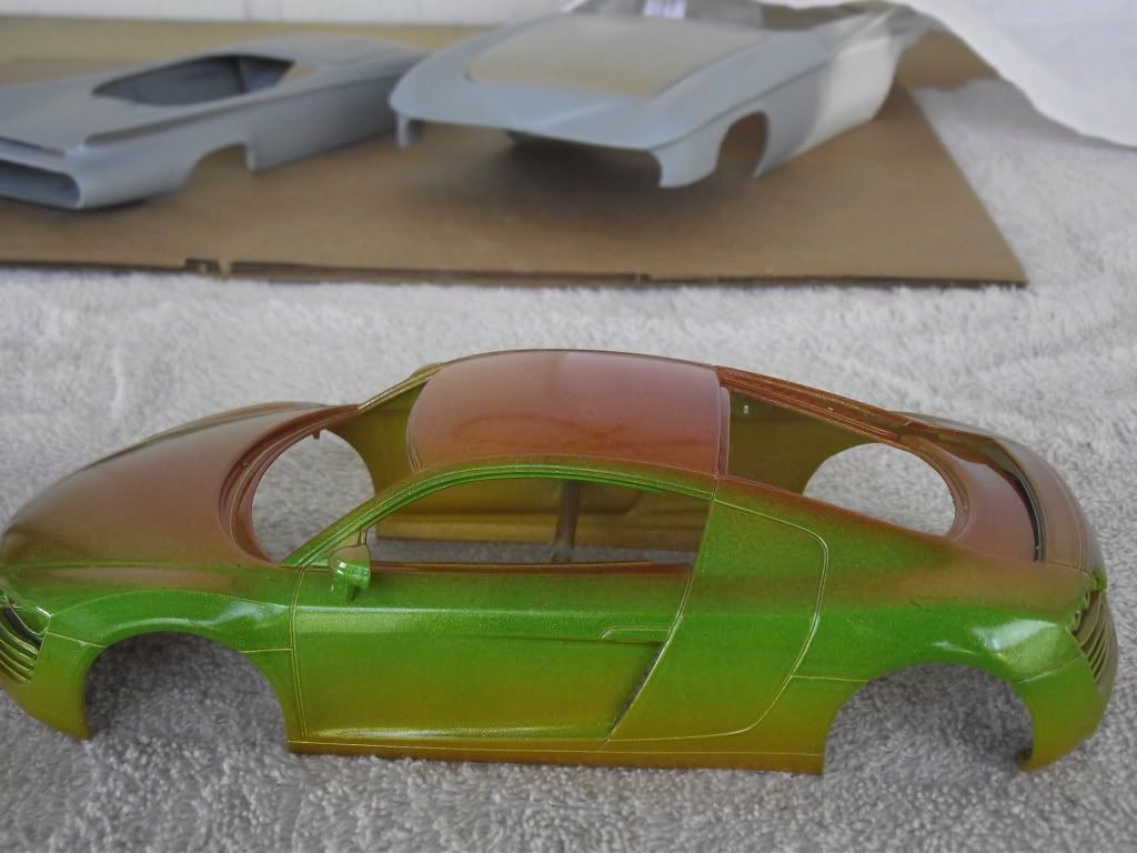

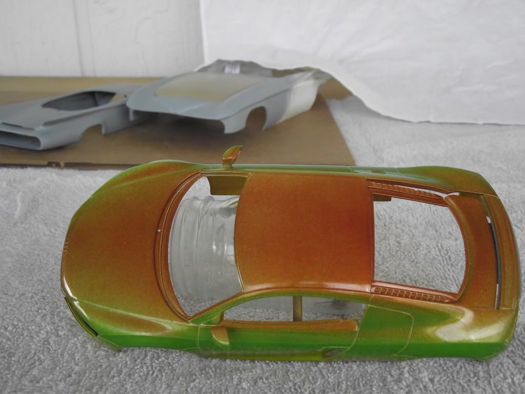

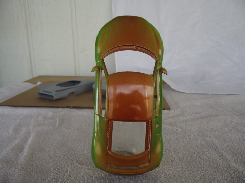

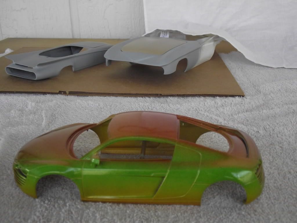

Mike Kucaba Posted August 26, 2013 Posted August 26, 2013 I did one on a AUDI a year or so ago. I posted pics on here, but can't find the thread? Anyone know how to do this? I checked my content at my profile, but only went back so far.

Mike Kucaba Posted August 26, 2013 Posted August 26, 2013 http://i1189.photobucket.com/albums/z421/mkucaba/AUDI%20R8/DSCF0574.jpg
Mike Kucaba Posted August 26, 2013 Posted August 26, 2013 This was done with spray cans. Inca gold Lime something or other and revving red Testor's.

Mike Kucaba Posted August 26, 2013 Posted August 26, 2013 All free hand, Had the body on a coat hanger, all three cans warmed, shaken and ready to go started at the bottom with the Inca gold, then the Lime Ice, then the Fiery Orange. One right after the other, no drying time between colors.
