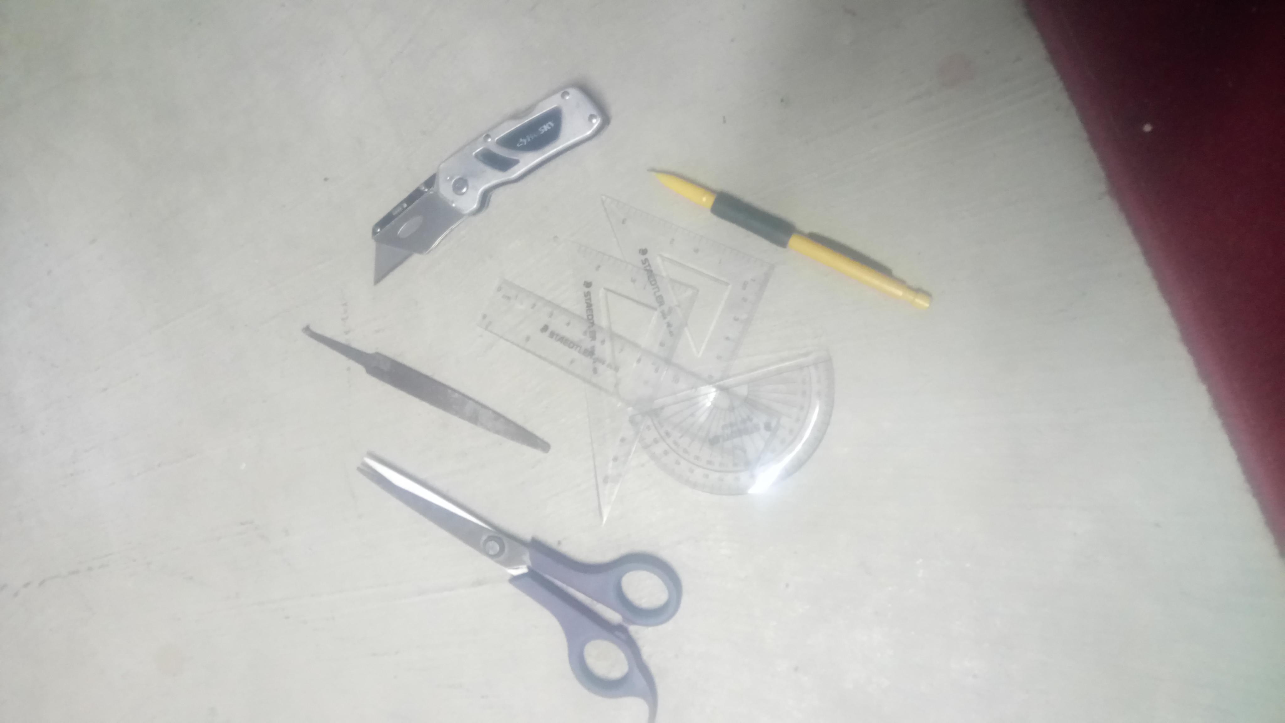

Gumball Posted June 23, 2020 Posted June 23, 2020 These are my tools, although I wouldn't advise using any of these for accuracy.
