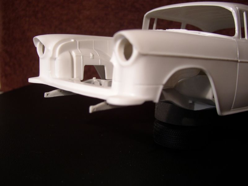

Fortheloveofgassers Posted October 3, 2013 Posted October 3, 2013 I want to replicate the Blair's speed shop 1955 2-door sedan gasser and I have 2 challenges I would like to get advice on. I want to leave off the front bumper. The nose and splash apron on the 1955 AMT sedan kit aren't even close to looking right. It looks like a block of plastic. On the other hand the nose on the Monogram kit looks fabulous. Has anyone grafted the nose from the Monogram kit to the Amt kit. The scales of are different. Amt at 1/25 Monogram at 1/24. I would love any input on how to correct this issue. Second challenge I would like to radius the rear wheel well as they did in the 60's which is not a problem but how can I get the rolled edge back? Evergreen strip and putty? Would love your input. Thanks in advance. Ed

jeffs396 Posted October 3, 2013 Posted October 3, 2013 The '55 also looks good without the splash apron Ed:

ToyLvr Posted October 5, 2013 Posted October 5, 2013 Ed: FWIW, I have also been working on a '55 gasser project based off of the venerable AMT '55 "shoebox" kit. Another problem to watch out for, if you haven't already noticed, is that the chassis of the AMT has the exhaust system already molded in place - quite a bummer to fix. After making some test fits, I found that the nice plain chassis from either Monogram '55 convertible or '55 hardtop (both 1/25 scale) will fit the AMT with minor adjustments...
Fortheloveofgassers Posted October 7, 2013 Author Posted October 7, 2013 name="ToyLvr" post="1022789" timestamp="1380941420"]Ed: FWIW, I have also been working on a '55 gasser project based off of the venerable AMT '55 "shoebox" kit. Another problem to watch out for, if you haven't already noticed, is that the chassis of the AMT has the exhaust system already molded in place - quite a bummer to fix. After making some test fits, I found that the nice plain chassis from either Monogram '55 convertible or '55 hardtop (both 1/25 scale) will fit the AMT with minor adjustments...
