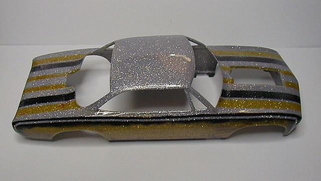

Ace-Garageguy Posted October 17, 2013 Posted October 17, 2013 (edited) This is how big the Testors One Coat flake appears in 1/25. Definitely "bass boat" or kustom kar. Edited October 17, 2013 by Ace-Garageguy
wisdonm Posted October 17, 2013 Posted October 17, 2013 (edited) For bass boat big try nail polish. Krylon Blast. Edited October 17, 2013 by wisdonm
Austin T Posted October 17, 2013 Author Posted October 17, 2013 For bass boat big try nail polish. 20130725_162201 x 6.jpg Krylon Blast. P1011881 x.jpg Just out of pure curiosity how many coats of clear are on "Unsafe at any speed"?And what brand clear?
