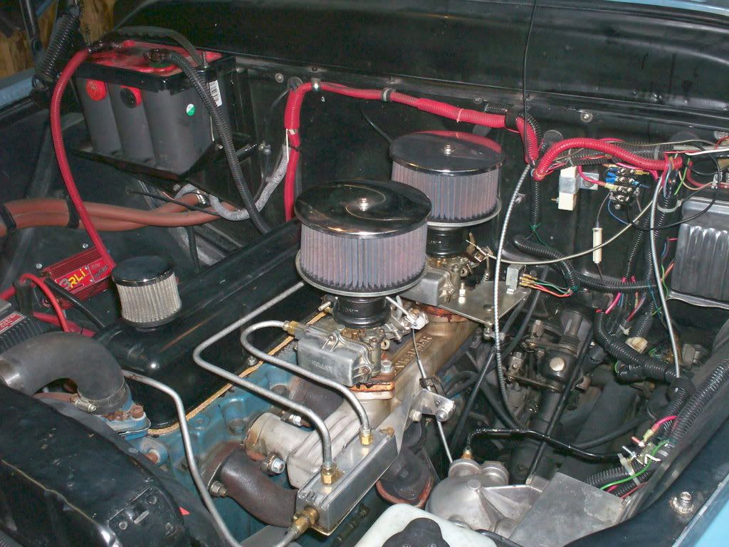

Longbox55 Posted October 25, 2013 Posted October 25, 2013 Hopped up Chevy 6 you say? This is more or less what you would typically find under the hood of a late '50s/early '60s Stovebolt powered street/drag car. There was also a 3 carb versions of most of the manifolds, but using 3 was not very common in full body cars/trucks due to firewall clearance issues. Fenton cast iron headers were the common exhaust found, and have been replicated in scale in the AMT '51 Fleetline, which also has a very nice dual carb intake, I believe it's either a Nicson or Edmunds with water heat. For the engine block, I would suggest swapping the kit engine for the one from the AMT 60 Chevy pickup, which replicates the full pressure 235/261 block, instead of the 216 "Babbit Pounder" low pressure block that the kit has. The 216 isn't much of a performance engine, and even the low pressure 235 wouldn't be best for drag racing, though many were raced. The engine pictured is in my own '55 Chevy truck, I have an uncle that had a virtually identical setup (his was a '57 block) in a '49 Chevy Business Coupe that saw lots of 1/4 mile action in the late '50s.

bismarck Posted October 25, 2013 Author Posted October 25, 2013 Hopped up Chevy 6 you say? This is more or less what you would typically find under the hood of a late '50s/early '60s Stovebolt powered street/drag car. There was also a 3 carb versions of most of the manifolds, but using 3 was not very common in full body cars/trucks due to firewall clearance issues. Fenton cast iron headers were the common exhaust found, and have been replicated in scale in the AMT '51 Fleetline, which also has a very nice dual carb intake, I believe it's either a Nicson or Edmunds with water heat. For the engine block, I would suggest swapping the kit engine for the one from the AMT 60 Chevy pickup, which replicates the full pressure 235/261 block, instead of the 216 "Babbit Pounder" low pressure block that the kit has. The 216 isn't much of a performance engine, and even the low pressure 235 wouldn't be best for drag racing, though many were raced. The engine pictured is in my own '55 Chevy truck, I have an uncle that had a virtually identical setup (his was a '57 block) in a '49 Chevy Business Coupe that saw lots of 1/4 mile action in the late '50s. Are those HOLLEY two barrels on that intake?!!

Longbox55 Posted October 25, 2013 Posted October 25, 2013 Are those HOLLEY two barrels on that intake?!! They're actually single barrels, Model 1904. They originally came from a pair of International engines.
