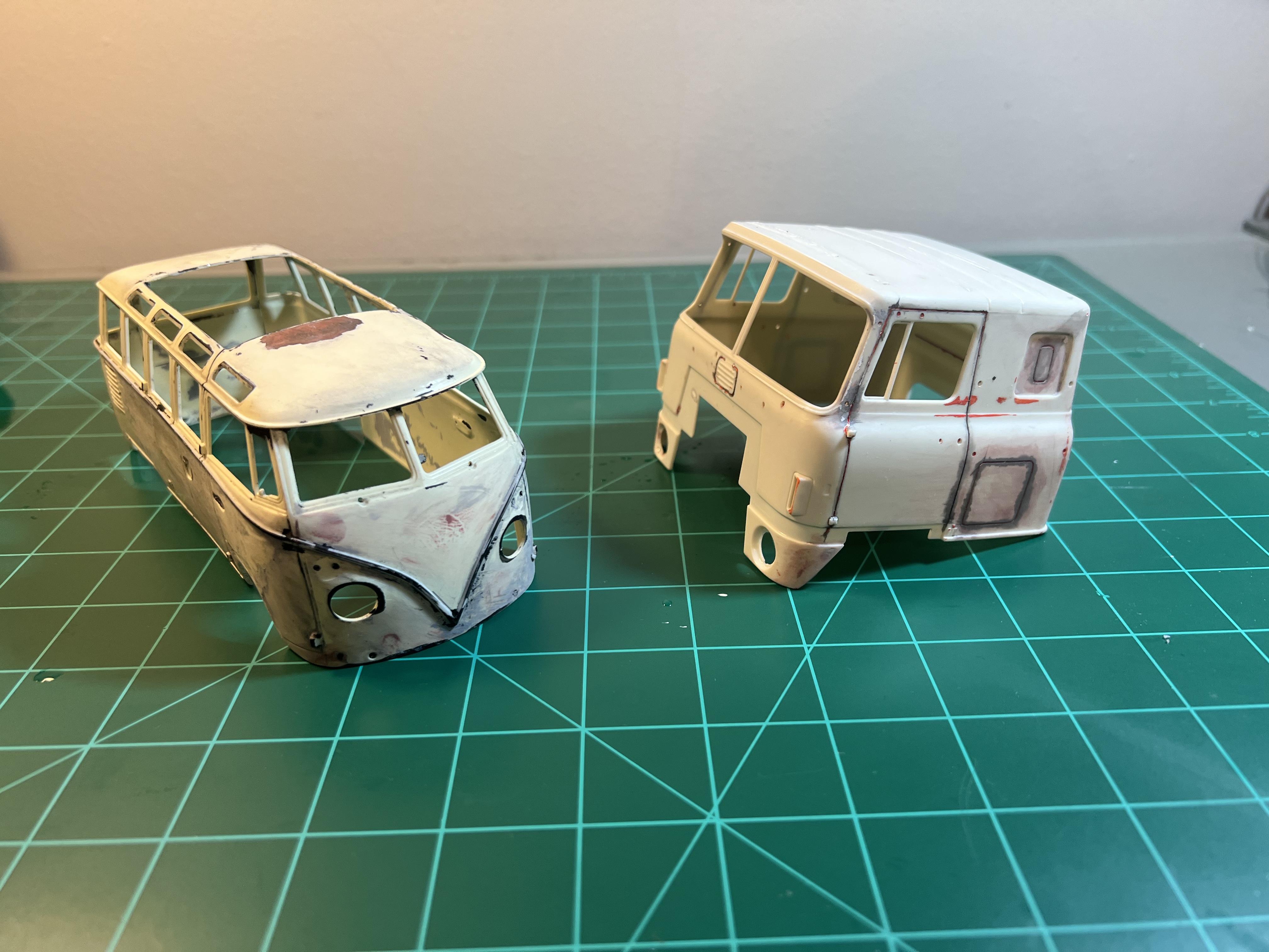

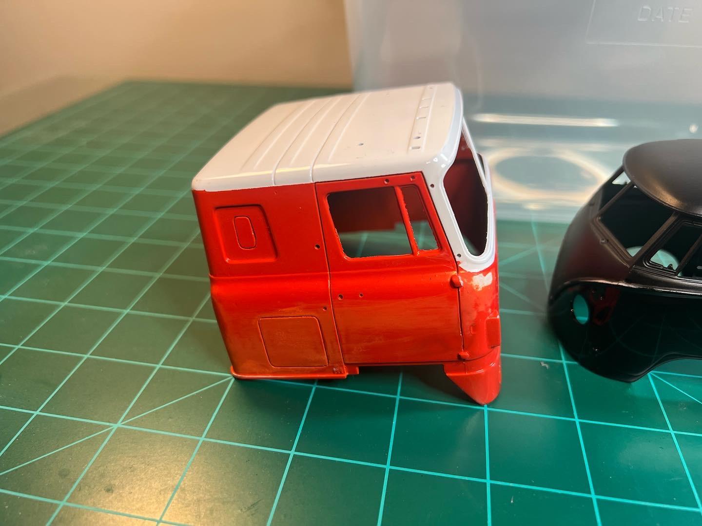

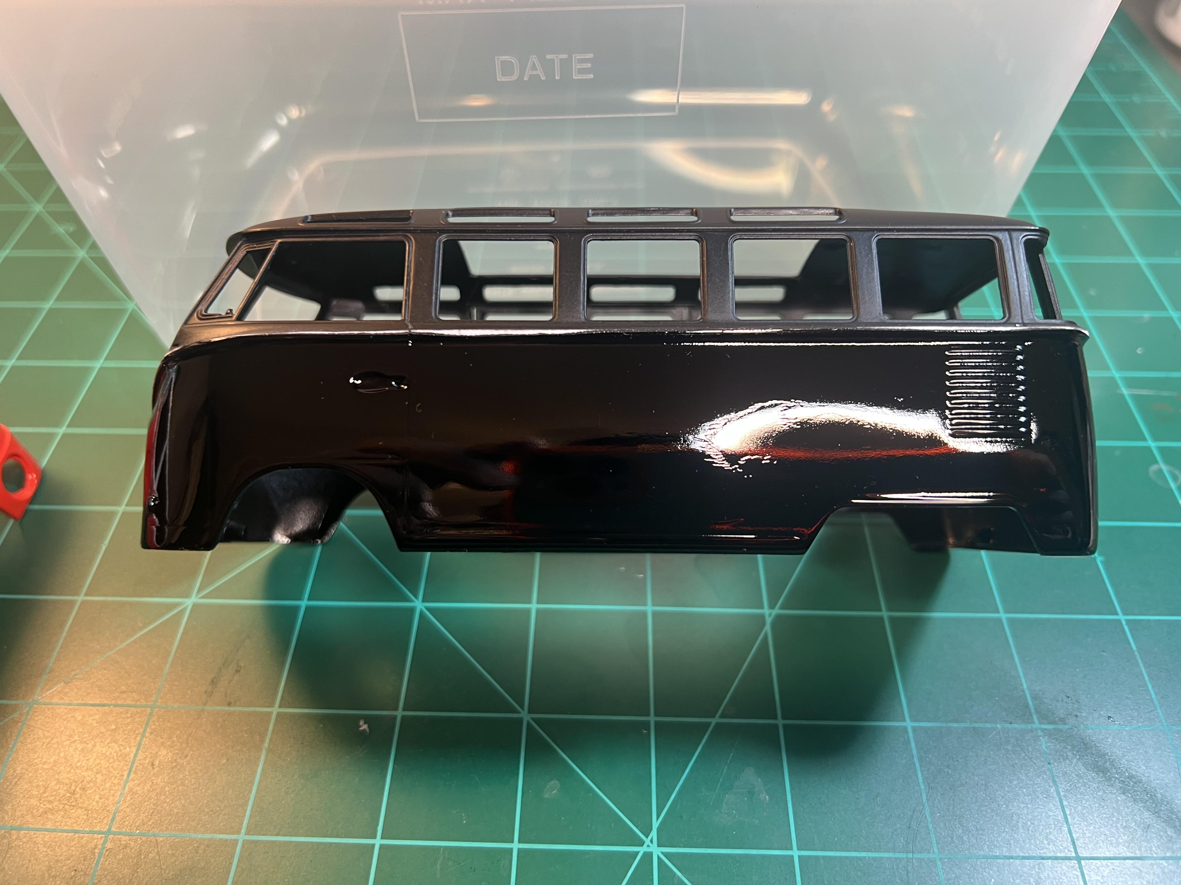

catpack68 Posted December 16, 2022 Share Posted December 16, 2022 (edited) I used 91% Isopropyl Alcohol to strip these two.The AMT IH cab was supposed to be my 2022 BRBO project and the Hasagawa VW Bus was also supposed to be finished this year too.Both were shelved due to paint issues.Both were painted with Tamiya Spray paint.I tried to strip both with Super Clean and DOT 3 brake fluid and neither one worked.I also decided to strip a Revell 83 Hurst Olds body I picked a few years ago really cheap I was having trouble stripping and a surfboard for another project.Here are the results after stripping both with 91% Isopropyl Alcohol.I was impressed👍 Edited December 16, 2022 by catpack68 Quote Link to comment Share on other sites More sharing options...

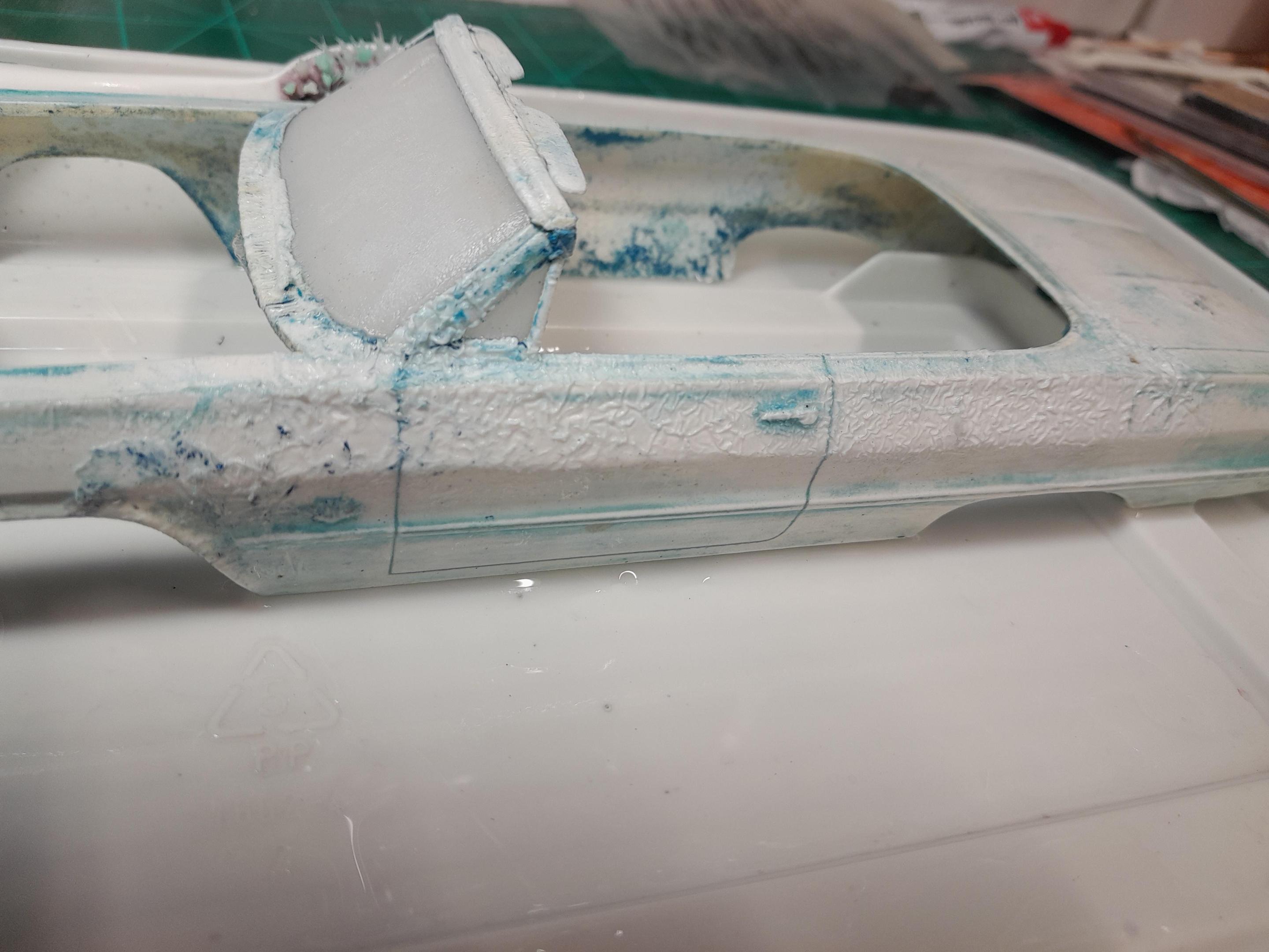

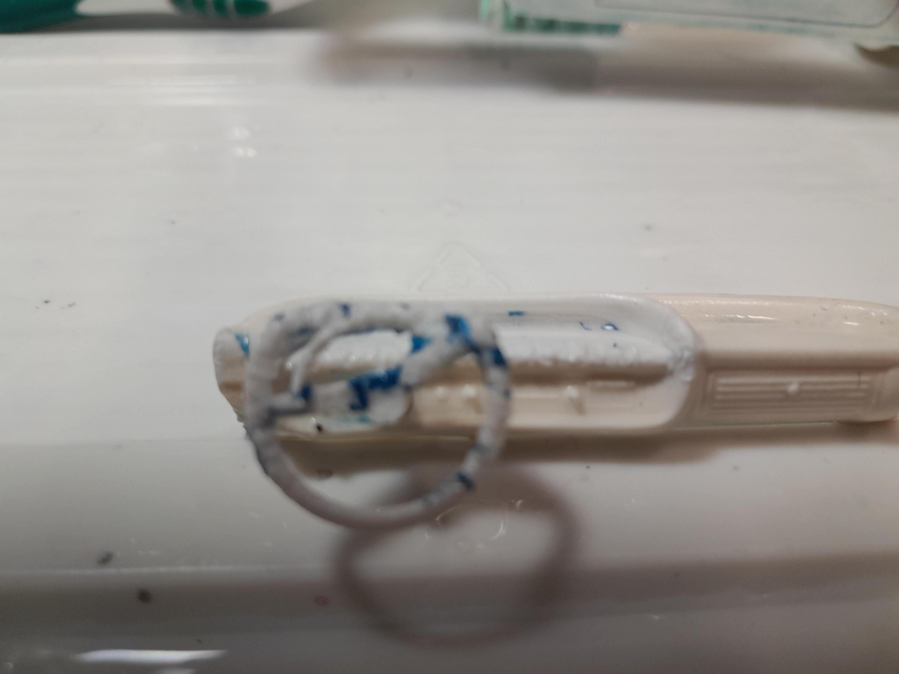

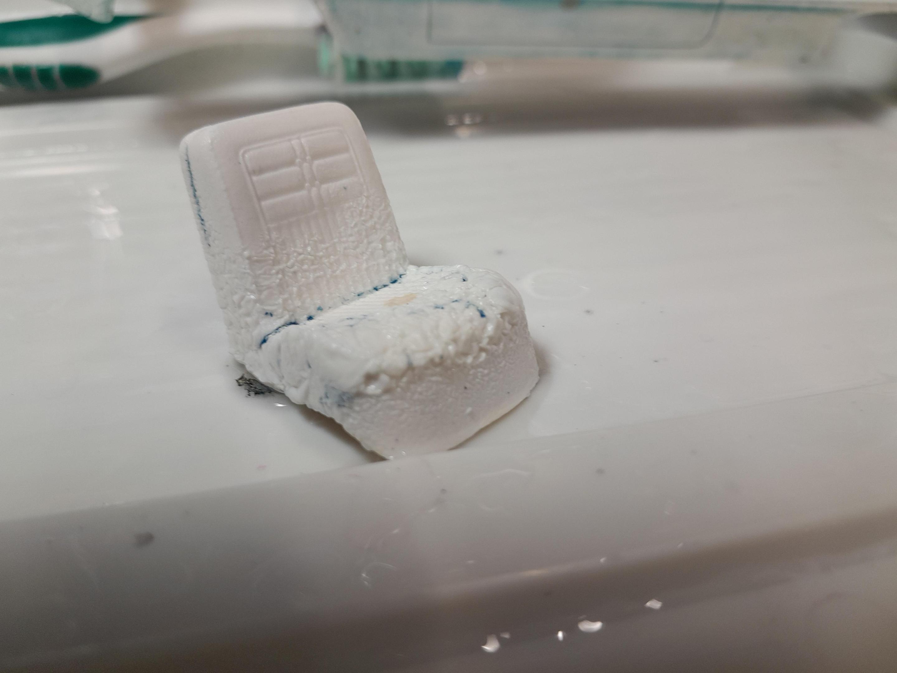

TarheelRick Posted March 21, 2023 Share Posted March 21, 2023 Anybody interested in a slightly used bottle of QSC stripper. Works really well on removing old paint. This original '63 Chevy was painted with what I presume to have been some type of paint available in the 60's. The QSC rolled it off with very little problems and only a few side-effects. Quote Link to comment Share on other sites More sharing options...

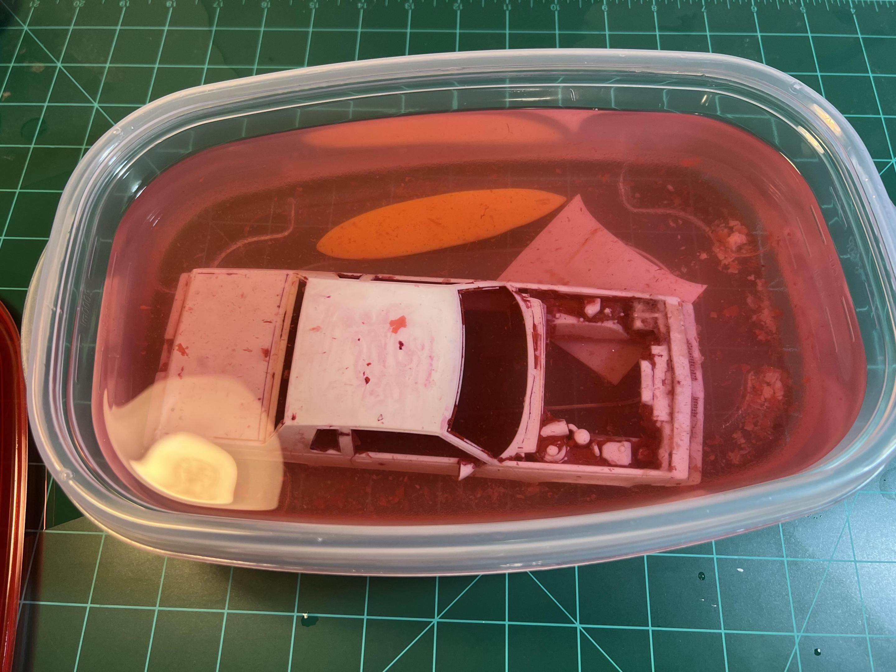

ToyTund2009 Posted March 18 Share Posted March 18 I've had good results using a product called Shock It. It takes a bit longer than brake clean or oven cleaner but is much less harsh, doesn't have a bad smell and isn't corrosive. My wife initially bought it on HSC or one of those home shopping clubs, I had an old Tamiya kit I painted about 20 years ago and figured I'd give it a try and was happily surprised by how well it worked. I've since been able to find it on Amazon Quote Link to comment Share on other sites More sharing options...
peteski Posted April 19 Share Posted April 19 On 3/18/2024 at 2:23 PM, ToyTund2009 said: I've had good results using a product called Shock It. It takes a bit longer than brake clean or oven cleaner but is much less harsh, doesn't have a bad smell and isn't corrosive. I sure hope you meant DOT3 brake fluid, not brake clean!! Brake clean will instantly attack and ruin polystyrene. Quote Link to comment Share on other sites More sharing options...
