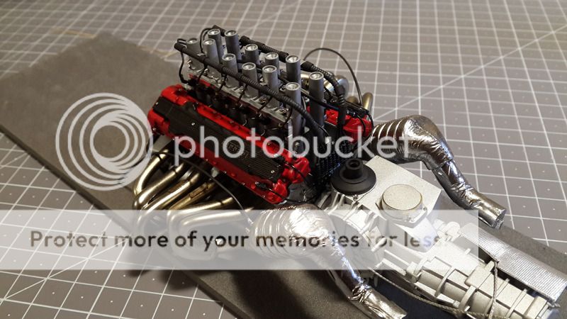

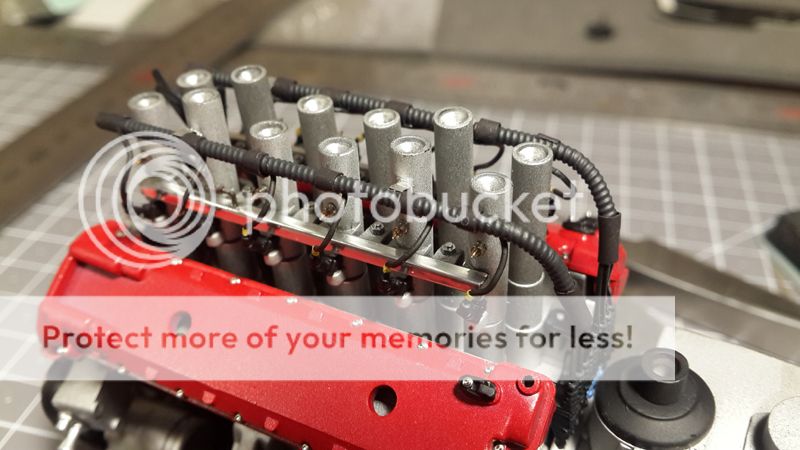

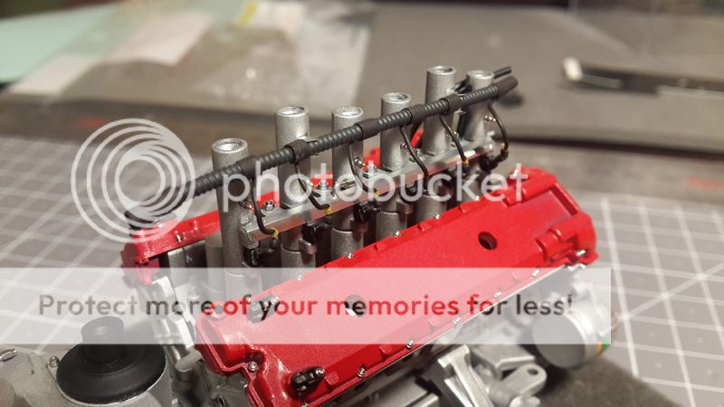

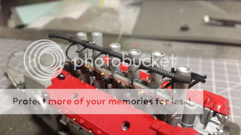

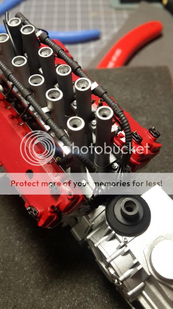

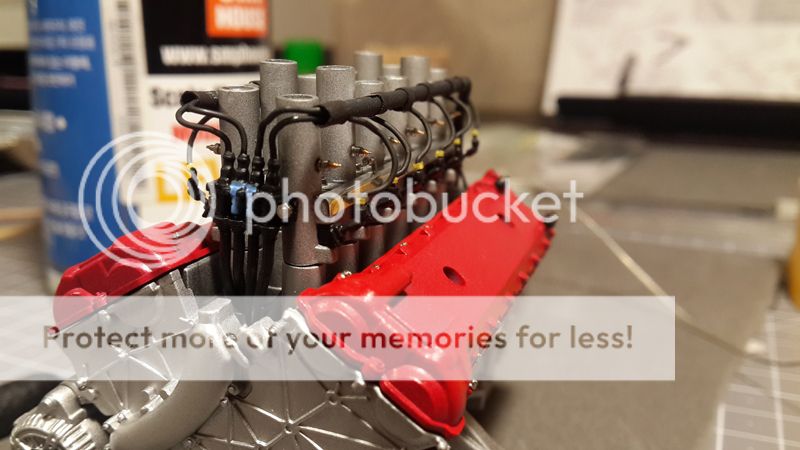

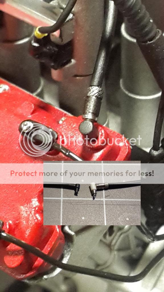

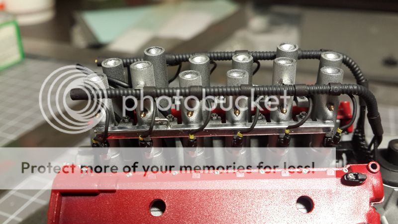

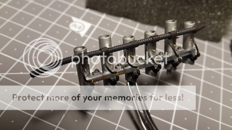

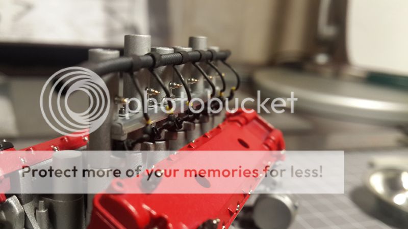

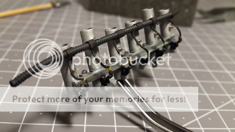

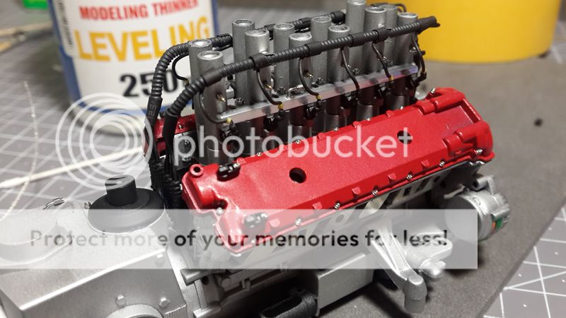

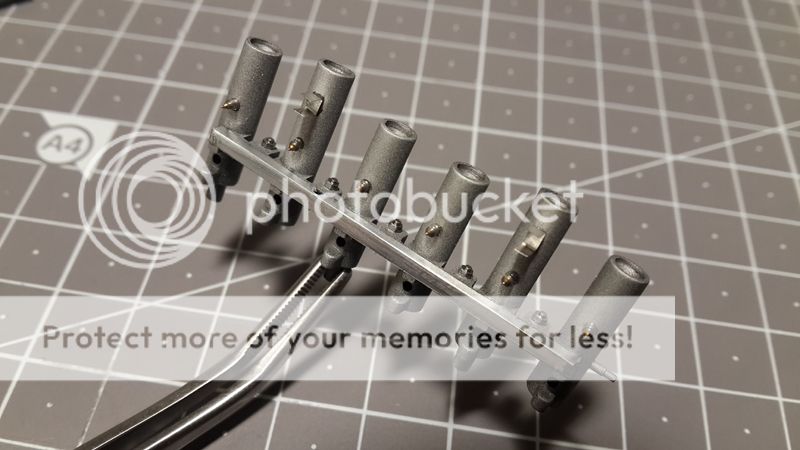

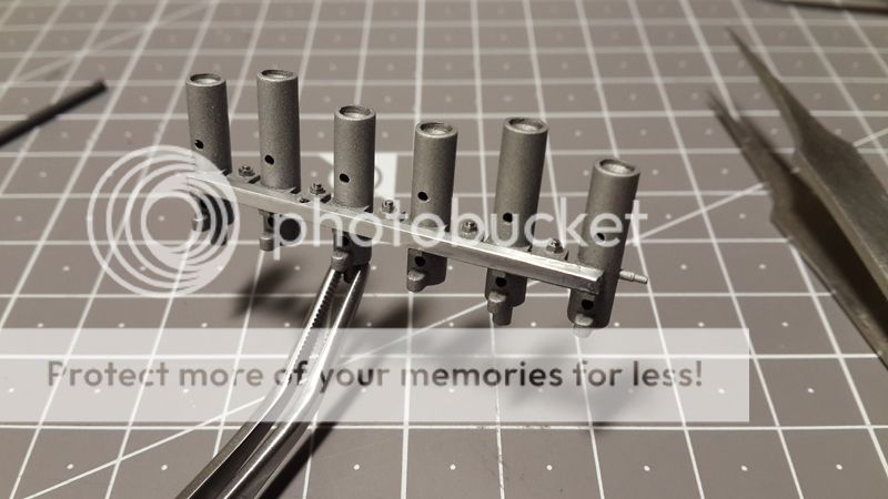

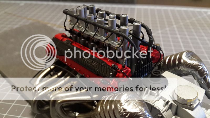

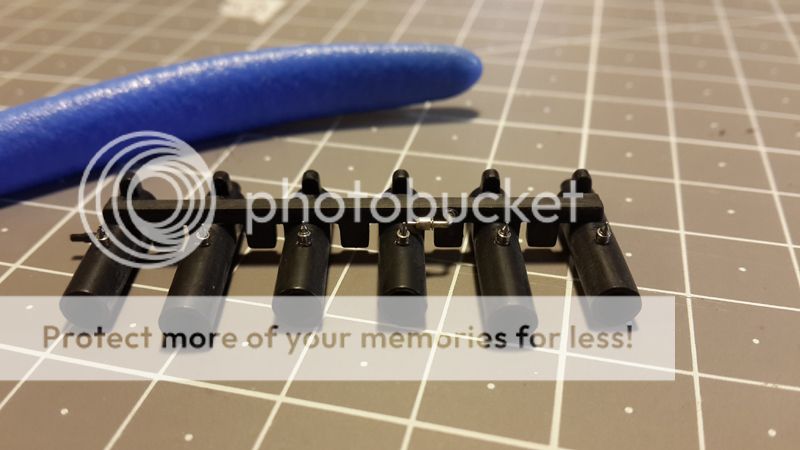

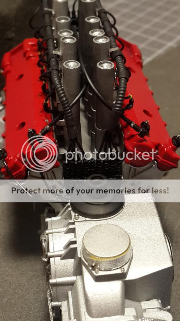

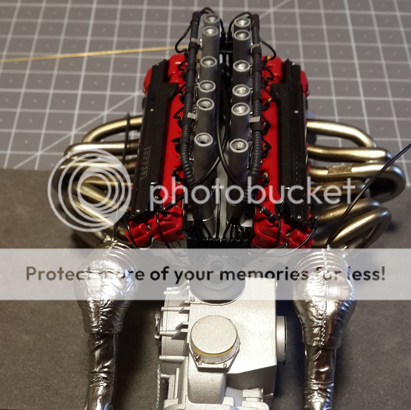

tetra M Posted February 26, 2014 Posted February 26, 2014 i've recently started building enzo with hobbydesign's brake disk and photo etched set i'd like share my build with you guys and get some advice *since this is my first time starting a thread in english, i hope you dont mind my awkward sentences here's my progress 14 1mm rivets on each cover detail up started with air intake manifold. i made holes on top i put some metal electric plugs instead after painted with engine color, i attached small hex nuts btw manifolds and applied chrome tape-> sand it lightly with fine sandpaper to make it look like stainless steel fuel rail i made electro-injectors with duct spring and insulated wires with the engine part . bending thin wires in similar shape was not easy at all (it took almost 2 hours)

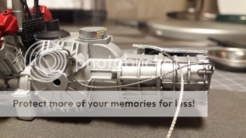

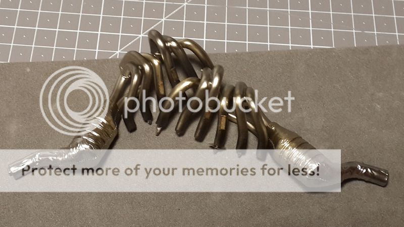

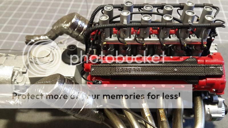

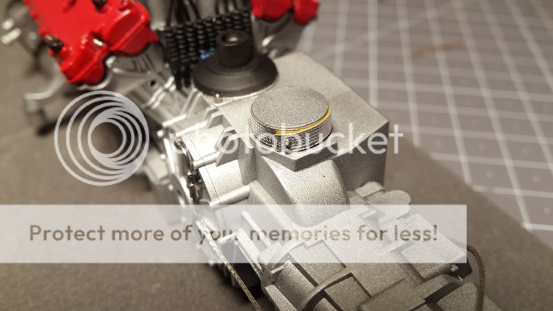

tetra M Posted February 26, 2014 Author Posted February 26, 2014 made another one... i think this one is better in quality... even though it will not be seen after covered with air box, looks much better than original part to me heat shield... fix it with metal rivet another heat shield by the transmission and i replaced hose joint with t2m metal joint since the rear part can be seen through rear bumper, i put gold metal pipe another metal hose joint...

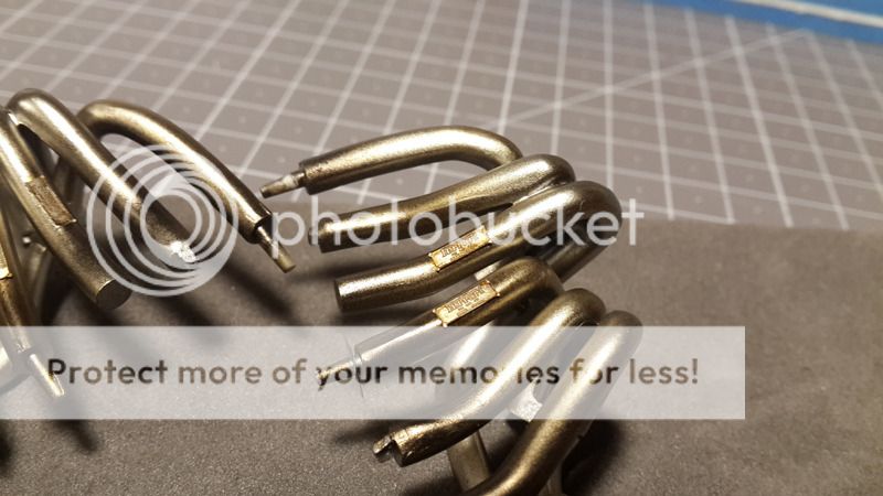

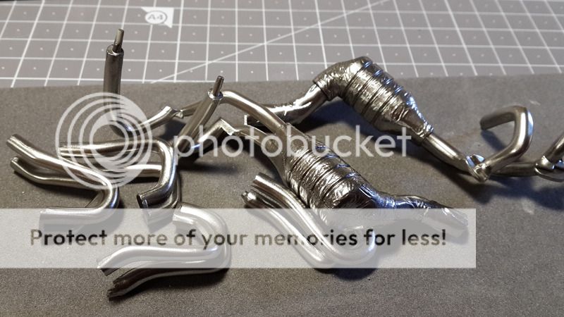

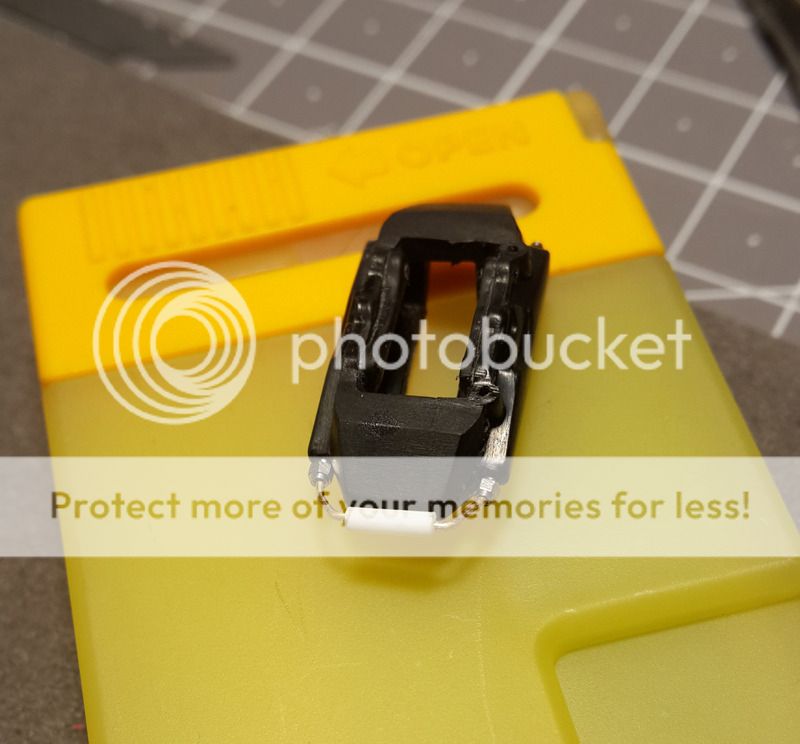

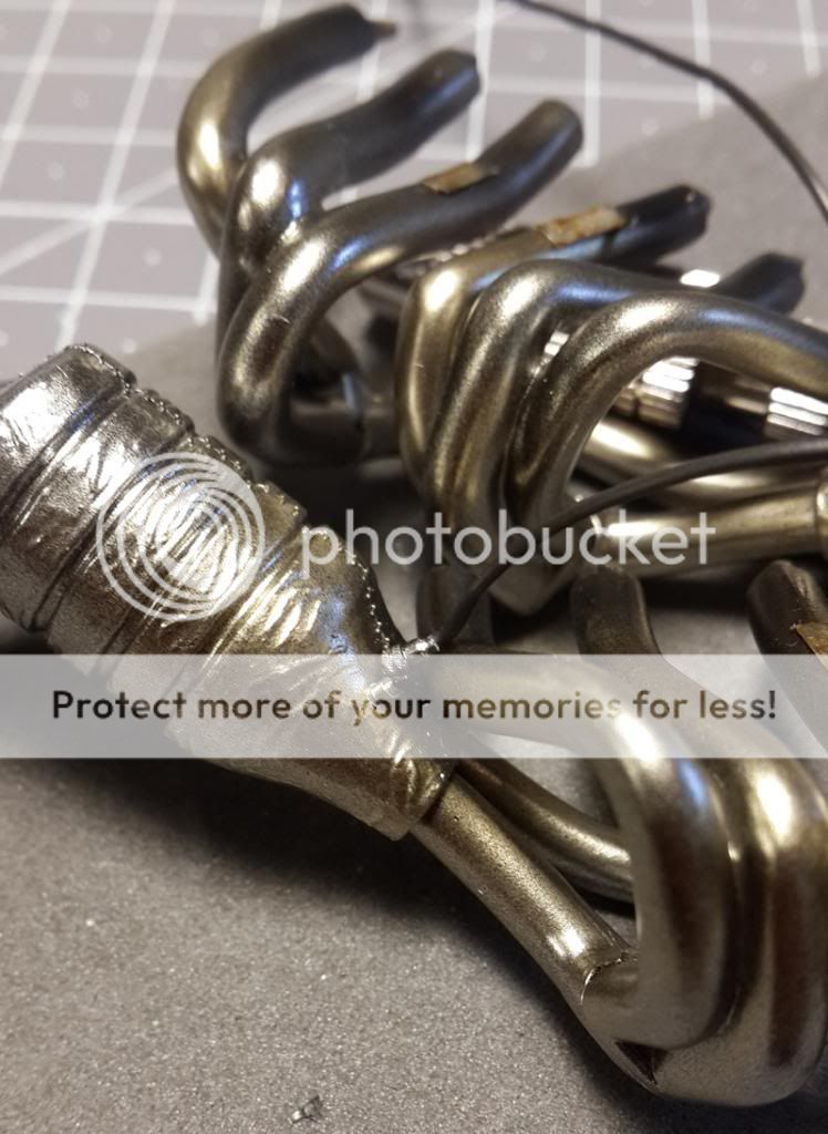

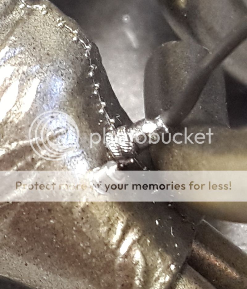

tetra M Posted February 26, 2014 Author Posted February 26, 2014 this is the real car pic i found from google.. i dont know what it is called... but i made it with plastic rod and metal part in the small picture, the left one is the original part.. (sorry for rough pic..my phone is not good at close up photos) i airbrushed muffler with titanium silver and then over coated with clear orange and extra thinned black i used resin parts to make oxygen sensor.... sensor is applied

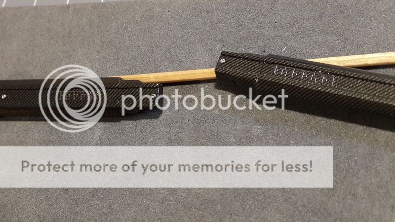

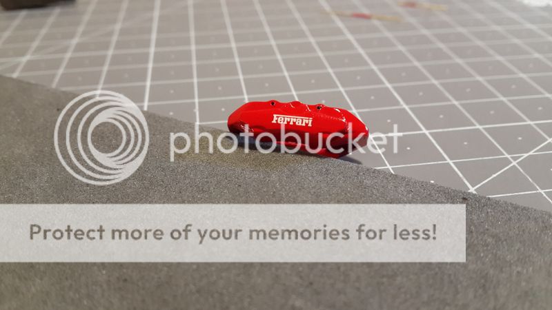

tetra M Posted February 26, 2014 Author Posted February 26, 2014 cf decals and clear coated....the ferrari logo is the original part.. it's easier to apply than hobbydesign's this is it for today.. i tried to post as many photos as possible.. hope you enjoy my build

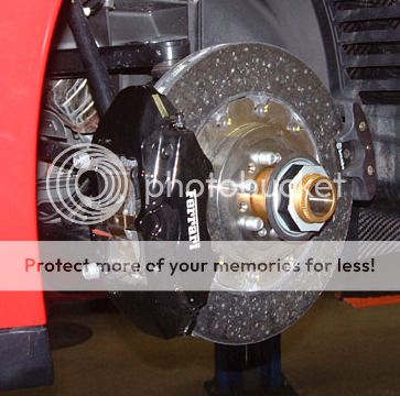

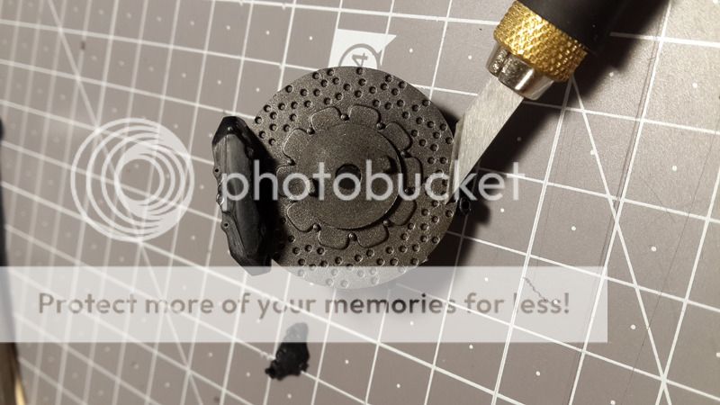

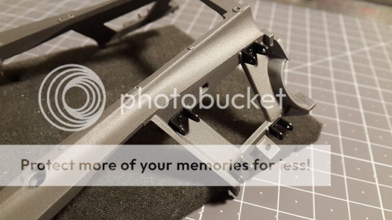

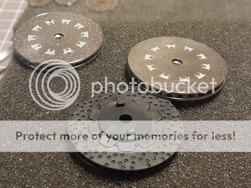

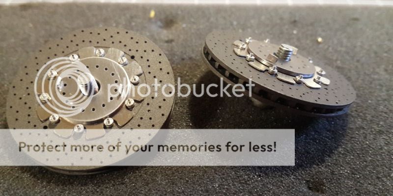

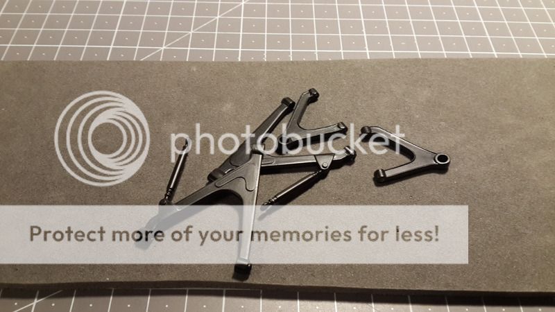

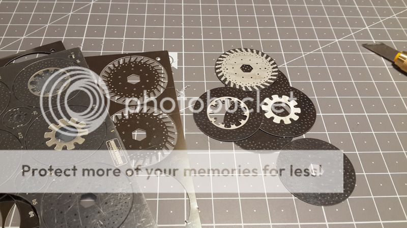

tetra M Posted February 27, 2014 Author Posted February 27, 2014 (edited) hi guys, thank you for your kind comments i really appreciate them:) i've already done some progress but it took some time to pick up photos out of my phone.. (they were mixed with with others and it was like finding a needle in a haystack..) anyway.. rear sub frame was painted with tamiya's metallic grey.. double wishbones were made of white metal parts... looks more realistic than plastic i was thinking of changing rear axles to metal rod... but the original parts look fine to me so, i just painted by the manual. hobbydesign's brake disk set.. 9~10 layers of thick etching parts are supposed to be glued together comparing the original part with nice shiny p/e parts painted with gunmetal and matt coating.. those who want to build enzo with this set need to be careful not to lose any of those small rivets.. each set needs 10 rivets but only 41 rivets are in the package.. every time small rivets and screws just pop out of my tweezer, i never found it... do i think those are worth $50? well, they are good in detail and heavy enough for me to feel like real ones but i think it is a bit over-priced... $25~30 would be fine i was looking for disks and found this pic... oh..i should not have seen this one of course THE tamiya provided nice detailed calipers... but i cut it out.. and left some for brake pads on each side Edited February 27, 2014 by tetra M

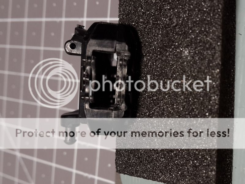

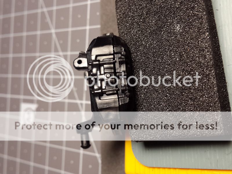

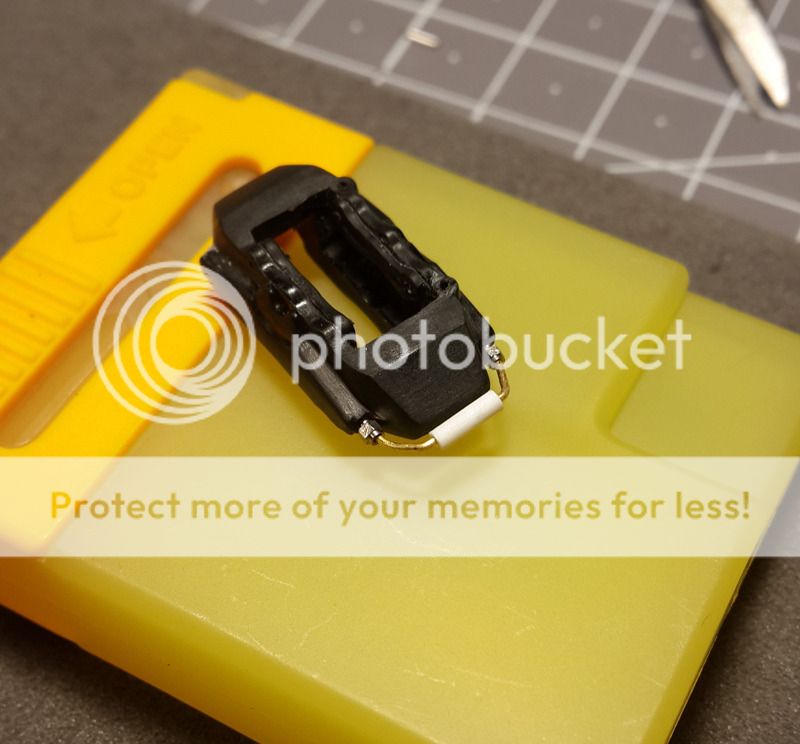

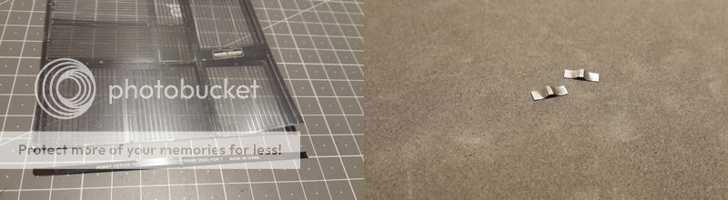

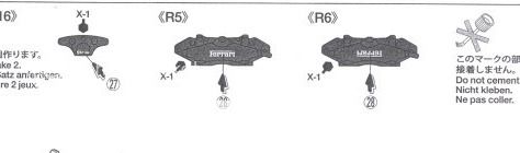

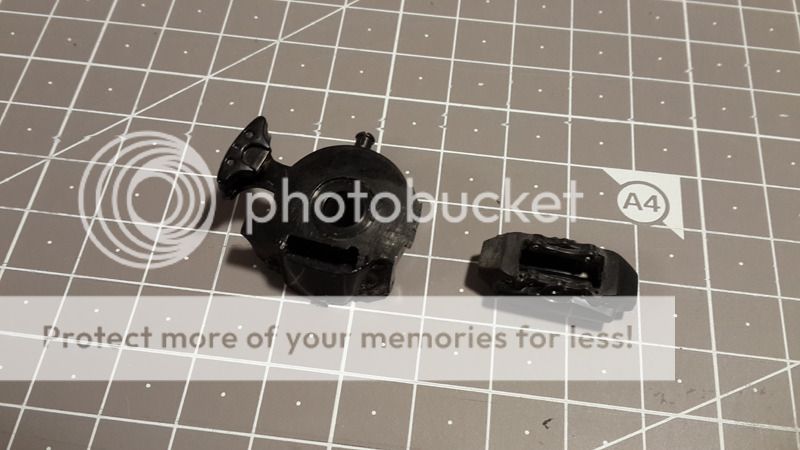

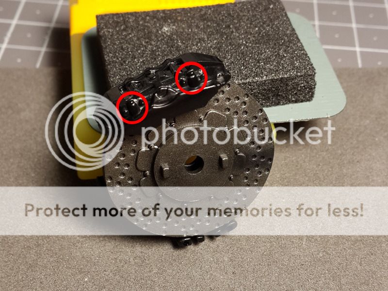

tetra M Posted February 27, 2014 Author Posted February 27, 2014 (edited) see those things inside red circles? -> yes, they are caliper mounting bolts.. and how is the caliper supposed to be mounted on that position?? i thought i assembled wrong but.. sorry for lousy pic if you look carefully... even the manual shows the mounting bolts in the front. it's quite disappointing that $300 premium kit has this kind of flaw.. so i cut it out without thinking how to put it back on... yes.. this is how it is supposed to be... then i started trying to make calipers more realistic.. using side of p/e sheet, i made caliper springs.. 90% satisfied.. but need more adjustment connection pipe was made with metal pipes, plastic rod and brass line painted and applied decal... i'll post rest of photos few hours later.. gotta go to sleep ~ good night Edited February 27, 2014 by tetra M
