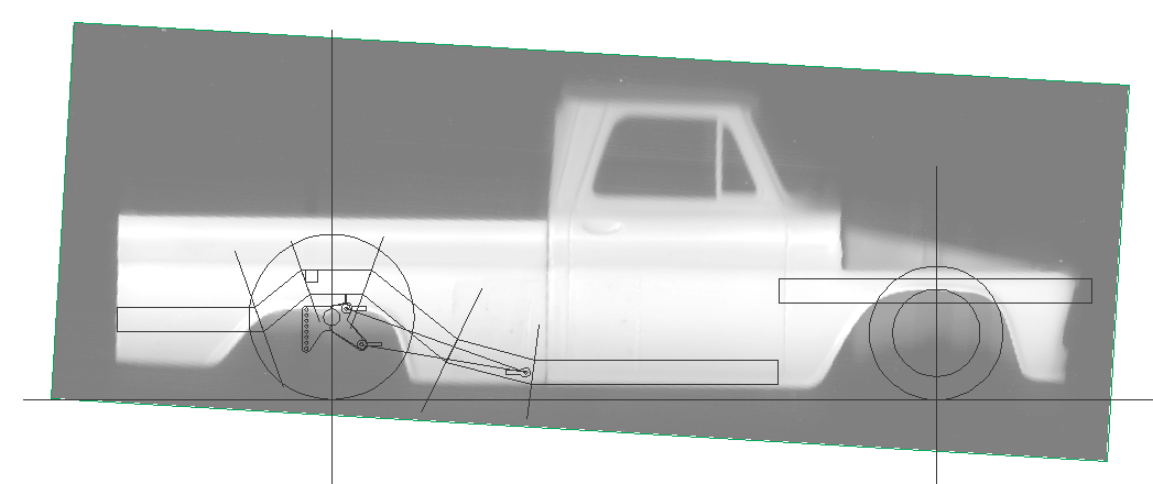

DirtModeler Posted March 5, 2014 Author Posted March 5, 2014 (edited) The Donor kit did indeed arrive today. I started by taping the bed onto the cabin and scanning the whole thing. It allows me to scale it in Corel Draw and lay things out true to scale. As you can see, the big rear slicks that came in the Camaro Pro Stock kit are just way too big.. I thought they would be close for a mockup.. but they are way too big. good thing Mr. Akai is sending me the other tires. After i get the stance the way i want i'll need to layout how the suspension will sit for the top, side, and front views. Lots to go, but it was nice to at least do SOMETHING on the project today. The rectangles are just a super rough placement of the frame rails to scale. I've no idea where they will end up. Edited March 5, 2014 by DirtModeler

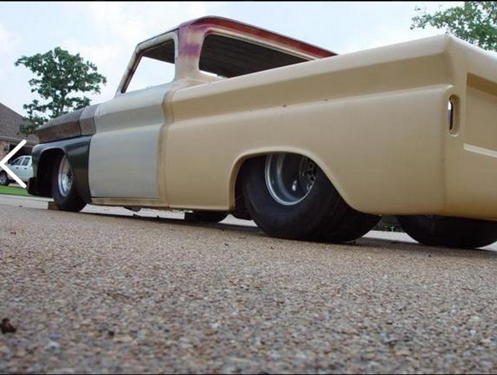

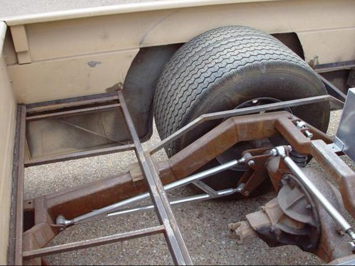

DirtModeler Posted March 6, 2014 Author Posted March 6, 2014 (edited) I had a little more time to work on it tonight, i really only get about an hour a night to work on anything for myself, so progress will probably be slow. I found the rear tire measurement via ebay, so i think that's a good size to work with. I'm kind of stumped on the lower frame rail. On the kit the body sits on top of the frame rails, but on the real truck reference photos, it looks like it's sitting below. The angles on the frame rails seem too extreme to me if i put them anywhere near the bottom of the body, especially when i match them up against the reference photos. I'll keep messing around with it until i find the right spot. In the current location, the ladder bar is angled too far downward. So i'll need to do something, on the reference truck, the front of the ladder bar is mounted really low on the frame rails. Edit, i was playing around, and looking at the reference photos. I think the issue is my truck body is too low to the ground. I noticed the bottom of the cab is just a little bit lower then the outside of the front wheel. I adjusted the body up to about that point, and now the angles look a lot better. (the image from Corel Draw is before i made this change) I hope my updates are ok, I thought I'd share the process that I go through for a build. I like the engineering portion of the build the most. Edited March 6, 2014 by DirtModeler
