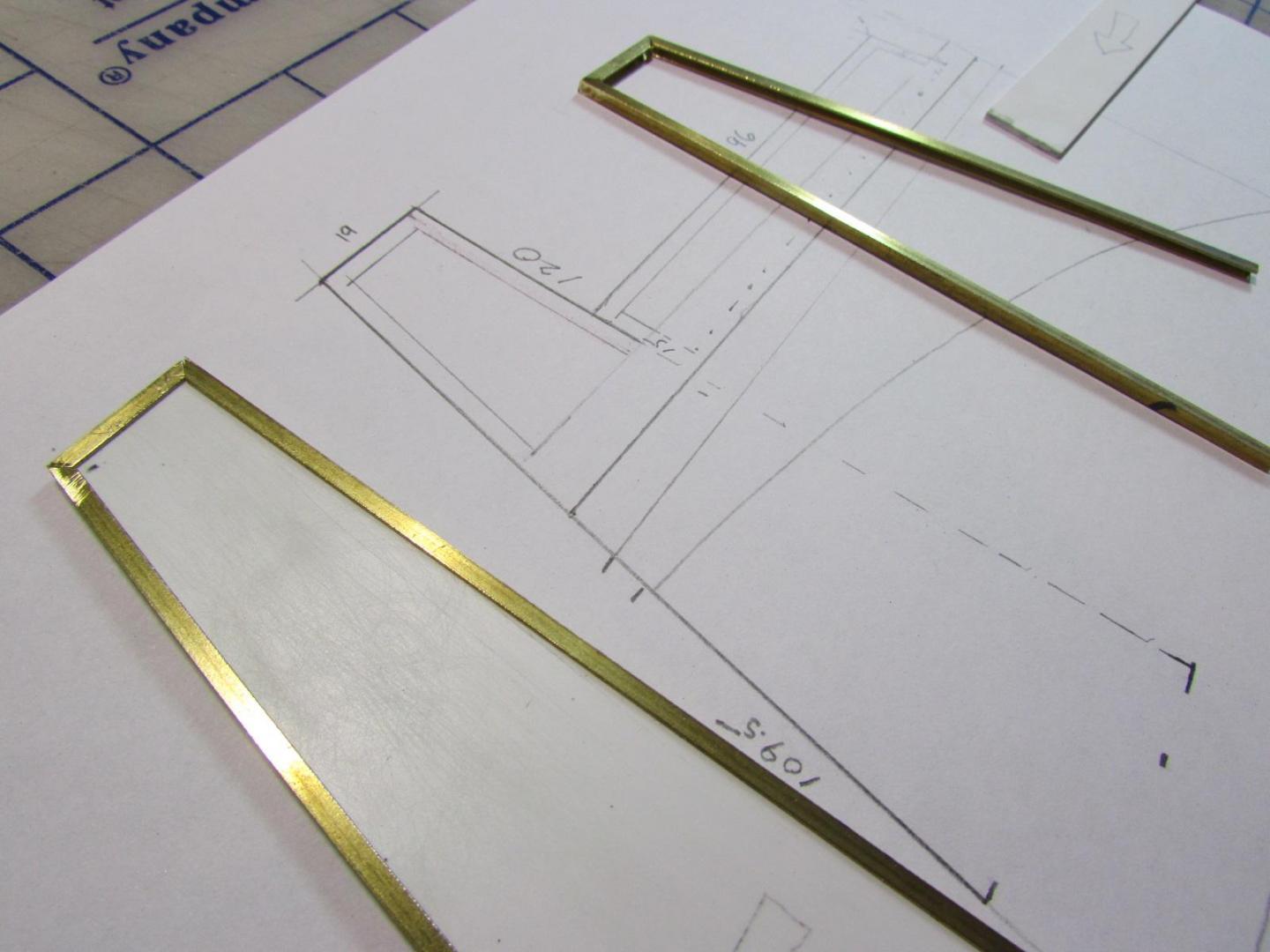

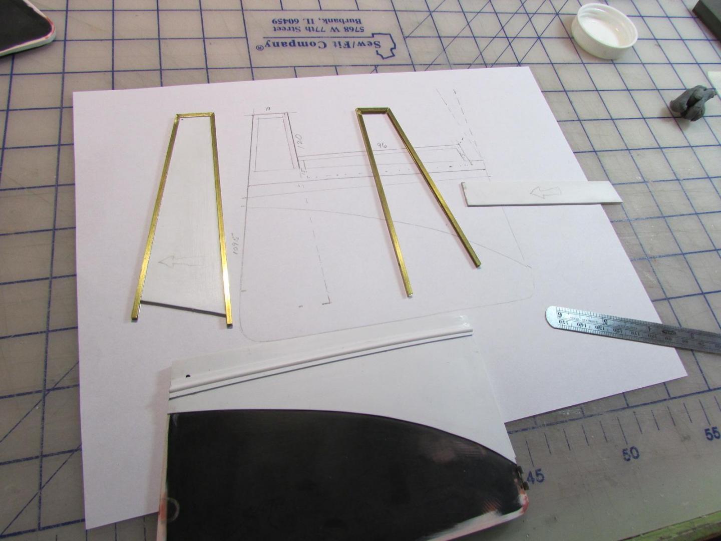

Cato Posted October 21, 2015 Author Posted October 21, 2015 Return to work... After a vicious 10 day bout with what was probably influenza, it's good to be able to accomplish something. Although I had begun the hood just before illness, I was interrupted by the running board strips. Now that the 'boards are done and the strips are out for chrome, I've ordered some brass to correct the hood hinge. While waiting for that, I decided the doors should be finalized. To do that, I need the side window brass frames. The latch mechanism will go under them within the doors. So some time drawing up for templates and making them from .050 was done today. Then, cutting the channel legs on the bandsaw and sanding the mating angles on the disc sander. The front edge is not 90 degrees because it follows the angle of the windscreen. The back edge is 90 but I found it safer and easier to sand the angles of each adjoining leg to mate better than sanding 90's. Got the windwings done today, tomorrow the partially lowered side door glass. Soon a big time soldering session.

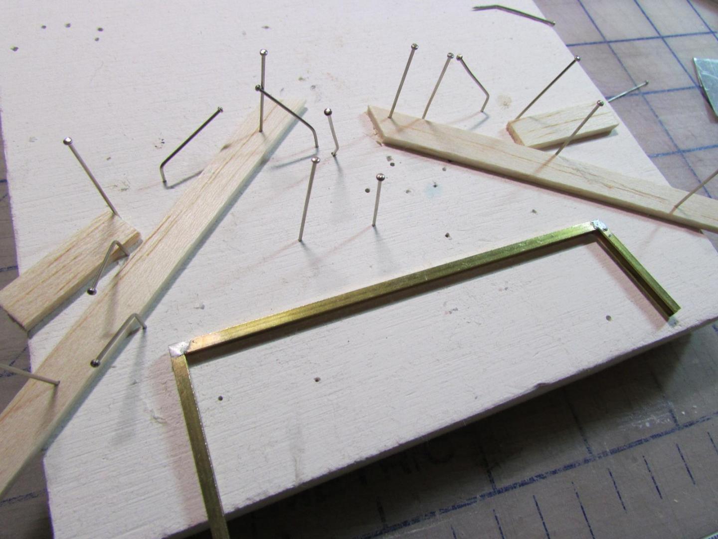

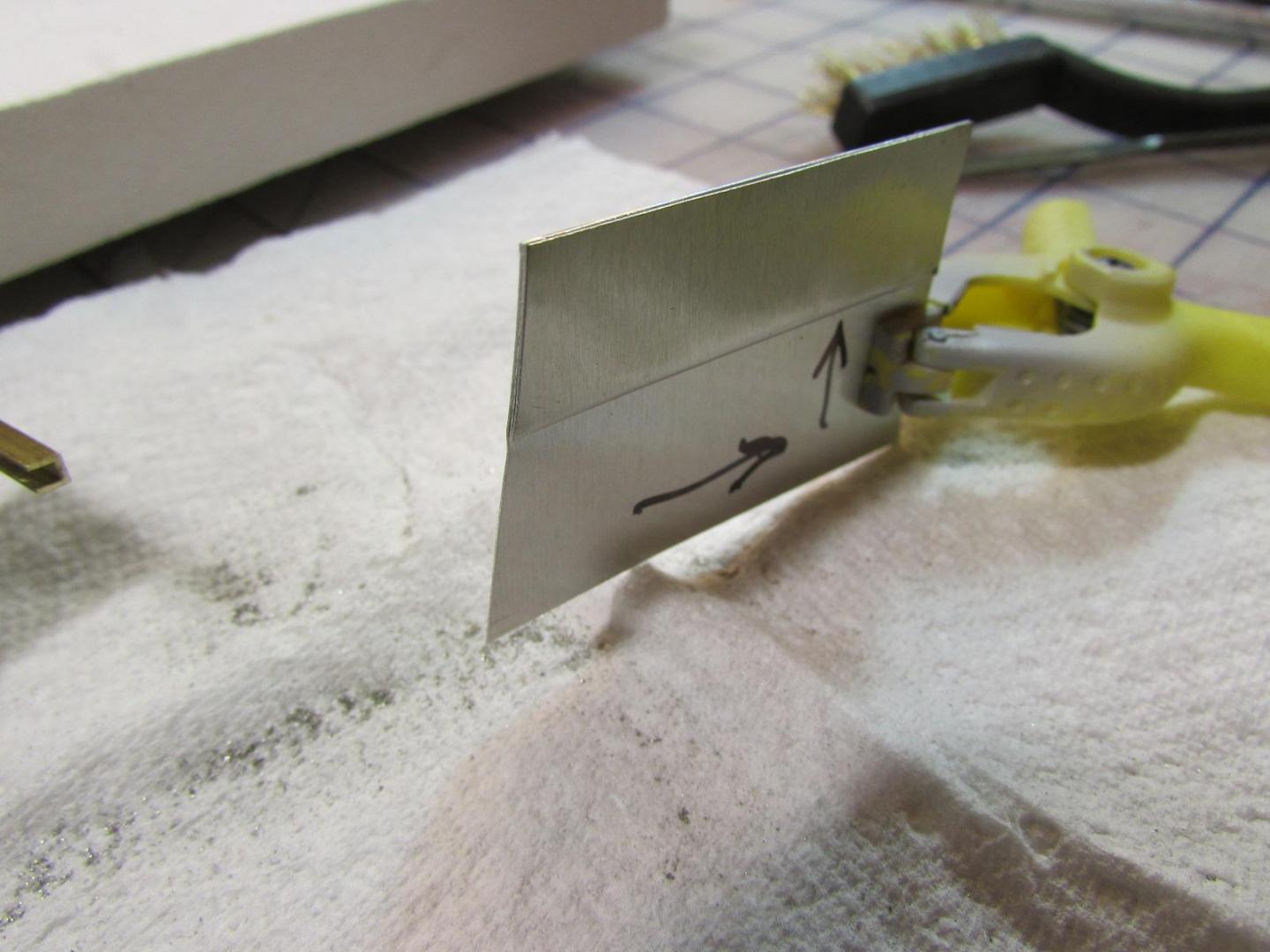

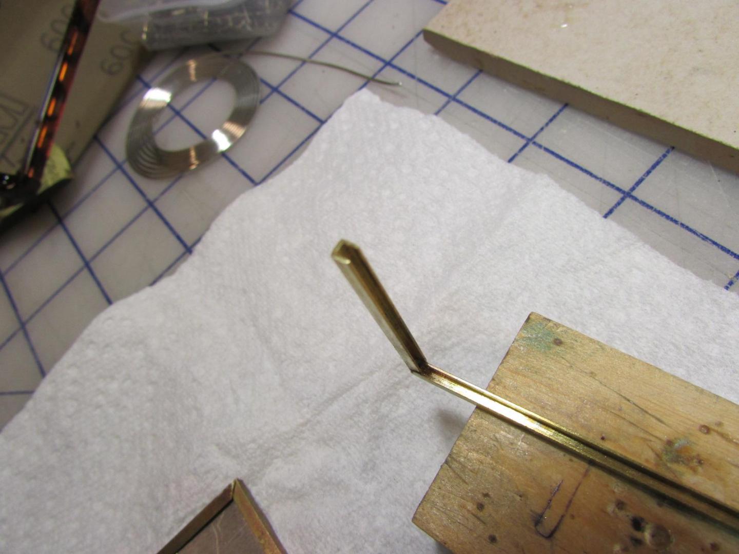

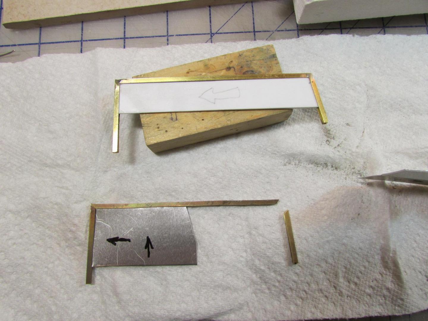

Cato Posted October 25, 2015 Author Posted October 25, 2015 (edited) Here's where we're going... Today, the biggest accomplishment was figuring-out a system. And I did; shown is the miter cut 3/32 square channel for the window frames. Jigged, pinned and silver soldered cleanly.The problem being to solder the corners cleanly and keep silver solder out of the inner channel corners. BY FAR the key to this operation is to keep the channel corners clear so your glass fits. After a lot of experimenting the answer was baking pan ally, folded, cut and bent to fit comfortably into the corners. Silver solder won't stick to it. Worked a charm; no glop inside the corners which the last shot attempts to show. Note the lower blocker has the rear edge cut to match the slope of the rear of the glass; you want no gaps inside or you'll get solder. With just a little file and 220 work the corners are crisp and clean. And the original plastic template fits perfectly as shown. Plenty still to solder and dress but much relieved I've got a reliable system. It took me days to clear the channels in the 'screen frame using folded tin foil (boo) but this took 3 minutes to join and 5 to finish dress the corners.. The sooner I finish the sooner off for chrome; I'm excited to see the 'screen frame and running board strips come home soon. I'm also planning a chrome accessory which will be another soldering adventure... The pros may do this with far less effort and different ways but there are other ways to skin the cat. I'm satisfied the result will be hard to tell from a pro's work. YOU CAN DO THIS; if I can, you can. The look of chromed windwings and partially lowered side glass adds a natural and elegant touch to any Rolls and some of the other Pocher Classics. And better men than I can actually make these things pivot out and lower but my train stops here. I'm OK with that... EDIT: The pictures loaded in the opposite order than I loaded them. Dunno why. I HATE trying to get professional results with this 'progress'. Edited October 25, 2015 by Cato

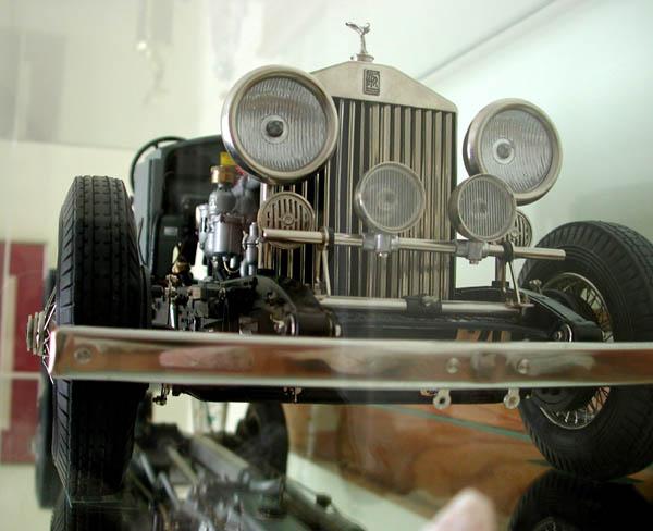

Cato Posted November 24, 2015 Author Posted November 24, 2015 Crawling back... The absence of work lately has been due to very sudden ill health. I am now on the right track (fingers crossed) with docs and meds and may actually survive this. But my beloved Rolls has been untouched for weeks. As mentioned a few posts ago some of the chrome plated parts have returned and really cheered me up. So here's a brief look. I'm planning to actually DO something tomorrow; I'll polish the clear paint on a running board then permanently mount the chrome strips. Tasty. A side note; I know you're probably tired of seeing the major bodywork in black and white raw plastic. I've been encouraged to prime everything 'cause it's cool to see a WIP project at least all one color. But I have firmly been a believer of getting the surfaces near perfect raw, then priming and fine skim coats as needed. I have to handle these big parts way too much which leads to corrupted primer anyway. So the w'shield frame doesn't stand out now as much as it will when the surround is dark maroon with no gaps. But that WILL happen. Pardon the mediocre pictures; small chrome parts are hard to show and I'm not up to my old standards just yet. These actually look way better in person than the pictures; a little shimming under the center will eliminate the small gaps. I'm proud of the curved, kerfed corners with nearly no imperfections- my first such attempt. Then, the secret is to polish the brass until it's flawless, then start all over again. Honest.
