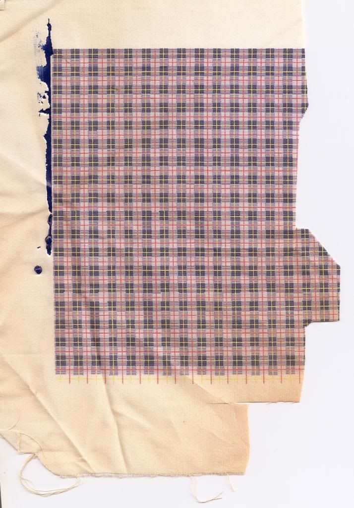

sjordan2 Posted March 19, 2014 Posted March 19, 2014 (edited) You can also get real cloth for inkjet printers at hobby shops like Hobby Lobby, A.C. Moore, etc. This example is several years old and has been stuffed in a file folder. The blue stripe at the left is an experiment in using T-shirt paint to indicate leather or vinyl piping. I'm told that Aleene's Tacky Glue is the best adhesive, but I'm sure there are others that won't bleed into the fabric. See John Teresi's thread in Trucks, Under Glass, on the Mercedes Transporter. Edited March 19, 2014 by sjordan2
