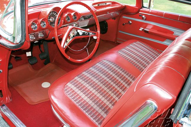

Harry P. Posted March 24, 2014 Posted March 24, 2014 Excellent tip, Matt. There are almost always slight variations in shades of color in a car interior. In a red interior, it would look more realistic if the "carpet" was a slightly darker shade of red than the upholstery or door panels. Again, a Google image search is your best friend here. Don't assume... do the image search, find the appropriate photos, and do your best to recreate what you see. Here's a perfect example of what I'm talking about. This is obviously a "red" interior... but if you took a can of gloss red and sprayed everything with that, the end result would look very "toylike" and fake. Look closely at the photo... See how shiny the dash top and steering wheel is? Painted metal is a lot shinier than vinyl seats or carpet. There's even a difference in gloss between the vinyl part of the seats and the cloth inserts (although the vinyl here is probably Armor-Alled and too shiny)... and see how the carpet is dead flat? And how it's not the same exact shade of red as the dash or the vinyl seats? Getting these little things right will go a long way to making your interiors really look real, no matter what color they are.

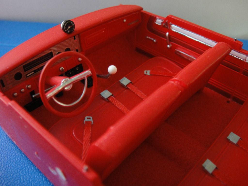

zaina Posted March 25, 2014 Posted March 25, 2014 I also use tamiya red with dullcote. Here us a 64 dodge I did after a little research for the colors.
10thumbs Posted March 25, 2014 Author Posted March 25, 2014 Thanks guys for the tips. Harry P., your in depth description and explanation has come across, and is greatly appreciated. As Andy has shown above, the Dodge has door panels with deep lines. This gives me a wonderful opportunity to apply some "depth" in the interior. Even though the real race cars didn't have a luxurious interior, I feel the model has to have now some extra attention. I've seen them finished and a boring red interior just doesn't hit it, hence my query. So, Germany doesn't offer a great variety of model paints, but I know in the meantime how to spray the he## out of Humbrol paint cans, and I'll get some today. Red it is! I've got BMF, and the race car is getting some gleam. Michael
1972coronet Posted March 25, 2014 Posted March 25, 2014 Mike and Andy , those interiors are perfect ! In my haste to reply , I'd neglected to mention --it's really an addition to Harry's , et al. , replies-- that , given the same top colour coat , that varying the base coats' colours will also provide the desired shades ; for instance : dark grey for the "carpet" , light(er) grey for seats / door panels , and perhaps white for the glossy parts (dash frame , primarily) . This way , you can utilise just one can of top-colour coat , but change its appearance by employing varied base-colour ("primer") coats. Good luck and have fun !
Mike Kucaba Posted March 25, 2014 Posted March 25, 2014 Not to pick a nit, but that dash Harry shows looks like it has padding on it. It's probably vinyl.
TooOld Posted March 25, 2014 Posted March 25, 2014 Not to pick a nit, but that dash Harry shows looks like it has padding on it. It's probably vinyl. Sorry Mike . . . it IS steel .
