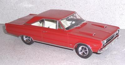

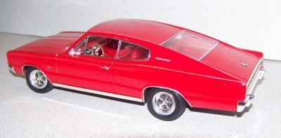

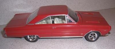

Randytheroadrunner Posted April 11, 2014 Posted April 11, 2014 (edited) That's funny, I've been using alumachrome for years and I don't have any problems. Edited April 11, 2014 by Randytheroadrunner
