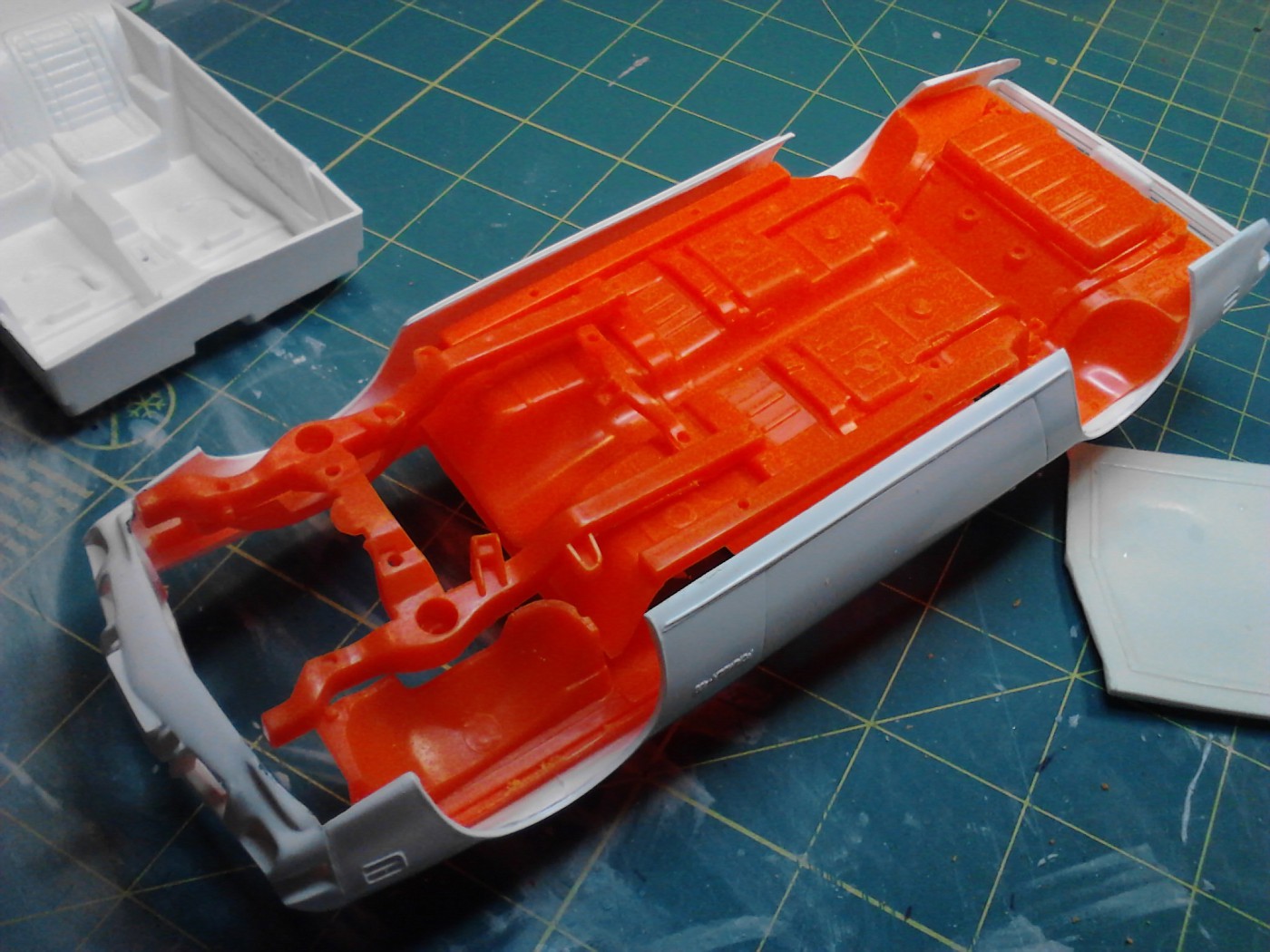

am73grand Posted April 11, 2014 Posted April 11, 2014 (edited) I've always wanted to do a model of one of "Jims" Firebirds. The whitwalle tires were a real turn off for me though. Then I watched the pilot episode and the 'Bird is wearing Goodyear RWL tires. Now this was something I could build. I had a mint unbuilt '74 in my stash so I got to work. I will be combining the MPC 'bird with a new tool '70 Camaro. I got the resin hood from an online vendor and had to narrow it very slightly. I cut the engine bay out of the Camaro: With a little sanding the Camaro floor/chassis drop right into the 'Bird. Edited April 28, 2014 by am73grand
am73grand Posted April 11, 2014 Author Posted April 11, 2014 The orange floor turned out to be warped so I grabbed another from my spares box. I added strips of Evergreen to each side to make the pan wide enough to fit the Pontiac body. I cut the floor and lower door panels away from the Pontiac interior tub and am using the lower door panels from the Camaro Next up I will start building the motor and transmission. Those will come from the Revell '68 Firebird..... Thanks for looking
GMCMAN52 Posted April 11, 2014 Posted April 11, 2014 Great start, I would have never thought of using the Camaro floor....Now I will on my next project

blunc Posted April 18, 2014 Posted April 18, 2014 I performed a "Rockford turn" in my 68 Firebird once, I completed it successfully but it's a bit abusive to the front end if you're not doing it fast enough when you're on a road that's not very slick. it's nice that there is a decent camaro chassis/floor pan to improve the bottom side of your kit bash.

am73grand Posted April 28, 2014 Author Posted April 28, 2014 Been busy detailing the underside of this bad boy. Chassis pan is completely painted top and bottom. I am now working on bodywork and the running gear.
1 bad55 stan Posted April 28, 2014 Posted April 28, 2014 Looks great,i like the way you have painted that frame.
