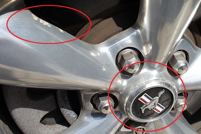

Harry P. Posted April 11, 2014 Posted April 11, 2014 My wheels are starting to get corrosion around the plastic center cap. I can just pop off the caps with a flat screwdriver to expose the corrosion around the center hole. But what's the best way to remove the corrosion? Is there a magic product out there that will melt it away or do I have to use a power tool and a wire brush type thing and physically scrub it off?

Harry P. Posted April 16, 2014 Author Posted April 16, 2014 I don't think this can just be polished away... I'm thinking I need some sort of chemical.
Muncie Posted April 16, 2014 Posted April 16, 2014 Harry, You've got some bad corrosion going on there and it looks like the clear coat is failing - as they say, that's not going to buff out.. Sanding (very fine) and polishing will remove the corrosion but it's going to come back unless the clear coat is repaired or redone. Your car is too new to have this problem - can Ford do anything for you? factory service bulletins? anything on the Mustang forums? You can't be the only one with this problem. it may have been mentioned - try a little bit of polish on a spot where the wheel is still good - if the rag turns black the wheel is not coated - if the rag doesn't change color, the wheel is clear coated. Corrosion like that at the wheel centers can actually start at the wheel mounitng surface (contact between dis-similar metals) and spread to the outer surface. It may look worse inside the cap... sorry - hate to see that happen

astroracer Posted April 16, 2014 Posted April 16, 2014 Harry,The clear coat will need to be stripped off before you can do any polishing. The real problem here is the clear coat gets a chip or cut in it and that lets the air and water react with the aluminum. Once the oxidation starts it just worms it's way under the clear coat and bites deep into the aluminum.Once you get the wheels stripped and re-polished I would be very hesitant to re-coat them. All you are doing is setting yourself up for the same issues as soon as the rims get a stone chip. Leaving them bare is more work but at least you can keep them polished.Go to Eastwood's site and look at their polishing kits. I have used their kits for years and they provide everything you need to get this job done.The only way to fix this is to sand the corrosion out with 180 grit paper. Once you have most of the damage removed you can start working your way up through the grits from the 180. Use WD40 as a lube and wet/dry 220, 400, 600, 1000 finish up with 2000 and the rims will be ready for a high polish with red and white rouge. This IS a lot of work but it's cheaper then new wheels if Ford can't do anything for you.Mark

Harry P. Posted April 26, 2014 Author Posted April 26, 2014 After some online research and reading your comments, I've decided that the only way to really get rid of the corrosion is to sand it off. So that's my Sunday (tomorrow)... jack up the car one wheel at a time, pull the wheel, pop the center cap out from behind, sand all corrosion off, then rubbing compound and polish... and finally some VHT hi-temp clear on the sanded areas (meant for aluminum wheels) that I picked up today at Autozone. It should be a full day's work, seeing as I don't have a floor jack and have to use the scissor jack in the trunk. But there's no way to pry the center caps off without gouging either the wheels or the caps themselves (or both), so the best way to go is to remove the wheels. And besides, I'll have better access to the wheels for sanding/polishing/clear coating once they're off the car and I can lay them down flat on my garage floor.

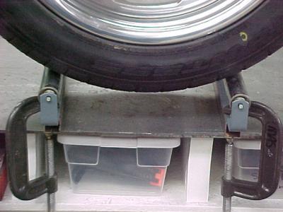

astroracer Posted April 27, 2014 Posted April 27, 2014 Bill has some good points Harry. You will have to step up through the grits to get the aluminum anywhere near ready for polishing. Just like I stated in one of my earlier posts, 2000 grit will be your minimum to get the shine back. And it will need to be feathered out to keep from making "waves". This is the rig I set up for polishing wheels. Much easier to stand upright to work on this stuff then bending over working on it on the floor. Couple of cheap rollers clamped to my fab table. The wheel spins in place and makes it easy to access all surfaces.
