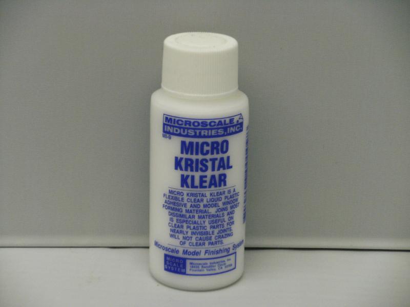

om617 Posted May 12, 2014 Posted May 12, 2014 I use this,it dry in a phase wich will allow you to adjust some time after putting it on.
Pete J. Posted May 12, 2014 Posted May 12, 2014 I use this,it dry in a phase wich will allow you to adjust some time after putting it on.+1
Ace-Garageguy Posted May 12, 2014 Posted May 12, 2014 The best thing about Micro Krystal Klear, Elmer's, and other PVA glues (polyvinyl acetate) is that they're WATER SOLUBLE when wet, and they dry COMPLETELY CLEAR. They don't attack the plastic like normal plastic cement (either liquid or tube) does, so there's no possibility of leaving permanent fingerprints. They don't 'smoke' the plastic like some CA super-glues do. And being water-soluble, you can get excess off using a damp Q-tip. You don't have that option with epoxy if you get it on the clear part. The down side to using PVA glues is that they're not really intended to glue NON-porous materials like styrene. Using them for windows is really kind of a stretch, but they work VERY well if used correctly. They have NO wet strength though, so parts need to be clamped, jigged or taped in place until completely dry. They do a beautiful job of holding lenses and window glass in place with no visible fogging, and fingerprints will come off, like I said, with a damp Q-tip. It's also possible to remove parts glued with PVA relatively easily, because the bond is not as strong as epoxy, and doesn't attack the plastic like solvent glues do. This property of PVA glue also makes it much safer to use for attaching parts to PAINTED surfaces.

Tom Geiger Posted May 13, 2014 Posted May 13, 2014 I use the Micro Kristal Klear for most of my clear parts assembly including headlight lenses. Another thing we use it for is to create the glass over dash gauges. Just paint your gauge detail then put a blob of this over it. It looks like heck, a blob of white... but let it dry overnight and you will have a clear lens with some depth to it over your gauge! I discovered another use for it last week. I had a kit decal that I wanted to apply inside the side window of a car, with the print side facing outward (against the glass). So I soaked it long enough to remove the standard decal glue, then put it on a blotter to dry overnight. I then put Micro Kristal Klear on the face of it, and pressed it down onto the kit glass. I let it dry and it worked perfectly! That will come in handy with the decals that Revell put in the woody wagons (47 Ford and 49 Merc). Both come with surfing and travel decals that they tell you to put on the glass... but on the outside of the glass, when all the stickers like those I remember were applied on the inside of the glass. So now you can do it right!
