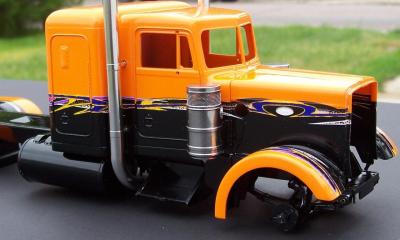

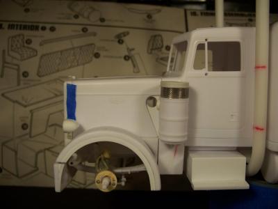

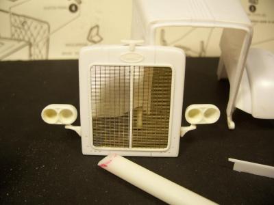

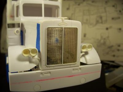

purepmd Posted May 15, 2014 Posted May 15, 2014 (edited) I wanted to take a break from the rivet counting, and there is a resin 358 hood on the bench, just staring at me, (saving that for the California Hauler reissue). So, for a fast, (for me), fun project, I ripped into a snap Pete. Wanting to do it up in a different style than I usually do, so a custom 358 is the result. Here are a few pics, including a mock up so far. I narrowed the grille and hood, used AMT headlights, (still my favorites), added photo etched for the grille and air cleaners, streched it to a 285" wheelbase, with a smooth frame insert, and am going with straight pipes The smoothed the battery / storage boxes are kit parts, and the brakes are from the parts box. The resin rear fenders were so warped, I had to use a 1/16th " steel rod as part of the front and rear mounts to keep them square, even after hot water and some tweaking. Thanks for looking, Mark. Edited February 1, 2015 by purepmd

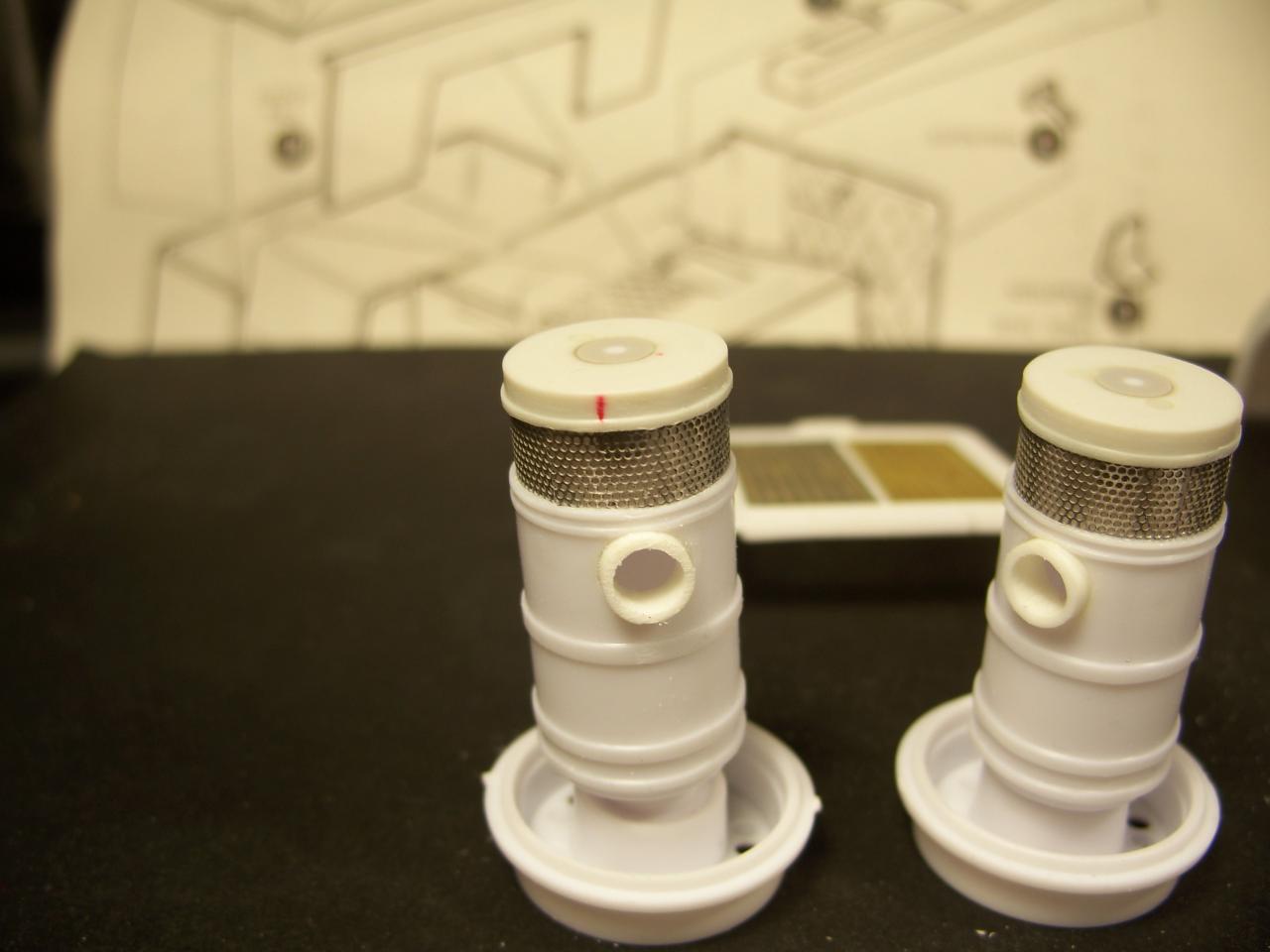

purepmd Posted May 15, 2014 Author Posted May 15, 2014 (edited) Thanks guys. The air cleaners are the ones from the Revell snap W900, with some spare AMT wheel backs, for the lids, filled in with Evergreen tube and rod to form a centering post over the post on the body for the snap chrome hat. The wheel backs measure a scale 15", so do the air cleaners, making for a decent representation of a 15" Vortox unit. The grille and air cleaner screens come from Plano Model Products, in Plano, Tx. Edited May 15, 2014 by purepmd

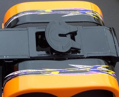

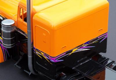

purepmd Posted July 18, 2014 Author Posted July 18, 2014 (edited) Hey Guys, As you all know, during summer it is hard to get all the bench time you want, but I have managed to slap some paint, decals, clear and Alclad on to this thing. The orange is Tamiya X-6, and the black is X-1. I have polished it out using Mcquire's cleaning wax, but just have not photographed it yet. The wheels are modified,and stripped Italeri outers mated to Revell snap inners, covered with Alclad Chrome. Thanks for looking. Edited July 18, 2014 by purepmd
