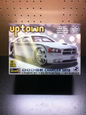

ouel88 Posted May 26, 2014 Author Posted May 26, 2014 (edited) Thanks for all the advice guys appreciated! Here is the kit I started saturday this weekend. Edited May 26, 2014 by ouel88
