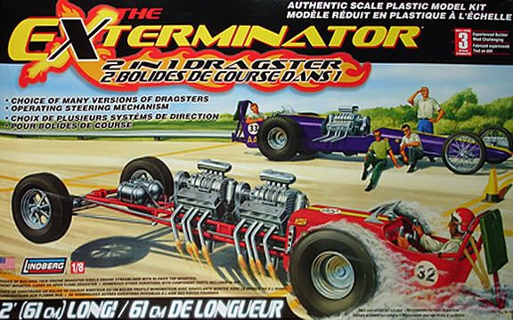

Harry P. Posted January 3, 2008 Author Posted January 3, 2008 I'm talking about this model: It's a generic representation of a typical late 50s/early 60s dragster. It can be built in many version, including twin-engine, and both blown/injected or carbureted. I'm specifically building the single-engine, blown version. The kit doesn't say what engine size is represented.

Modelmartin Posted January 4, 2008 Posted January 4, 2008 Harry, Since that engine can be almost any cubic inch size you want you might as make it bigger, right? The style of that car puts it in the early 60s so I would say you are perfectly safe in calling it AA/FD. That would be if it is a nitro car.
Harry P. Posted January 4, 2008 Author Posted January 4, 2008 I guess it could be a nitro car, but I thought that back around 60-61 or so most dragsters were still running gas. AA/FD for nitro, AA/D for gas?
Modelmartin Posted January 4, 2008 Posted January 4, 2008 Harry, I just pulled out Don Montgomery's Dragster and Funny Car Memories for research and here is what I found. Only NHRA banned nitro but lots of strips were still running fuel car shows. The kit you have is dated mostly by the roll bar style which was rarely seen after 60-61 or so. That style of frame was not seen before maybe 58-59. Depending on sanctioning organisation, year, and fuel your kit can correctly be any of the following - AA/FD, AA/GD, A/D, A/FD, or A/GD. How about them apples! Pick the one that sounds good or you already have the decals for. I will be looking forward to seeing that kit built. I have never seen it built and I know you will do it justice.
mr moto Posted January 4, 2008 Posted January 4, 2008 I guess it could be a nitro car, but I thought that back around 60-61 or so most dragsters were still running gas. AA/FD for nitro, AA/D for gas? There were several years in the early sixties when the NHRA outlawed the use of fuels other than gas. I'm not sure about the other orginizations. If you read Hot Rod, Car Craft or Rod&Custom (all Petersen Publishing Co.) in those days you only heard about the NHRA because Wally Parks was head of NHRA and editor of Hot Rod. Anyway, I think fuel was allowed starting in '63. Fuel pretty much killed off the twin engine dragster because the limiting factor on speed became traction instead power. So I'd say if you build with two engines make it AA/D. If you build with one engine it could be either AA/D or AA/FD or even A/FD. Some of the fastest dragsters of the day were actually A/FD (look up Rivero-Weekly-Holding -Fox otherwise known as "The Frantic Four"). Once again probably because traction was so limited with the tires of the day, no downforce, etc. that you could give away a few cubic inches and still be just as fast.
old-hermit Posted January 4, 2008 Posted January 4, 2008 If you have some time and want to do a little research start here. http://www.draglist.com/sitemap.htm The kit decal sheet has AA/D with B,C options depending on which version you build, single engine - blown or carbed, dual engine - blown or carbed etc...
Harry P. Posted January 4, 2008 Author Posted January 4, 2008 I will be looking forward to seeing that kit built. I have never seen it built and I know you will do it justice. Thanks! I've already started with the preliminaries...gluing together engine block halves, front axle halves, fuel tank halves...basically all parts that are molded in halves! I need to take a trip to the LHS tomorrow and pick up some styrene, aluminum and brass rod and tubing so I can scratchbuild all the fuel system fittings...I can't just leave it at the "stick the tubing on the pin" level of detail! I'm going with a natural cast look to the blower-no chrome-and I'll be using the mag wheels and slicks from the Big Deuce instead of the kit wheels/tires, just cuz I like the look of the Big Deuce "vintage" mags. Not sure if I'll keep the slicks as whitewalls, tho...I haven't seen too many photos of cars of this era running whitewall slicks! (just one, in fact). I've already picked up the paint. I'm going with my favorite, DupliColor. Turquoise frame and engine block, gold (actually GM "Buckskin") body. I think the turquoise and gold color combo looks period correct. Thanks to all for your input. This is going to be a fun buildup.
