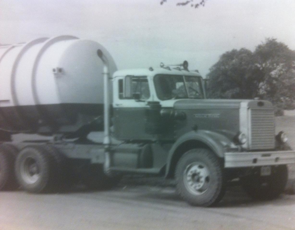

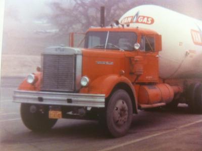

Superpeterbilt Posted May 30, 2014 Posted May 30, 2014 The easiest way to build this truck would be using an Autocar A64B kit, a d a Diamond Reo kit.Using the hood top, sides, fenders, fender mounts, and radiator from the Autocar kit and transplant it to the diamond reo. You can build it all from the Autocar kit, but you would have to move the axle forward and modify the steering assembly. ( if you do it the other way, then you can build a heavy set back axle diamond reo after). Anyhoo, with some mods to the fenders( cut off the front flat section and move them forward) and some mods to the radiator( make it thinner and slightly narrower) it can be done. If you go to Tims Trucks site, Im pretty sure hes done this. Ive done it several times, but I dont have any pics to show you. When I use an Autocar as a resin donor, then I have the hood and fenders left, I buy a diamond reo and build a west coast Autocar. Ill send you some pics and info on this truck later today. Also, on the rubber duck do not waste your money on the Ertl kit. Its not even the right model Mack. Dave Natale at AITM has made a complete correct kit. Its resin tho....... But for the price those kits are going for, and its the wrong truck.

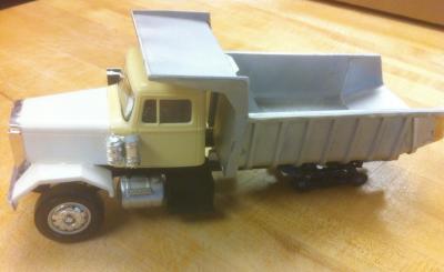

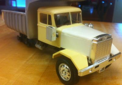

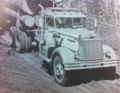

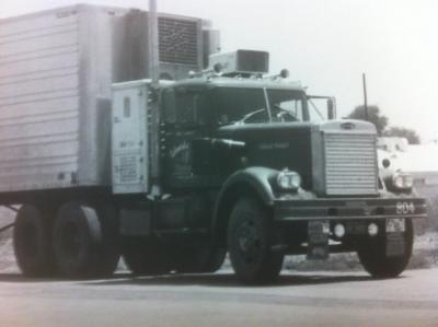

Superpeterbilt Posted May 30, 2014 Posted May 30, 2014 The model number is A10264. Here are a few pics

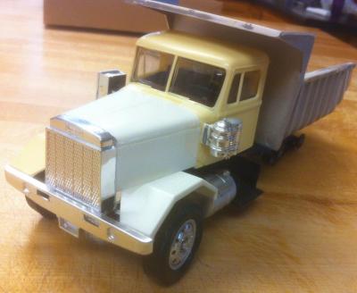

Superpeterbilt Posted May 30, 2014 Posted May 30, 2014 Heres my build of the same truck with pit fenders. The chassis was a built up road boss, the dump box is the modified trailer that came on a built up Mack DM800, modified to a rock style bed. It has a Peterbilt front bumper. Im going to finish it with some resin off-highway spoke wheels and tires.

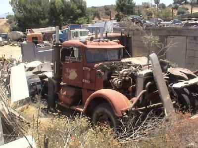

Petetrucker07 Posted June 27, 2014 Posted June 27, 2014 Just happened to stumble on to this pic. I have no info about it, except i know its the movie truck and its a shame that this apparently is how the stallone over the top autocar is gonna spend its retirement, take a minute to bow your heads
Superpeterbilt Posted June 27, 2014 Posted June 27, 2014 Just happened to stumble on to this pic. I have no info about it, except i know its the movie truck and its a shame that this apparently is how the stallone over the top autocar is gonna spend its retirement, take a minute to bow your heads There were fhree of these used in the movie that were all cement mixers from what I understand. Theres also a photo of just the cab sitting on the ground.Im not sure if any of them survived, but they were used in a few more movies before being retired.
Petetrucker07 Posted June 27, 2014 Posted June 27, 2014 Yeah i did a little diggin, the cab was used for the in cab footage, somebody saved 2 of the trucks from the bone yard and the 3rd was re-painted silver and extra push bars and a sort of cage around the cab, far as i could find so far the 3rd remains in the bone yard
