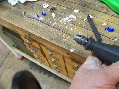

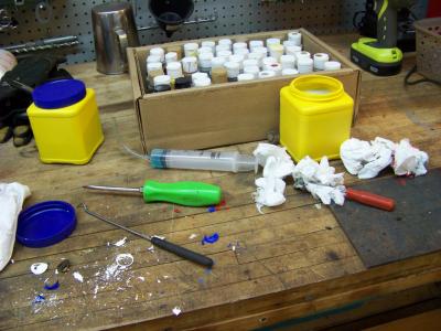

Narampa Posted June 3, 2014 Posted June 3, 2014 I have been following Chris Chapmen on U tube and I am sold on Acrylics. I have used them in the past for details and small parts but never sprayed it. Anyway I have 52 bottles that were over 15 years old. I had them in a box stored in the basement. I took them down and out to the garage. I removed the caps scraped off the dry paint. I found that the paint had separated and the pigment was on the bottom and a glue like substance was on the top. I made a mixer for my Dremel tool and started to stir them. What I found was after about 1.5 hrs I had 51 bottles ready to go. Only one bottle did not survive the years. I know that because I was able to rejuvenate this paint is because it was stored in a cool place. I would recommend storing Acrylics in a cool area. 15+ years and all is good Now I just have to get up the nerve to spray my first body. Just thought you might be interested!

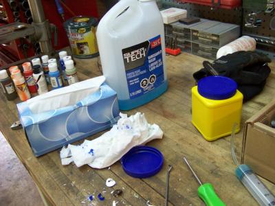

cchapman195 Posted June 3, 2014 Posted June 3, 2014 Way cool of you to share this tip. Another tip I have for you is you can thin and store these paints for years as well. Dr. Cranky did a vid showing some that were thinned 4 years ago and it sprayed great. I myself got some 8 oz squeeze bottle's and fill half full with flat black and the other half with washer fluid. I now have 8oz of pre thinned paint ready to go of my most used color and I still have half a bottle unmixed for brush painting. That way I do not have to mix a batch every time I paint a frame and chassis. Thanks for posting this and go paint a body. It will be fine.

Narampa Posted June 3, 2014 Author Posted June 3, 2014 Way cool of you to share this tip. Another tip I have for you is you can thin and store these paints for years as well. Dr. Cranky did a vid showing some that were thinned 4 years ago and it sprayed great. I myself got some 8 oz squeeze bottle's and fill half full with flat black and the other half with washer fluid. I now have 8oz of pre thinned paint ready to go of my most used color and I still have half a bottle unmixed for brush painting. That way I do not have to mix a batch every time I paint a frame and chassis. Thanks for posting this and go paint a body. It will be fine. Wow thanks for the tip. I am going to go to the dollars store and mix some up. Nice to know the shelf life is long when mixed.

charlie1961 Posted July 18, 2014 Posted July 18, 2014 (edited) very nice! i made mine out of an old battery powered toothbrush (took the brush and neck off to get to the drive) used a medal rod like are used in some kits for a wheel axel and a propeller of an old boat model. works great! Edited July 18, 2014 by charlie1961
