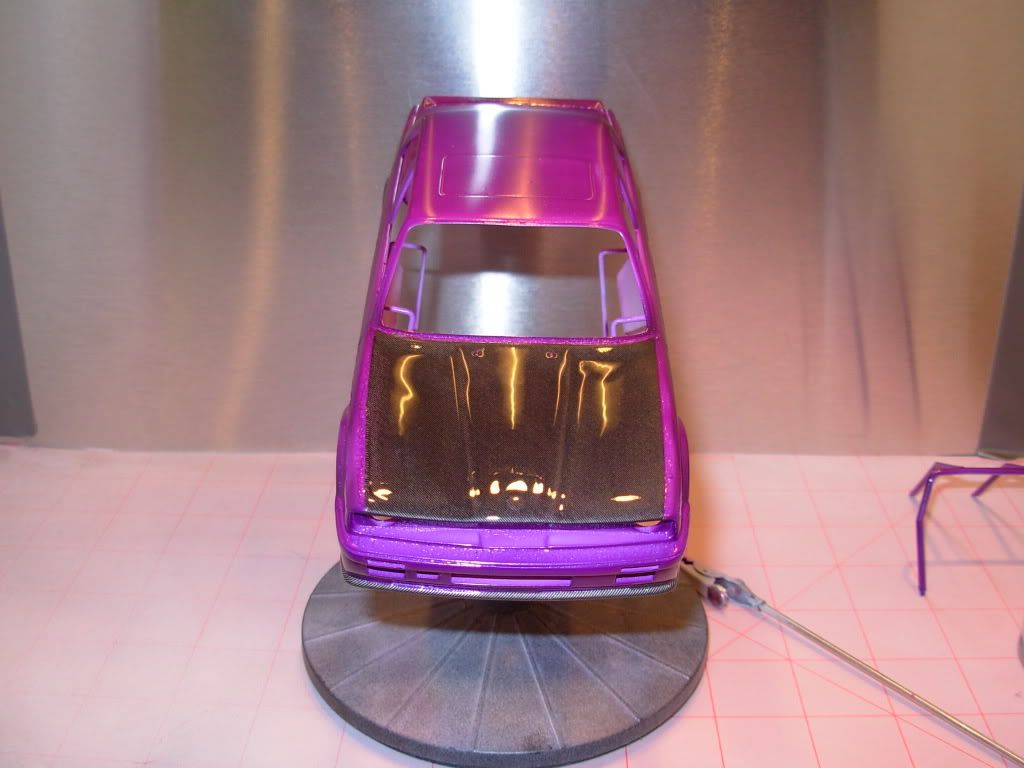

stanleymsn Posted January 31, 2008 Posted January 31, 2008 the model master decals is no good but the scale motor sport is awsome here is a pic of it on my Bmw.

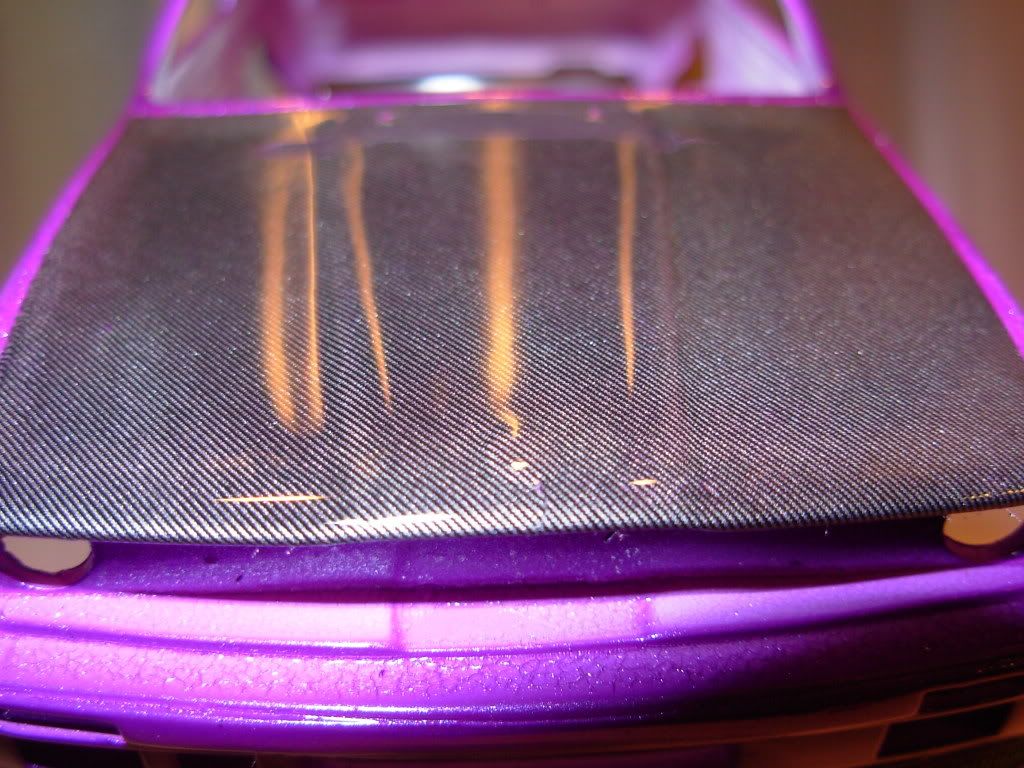

Jairus Posted February 14, 2008 Posted February 14, 2008 I only shoot Testors model master clear over my Scale Motor Sports decals and have never had a problem! I admit that they are very thin and rip easy. But, getting the rip matched up is simple matter and they dry without the crack showing. I guess it's hard to see here... but the entire interior floor and firewall plus the door panels are completely covered with SMS carbon fiber decals. Took weeks to get it all done and many sheets of decal paper!
