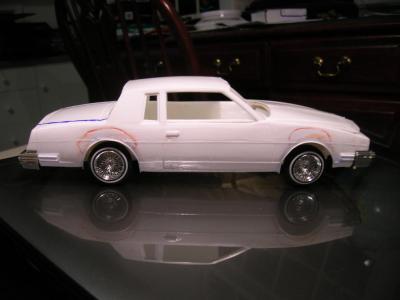

Bob Ellis Posted July 3, 2014 Posted July 3, 2014 (edited) I used to own a 1984 Pontiac Grand Prix. The only kit available are NASCAR varieties of this 1981-1987 Pontiac G body car. Several people have done this conversion; many times using the 1/24 Monogram Monte Carlo as a basis. I decided to stay with 1/25. The MPC Grand Prix NASCAR kits had nice bumpers. The also had huge wheel opening bumps. This is a big job to eradicate. The MPC '80 Class Action Monte Carlo provided the glass, interior tub, chassis and 305 Chevy V8 engine I needed. With very little filing, it all fits I originally omitted the photo of the best available MPC Monte Carlo kit. I got one at a local store relatively inexpensive. It was re-issued by Round2 in 2008. Edited July 3, 2014 by Bob Ellis

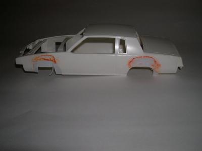

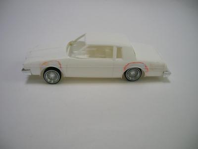

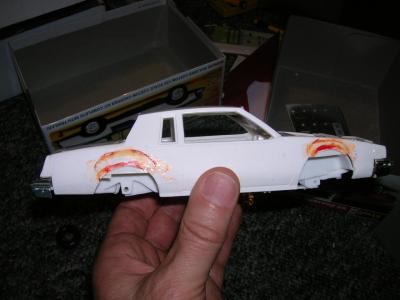

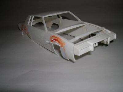

Bob Ellis Posted July 3, 2014 Author Posted July 3, 2014 (edited) I ground off the huge NASCAR wheel openings with 60 grit mounted on a flat plate. Once the wheel bump is ground off flat to the side, you find that there is very little plastic material remaining in critical areas. A lot of patching is necessary with Evergreen Styrene. At least 2-3 layers inside to keep the body intact. Everywhere you see red magic marker is new patch material. Edited July 3, 2014 by Bob Ellis
Bob Ellis Posted July 3, 2014 Author Posted July 3, 2014 I don't like to fill with putty early in the job. I stuff holes using solvent welded plastic.

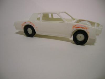

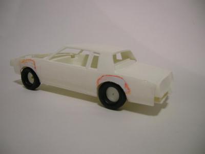

Bob Ellis Posted July 3, 2014 Author Posted July 3, 2014 (edited) Grand Prix wheel wheels are round. I marked the circle with a wheel and a magic marker on the patched material. To get a perfect round circle. I wrapped 60 grit paper around a 1/25 tire. Rotating the tire and 60 grit eventually gave a decent circular shape. At this point, you can see the '80 Monte Carlo frame with wheels fits very nicely into the NASCAR body. Edited July 3, 2014 by Bob Ellis

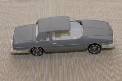

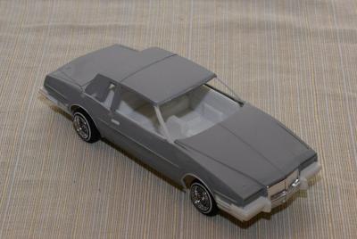

Bob Ellis Posted July 3, 2014 Author Posted July 3, 2014 It looks sort of done here, but it is far from done. Now it has the look of a stock Grand Prix.

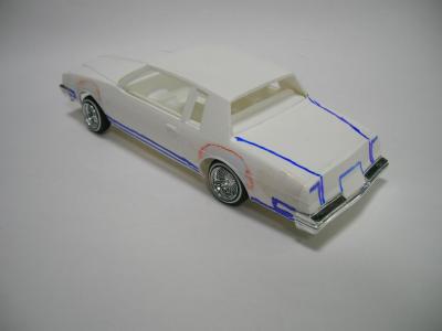

Bob Ellis Posted July 3, 2014 Author Posted July 3, 2014 I like to plan details with a magic marker based on photos. I rough it in. Evergreen is used for body shape and chrome.

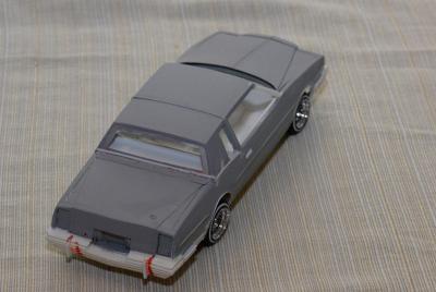

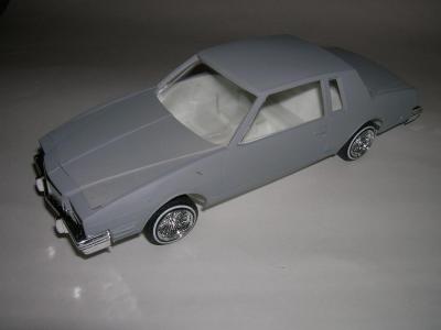

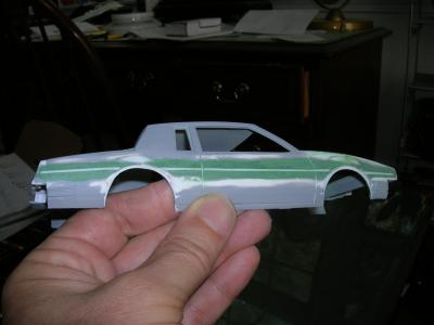

Bob Ellis Posted July 3, 2014 Author Posted July 3, 2014 Primer is a good way to find defects. Still needs a lot more work.
Bob Ellis Posted July 3, 2014 Author Posted July 3, 2014 I wasn't that happy with the side. The Grand Prix has a unique crease along the side. I made a new one using a thin strip of Evergreen and putty above and below the strip.

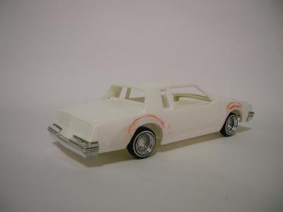

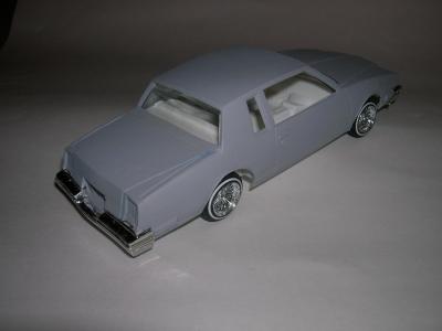

Bob Ellis Posted July 3, 2014 Author Posted July 3, 2014 (edited) I re-did the side chrome after redoing the side crease. It's looking pretty good now. This will be a Lowrider. This gives me a little artistic license to stray from absolute bone stock. The bumpers had to be cut, in some cases stripped of chrome, and then re-glued to the body. There is not a lot of true chrome on a '84 Grand Prix. A fair bit of the NASCAR bumpers, though look stock, should be painted body color. At this point, you can see that the '80 Monte Carlo chassis and interior fits very well. While not in place in this photo, the glass also fits in place too. The NASCAR roof A posts were all wrong. I sliced off the Monte Carlo A posts and attached then to the Grand Prix. Edited July 3, 2014 by Bob Ellis

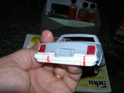

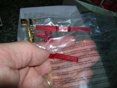

Bob Ellis Posted July 3, 2014 Author Posted July 3, 2014 If you are looking for stock 1/25 1984 Pontiac Grand Prix tail lights, you won't find them. I went threw my leftover kit parts and found some '76 Caprice red tail light material. I cut, filed and fitted new ones out of material. The right side is about done.

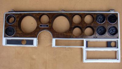

Bob Ellis Posted July 5, 2014 Author Posted July 5, 2014 gearhedjon, I have two possible routes; darken the windows (and add side windows) so nobody notices it's a Monte Carlo interior or attempt a GP interior. The dash is the big problem. It is really different. I can work with the rest of the interior. I thought about printing a dash and gluing it in? For a one car deal, etchings would be expensive. Any thoughts from others more experienced with this problem?
