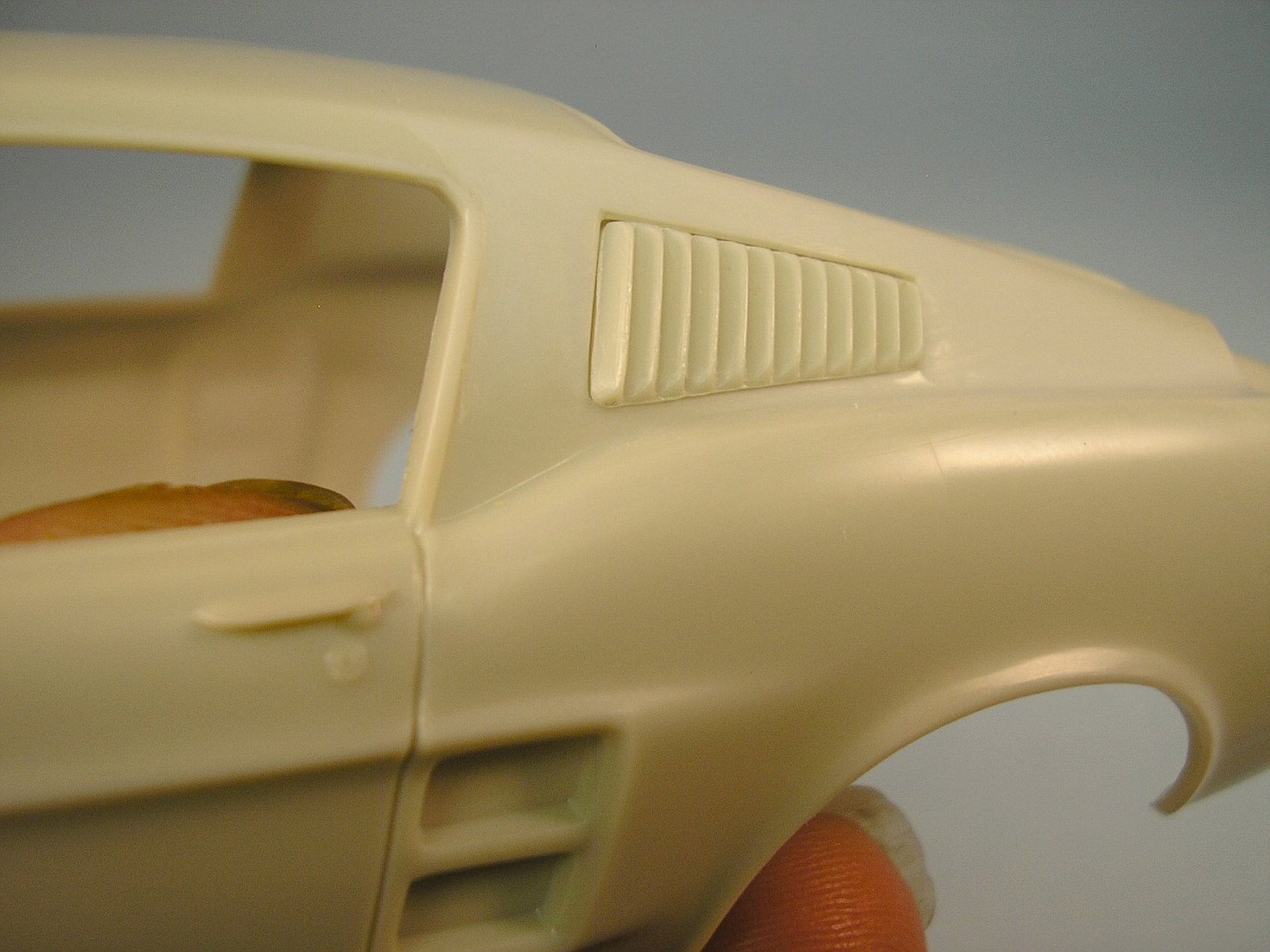

MrObsessive Posted July 4, 2014 Posted July 4, 2014 (edited) Since I'm stuck on the glass area of my '59 Chevy build (more on that later), I want to do something that won't be as crazy making, and won't have as many bells and whistles as the Impala. I looked around my stash and came across this..............AMT's 1994 release of the '67 Mustang GT. I figured it's kind of a Mustang year, so why not do something related to the 50th anniversary of this car? I originally thought about doing a '66 and backdating it to a '65, but that would take some work albeit somewhat minor, and I want to make this build as painless as possible...........or so I thought as you'll see!One of the first things I do per any "normal" build is the bodywork. Getting rid of mold lines, sink marks, and other maladies is Modeling 101. Your paint jobs will come out much, much better if the basics are done first. So, I started with what looks like a design issue with the body itself...........the roof vents.In this pic here, the roof vents were mounting too far into the body giving them a "tunneled" look. According to my many 1:1 pics of this car, the louvers should stick out ever so slightly beyond the bodywork, so I added these plastic tabs on the inside of the louvers to push them out slightly.Ahhhh......that's much better! No more tunneled look, and after everything's all painted, I'll position them in the cavity for the best appearance. I'll epoxy these in as I don't want the regular cement to distort these in any way.I don't know why AMT does this, but why aren't there positive locations on either the front end, or the rear section to be joined on the body?? It makes it difficult if not downright frustrating to get them to line up properly without some kind of positive location pin or whatever. I've decided to add my own positive locaters by cementing in these tabs. These were not only glued in with liquid cement, but after the glue was dry, I also used super glue to make sure there was no later movement when the front end was being glued on.I know, I've got to cut my nails! I didn't have time to get to the manicurist before making this post! Now this is looking like it should! I'll fine tune the lower edges ever so slightly to line up the lower valance with the leading edge of the fenders-------this was much better than trying to glue this on without going through that extra step.BTW, color will be the same as the box art car--------black with the red stripe above the rocker trim. Tires will be redlines---although I don't know if these would be totally correct for a '67. I just don't care for the plain-jane blackwalls, and if I were buying this car new in '67, that's what I'd want.I'll have more so stay tuned! Edited August 22, 2015 by MrObsessive Updating date
