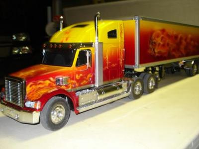

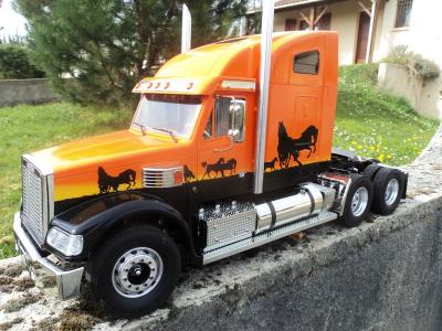

keone2013 Posted July 19, 2014 Posted July 19, 2014 I know the Knight Hauler is a good kit. Expensive though. And you need to buy a separate 4 channel remote. As far as I know, you have to build the whole kit, including the motor. I would research it more. Semi Joe on here builds a lot of 1/14 scale trucks. That's the scale for Tamiya's semi's. Hopefully this helps. Here are some pics. The first one is a stock one. The rest are custom ones. I like the second and third one.

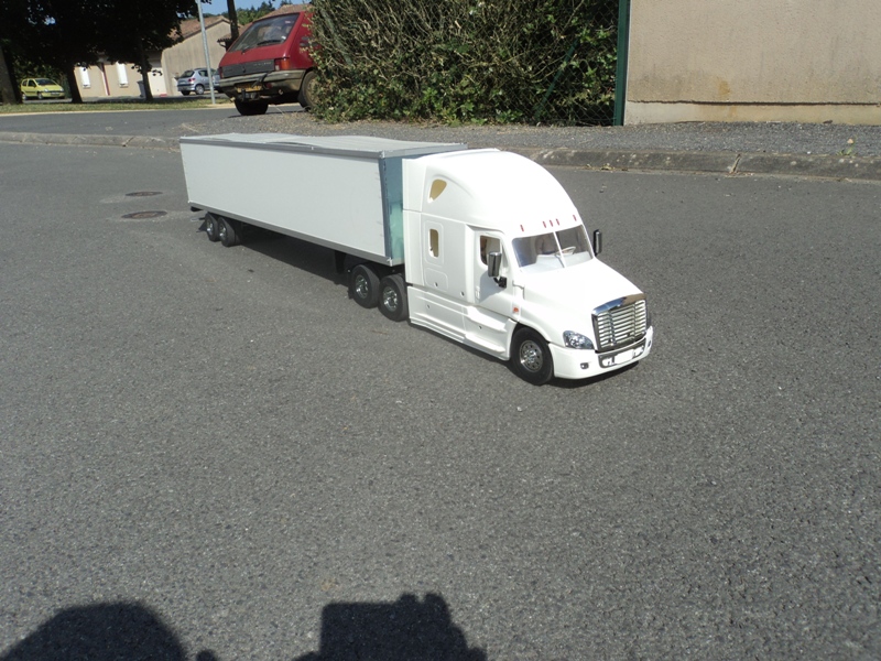

marcay Posted July 19, 2014 Posted July 19, 2014 hi here is a pic of my Knight hauler (its like a Freightliner coronado) and one of my new Freight Cascadia with my hommade 53' dryvan
BigBad Posted July 20, 2014 Posted July 20, 2014 This is one thing I'd like to try some day, especially after seeing the new Cascadia kit! From what you built, Marcay, I just might make a move! Very nice! I like the fact that you can make these move around, add lights and even engine brake and horn sounds. And being at a bigger scale makes it sweeter too.
marcay Posted July 20, 2014 Posted July 20, 2014 hi Robert the Coronado is full lights (Inside too and Dashboard), alu wheels, but no sounds. the Cascadia is new, I have juste made a flip hood you can follow them on my blog

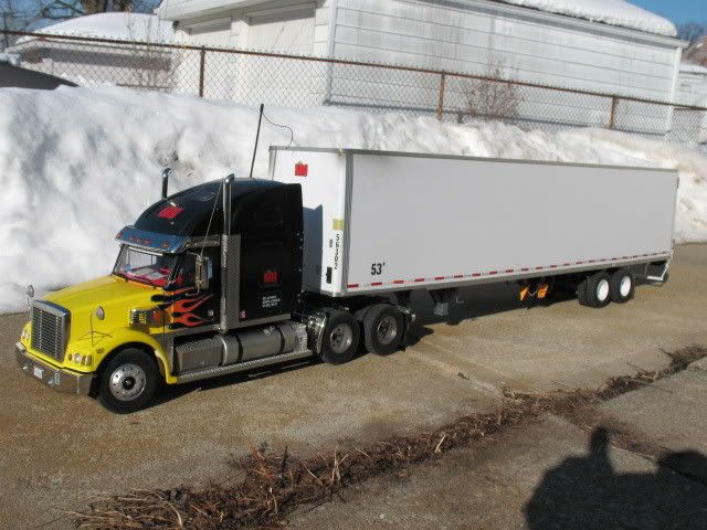

chuckyr Posted July 21, 2014 Posted July 21, 2014 Actually, the Tamiya scale is 1/13.5. They are all great kits, if not every expensive when fully decked out with all of the options. The choice is whether you are into Euro or American trucks. One of the complains I have is with the trailers. The length and dimensions of the trailers are wrong for North American style trailers. There is at least one after market builder that offers really accurate trailers. http://customrctrailers.com/
marcay Posted July 21, 2014 Posted July 21, 2014 hi Chuckyr its true ,US tamiya trailer are too shorts and not realistics (small 40' with frame) your trailers are so ...incredible. for à french guy and a little too much expensive with shipping to Europe !!! lol but I made my own dryvan 53' frameless like a Greatdane Champion CL her lenght is 1,14 meter (I don't know how to convert in feet and inch). she is very simply the width is 185 mm and the hight is 305mm (a little too hight) you can follow her construction on my blog my dreams are a cattle trailer or a movin van to make one of the big US movin company (Mayflower, Allied, Northamerican ) I bellong this trailers in 1/87 scale For all US trucks friends, excuse my english so long Thierry
