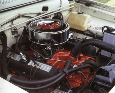

jjsipes Posted July 22, 2014 Author Posted July 22, 2014 (edited) Looking for valve covers to match these. 273 HiPo Small Block for 1965 Barracuda Edited July 22, 2014 by jjsipes

Jon Haigwood Posted July 23, 2014 Posted July 23, 2014 (edited) I found these for my 66 build pic is small but they look like the 273 valve covers you are looking for. In 64, 65 were basically Valiants with a Sports roof, in 66 the removed the Valiant badging on the grill and replaced it with a Barracuda. http://www.madmodeling.com/store/ccp0-prodshow/Small+Block+Mopar+Peformance+Valve+Covers.html Edited July 23, 2014 by Jon Haigwood
