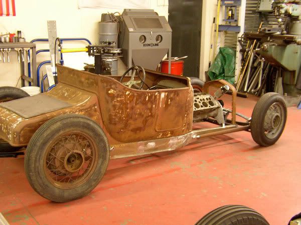

Bernard Kron Posted September 2, 2014 Posted September 2, 2014 In the 1:1 world it depends on the T. A "Bucket T" tends to be a '23-'25. If there's a traditional T on Deuce rails it's the '27. The earlier "buckets", not so much... But I was curious if one could be done successfully. This one's a work in progress I found on the H.A.M.B. but it shows that a well proportion T-Bucket on Deuce rails is very much doable and would actually be pretty tasty:
Ace-Garageguy Posted September 2, 2014 Posted September 2, 2014 You'll have to narrow the frame and pinch it in front at the cowl even more. You can see it on the frame in the pic Bernard posted. If I were you, I wouldn't do a front zee, but do a suicide perch, again like Bernard's pic. You'll definitely want a rear zee to get a nice ride-height, but the '32 frame isn't the easiest to zee. I've just about settled on doing my own 1:1 next rod on '32 rails, using a '26-'27 glass body, and I've been doing the measuring for cut / paste in full scale. Narrow the frame first to fit the body shell you're using, and to keep everything square. Then zee the rear end to get the ride height in back. Finally, do the pinch of the rails under the cowl (which amounts to a lateral zee), and fab a new front crossmember to carry the suicide perch.
jbwelda Posted September 13, 2014 Author Posted September 13, 2014 hey thanks for the ideas and for the pictures! I had forgot all about this thread but the frame has been sitting on a bench with the body next to it so maybe some osmosis will happen! my original thought was a 27 but the reality is the Big T body, and am not enough of an expert to know what needs to be done to update it to a 27. I know the light mounts on the body need to go but also I believe there is cowl work to be done and some other not so subtleties. I would be using a turtle deck like the one shown too. I really like the sculpting of the deuce rails and would want to preserve that...I think I agree pinching the frame will be necessary and I also agree on the suicide mount instead of Zing the front. still its just a dream sitting there right now. thanks again jb
