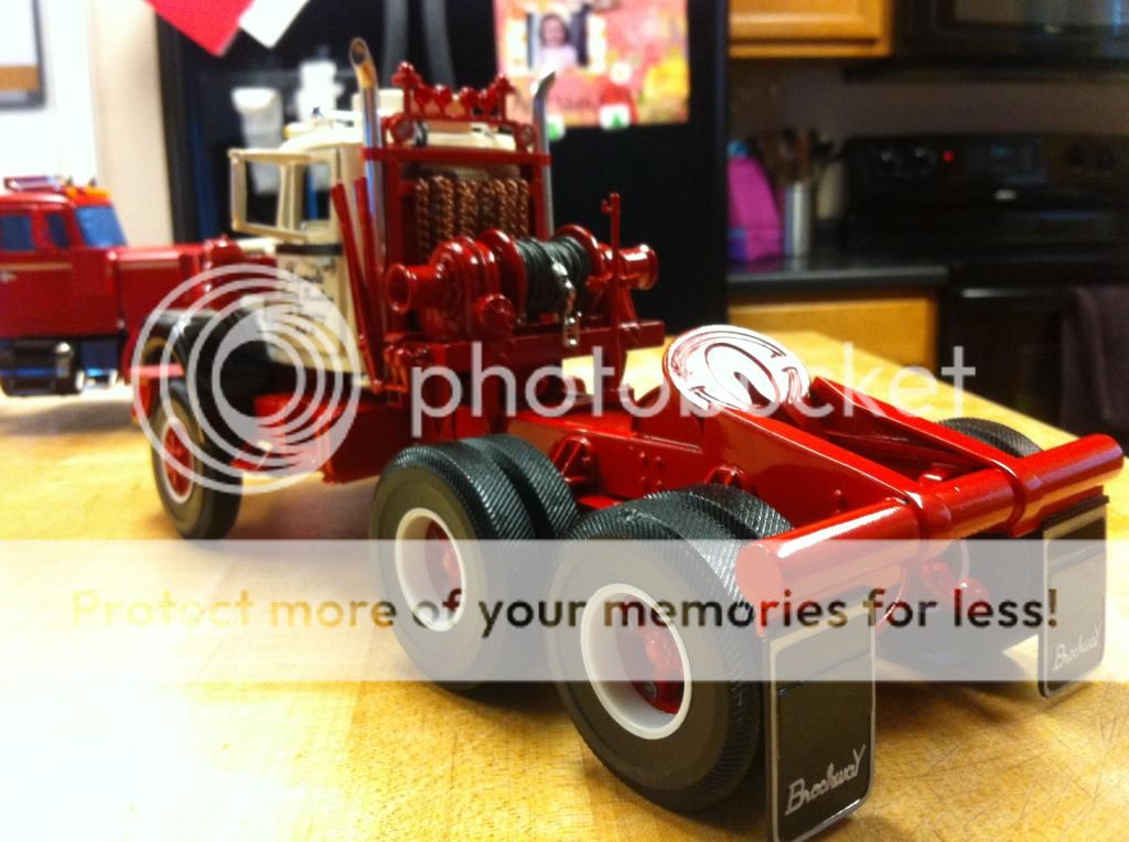

redneckrodder Posted September 14, 2014 Share Posted September 14, 2014 Looks sweet if you paint the a/c and mirrors black it would look like theres alot less white Quote Link to comment Share on other sites More sharing options...

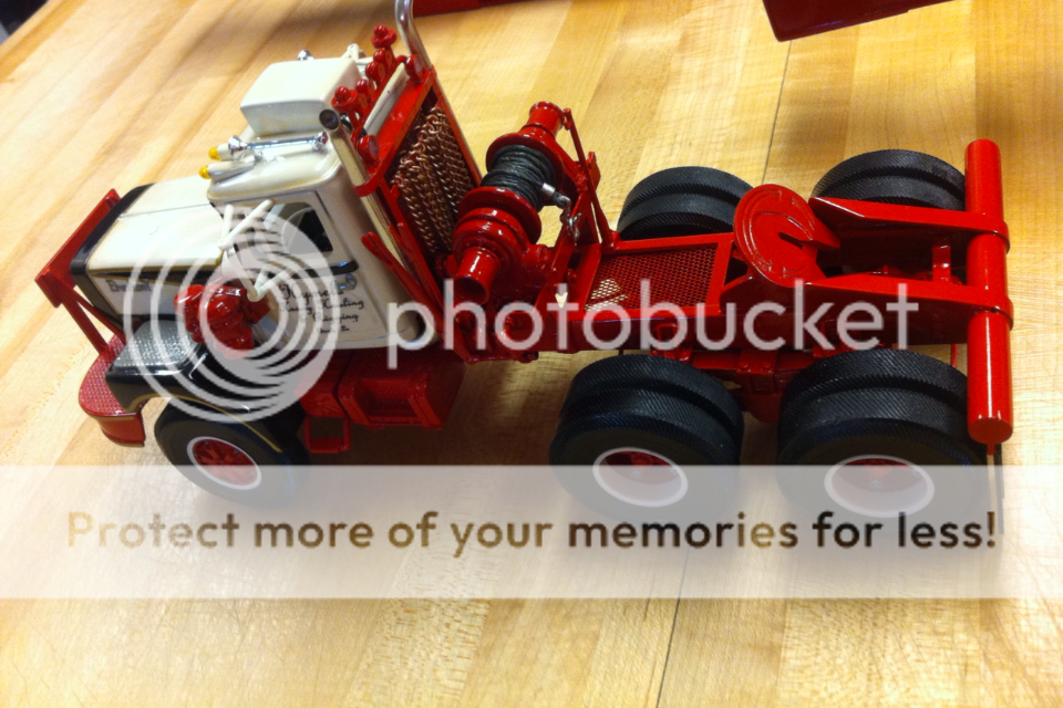

Tesla Posted September 14, 2014 Share Posted September 14, 2014 Almost there Terry...the winch detailing is superb!! You should consider selling an accessory kit for the winch The flaps are awesome Quote Link to comment Share on other sites More sharing options...
landman Posted September 14, 2014 Share Posted September 14, 2014 Terry, did you machine the rods & bushings in the winch or are they simulated with wire & tubing? Nice job, by the way. Love it. Always wanted to build an oilfield rig. I'd have your thread in front of me all the way. Quote Link to comment Share on other sites More sharing options...
Superpeterbilt Posted September 14, 2014 Author Share Posted September 14, 2014 Terry, did you machine the rods & bushings in the winch or are they simulated with wire & tubing? Nice job, by the way. Love it. Always wanted to build an oilfield rig. I'd have your thread in front of me all the way. The rods are 1/16 alum welding rod, and I did machine the collars. I just turned down some .250 round stock and drilled it 1/16. The linkage for the levers is plastic using rods and tube. Quote Link to comment Share on other sites More sharing options...
Old Buckaroo Posted September 14, 2014 Share Posted September 14, 2014 Nice job, by the way. Love it. Always wanted to build an oilfield rig. I'd have your thread in front of me all the way. Make that two of us ! Terry this just gets better and more inspiring every time I look at it. Those Hymel brand tires are just awesome ! Keep up the Spectacular work. Quote Link to comment Share on other sites More sharing options...

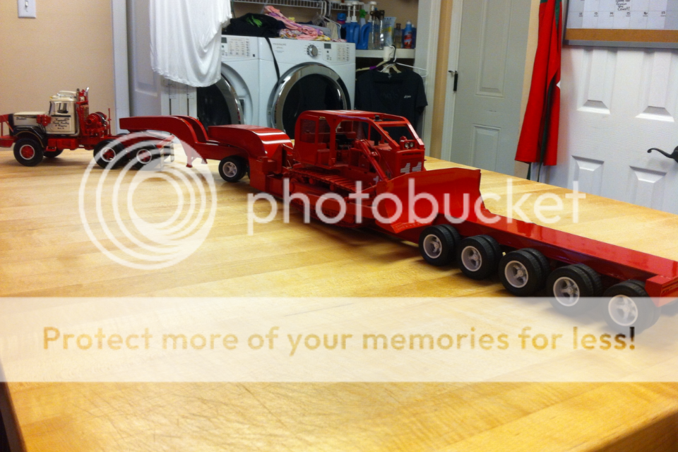

Superpeterbilt Posted September 14, 2014 Author Share Posted September 14, 2014 Thanks guys. This has been one of those builds that just keeps pushing me a little further. It was hard getting certain things just right. I removed and reglued the fuel tanks and battery boxes at least 10 times trying to get them exactly right. The winch really took almost as much work as the whole truck. The trailers really ate my lunch trying to get them just right. Heres the trailers with some paint. They still need some wet sanding and more coats, but heres the mock up. I havent had any time to work on the train, so it will probably go to show with my diecast dozer on it. Quote Link to comment Share on other sites More sharing options...
