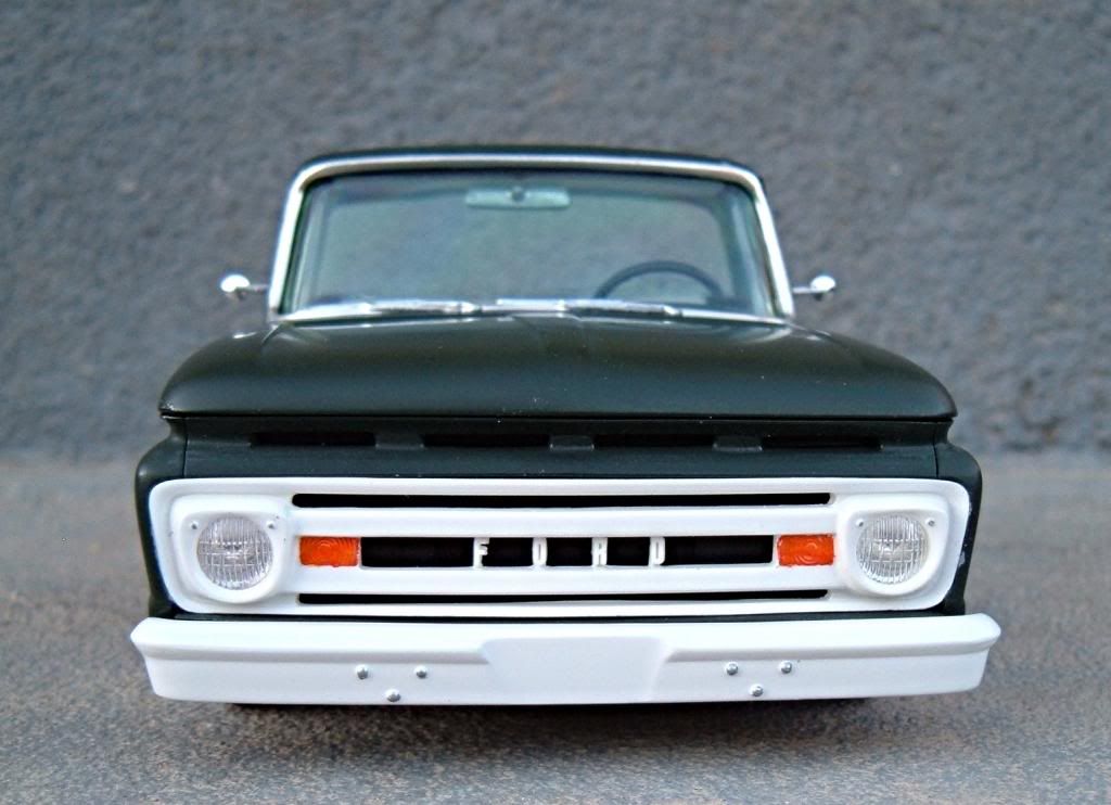

Porscheman Posted August 1, 2014 Posted August 1, 2014 Go to a good model train hobby shop and get some MV's. These are excellent lens, with a chrome backing, in various sizes and colors. I would bring the grill with you so you can get the right size. I've been using them for years and get a lot of comments on them. Hope this helps.
Bob Ellis Posted August 1, 2014 Posted August 1, 2014 Good idea about the MV lenses. They have part numbers but I have found it difficult to figure which size to use, so another good idea to bring the part to the store.. A really good model train shop should have them.
Ramfins59 Posted August 1, 2014 Posted August 1, 2014 Yes, MV lenses are good for a lot of model car applications. Not only are they made in larger sizes for use as headlights (except for not having the grid lines on the lens), but various other sizes and colors can be used for taillights, backup lights, interior dome/courtesy lights, dashboard indicator lights and in some cases side marker lights. As long as the light you will be using them for is round they work perfectly.
Porscheman Posted August 1, 2014 Posted August 1, 2014 The MV's are very cheap and make a fast and clean replacement.
Chris White Posted August 3, 2014 Posted August 3, 2014 Al, you are a lifesaver, I have been struggling with this for a while. Thanks for the great suggestion. How about square headlights ???
MrObsessive Posted August 3, 2014 Posted August 3, 2014 (edited) MV lenses are a great alternative for headlight replacement. When I was building my '69 Daytona Charger years ago, and I wanted working headlight doors, MV lenses came to the rescue. We have a local train shop just south of me in Gettysburg, PA called Tommy Gilbert's. Tommy has just about every size and color imaginable of MV lenses. Purists though might not like how the lenses don't have the grid that regular headlights have. But for those projects that you may not want to raid other kits for its headlights, MV's are the way to go. Edited August 3, 2014 by MrObsessive
