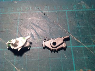

Here is the engine gearbox etc. broken down from the attempted assembly.

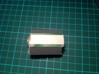

That said, I have almost completely rebuilt the engine block so far.
I started with the view that the angle of the vee in the block was not even correct.
post-12304-0-59429500-1408054092_thumb.j
As you can see I had to further cut the block up into the upper and lower portions of each side, as changing the angle at the top to be steeper, left the bottom too wide to be in scale, and so I cut the lower portions off to re angle those, to get the corrected shape and angle, and still have the bottom of the block the right size so I didn't invent an oversized oil pan
Once I established that I worked out length and width of the block. This has been an education for me, that despite liking model cars, I'm not very mechanically minded, and so I first realised that the left and right banks of the block are slightly offset to allow for piston movement, etc, was a mini revelation.
Imagine my surprise when the kit engine didn't represent that offset

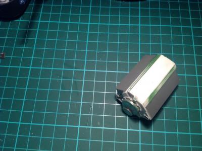

So then I spent a bit of time filling in the gaps, setting the right angle etc, and this is the result so far. The grey is the kit parts, the rest is my work.
post-12304-0-11701400-1408054318_thumb.j
And then I worked out that the front of the block, was not flat, but had a distinctive timing cover, and other aspects that I have attempted to recreate. To create the timing cover, I created the oval shape out of sheet styrene, then a circle and some inner arms to create the "peace" like symbol at the top of the cover.
I then added a couple of circles of plastic for the shaft housing and covered the whole thing in a foil, that you get at the top of "Milo" tins in Australia.It is thicker than aluminium foil, and when burnished down gently into the shape I've created it gave me the look of pressed metal, something that I couldn't recreate just with plastic, and I think the effect looks quite good.
I added some punched out hex bolt heads and added it to the front of the block, along with some details on the block include welsh plug holes - called something different in the states.
Note in the following that the left hand side of the block as you look at it has been hacked back to create the depth that I am building back up to represent that side of the block. As you can see between the two photo's I've added the fuel pump housing to the block on the left giving it that distinctive outline.
post-12304-0-47577300-1408054444_thumb.j
Some more images of the block so far, showing that not one dimension was close to correct on the block. But that is what I am aiming to learn how to do. In hindsight, I could have started with sheet styrene and created the block from scratch, but this has been very enjoyable to challenge myself so far.

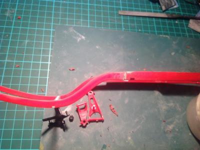

Next up is to develop a bell housing, and gear box. However I have stopped the engine for the moment, to start on the chassis. I have no measurements of the chassis, and have relied heavily on the reference pics I have that include a number of the underside of the car.

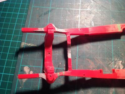

In those images the front of the chassis has amore pronounced curve, so I cut and repositioned, glued reinforced and have started to fill in the gaps.
post-12304-0-56573600-1408055763_thumb.j
Further work on the chassis includes reducing the overall height of some aspects of the mid chassis, and filling the whole chassis in to suggest a boxed structure, plus some new straight cross members, to support the gear box etc.
That's all ahead.

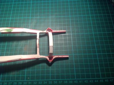

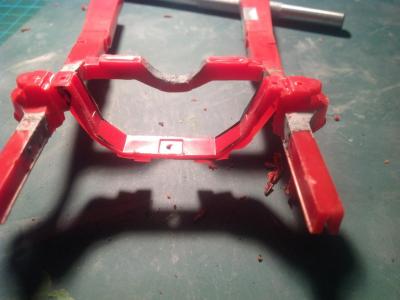

So boxing in the frame has taken some effort, with some grinding of the sides of the frames down mid chassis to closer match my references, plus filling in all the location points that are for the fenders etc, that are not attached to the frame above, but below, and bolted on, not incorporated into the chassis.
Some parts of the frame required some framing first, and other thinner sections were filled in with sheet styrene, and the first of the putty was applied.
The frame once boxed in will still need some modifications and some further cross bracing etc.

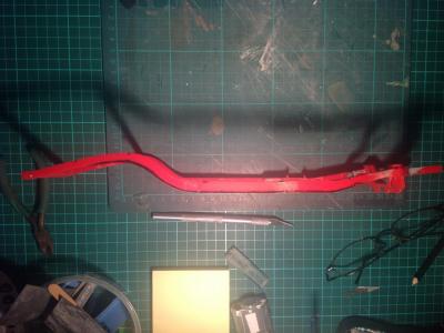

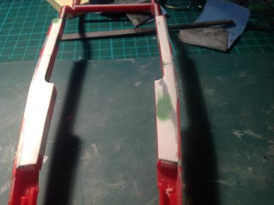

Just a quick update on the frame.
I've worked out the front part of the frame was both too wide and not angled enough up to the side rails, so first thing was to grind off the front of the frame, and cut it back to scale width.
post-12304-0-84021000-1408588695_thumb.j
post-12304-0-42642100-1408588936_thumb.j
Now to fill it in and blank it off like the rest of the frame.

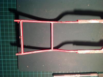

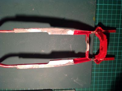

Here is some progress shots of the chassis that I have blanked off so far.
It's taken a bit of time as the side rails had to be reduced in height and to achieve balance across both rails took time and care.
Also the curves at the back of the chassis were the wrong arc, so they too had to be carefully ground back and a steady hand and eye to make sure I kept them even as well.
post-12304-0-91400800-1408588838_thumb.j
post-12304-0-31663300-1408588882_thumb.j

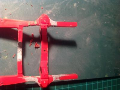

More progress on the frame. Keeping the flipping thing even is a challenge, but I've blocked out the remainder of the front of the chassis, and thinned out and removed a heap of material that was just plain wrong.

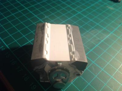

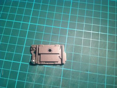

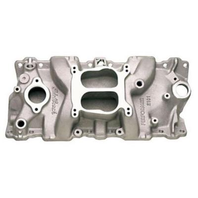

While I was waiting for the fourth lot of putty to dry, I started on the intake manifold.
I am basing it on the Edelbrock manifold as below
post-12304-0-24889900-1408963075_thumb.j

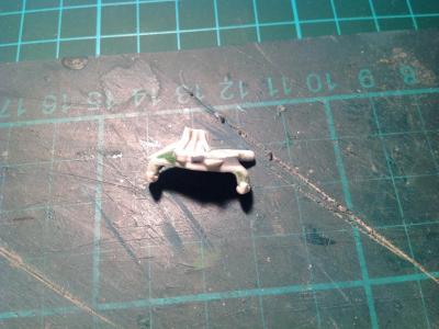

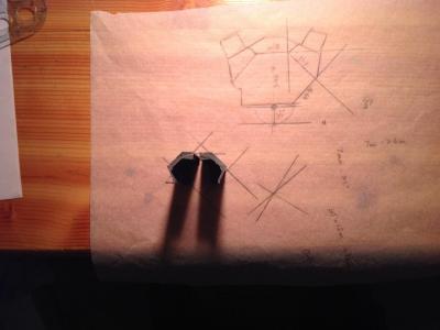

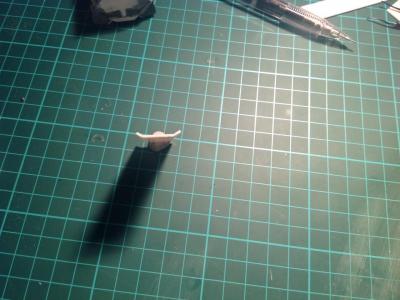

I thought I would share how I am going to make this part as the kit part is just sh$t
post-12304-0-97015200-1408963356_thumb.j

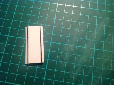

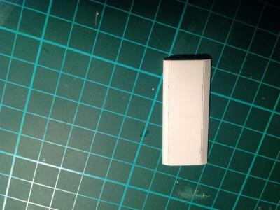

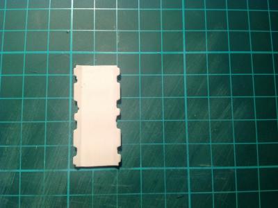

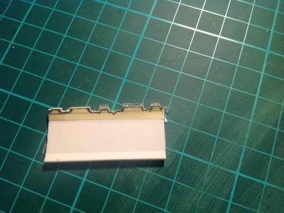

So I measured out and cut a section of styrene, scored both sides to give me the flanges, and filled the gaps with stretched sprue.
post-12304-0-98518700-1408963438_thumb.j
post-12304-0-00567900-1408963464_thumb.j
post-12304-0-40916500-1408963492_thumb.j
Then using the image I measured out the flange pattern and created a template in post notes and attached to the side of the piece and ground and filed the shape, then repeated for the other side.

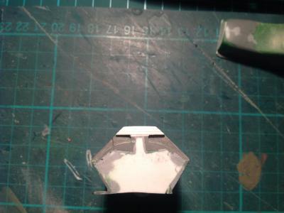

It doesn't look to bad on the engine block.
post-12304-0-43359800-1408963520_thumb.j
post-12304-0-60680900-1408963571_thumb.j
post-12304-0-05116400-1408963914_thumb.j
From here I will build up the detail and add it to the bottom piece of the manifold.
