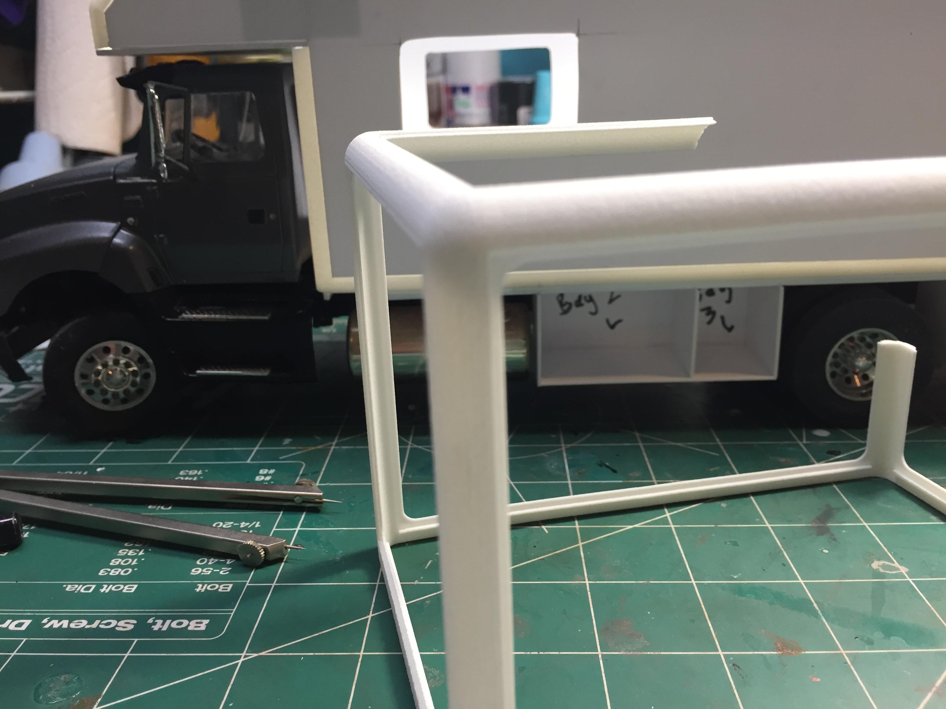

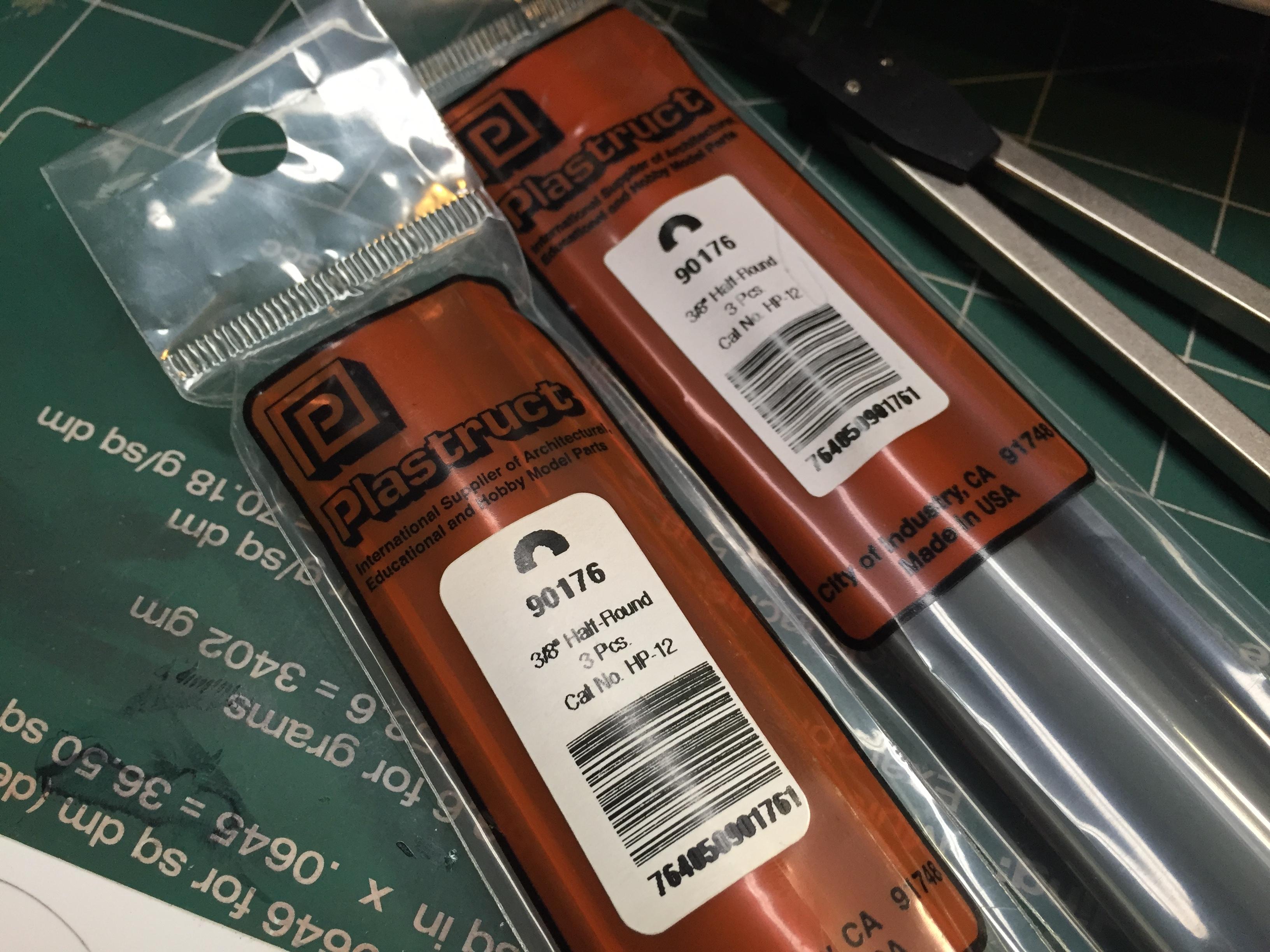

vincen47 Posted January 18, 2020 Author Posted January 18, 2020 7 hours ago, kilrathy10 said: This is one outstanding piece of art in the making.... I look forward to more of this build... The biggest thing that makes it stand apart from just about every conversion I've ever built; the rounded edges and corners.... I'd love to get my hands on a bunch of half round styrene.... Where did you get that?? I can't find any of that stuff to save my life... 1 hour ago, DZ7581 said: I am interested in how you did your corners and what you used. I have a project which requires a similar corner and I have no idea how to do it. Yes, the radius corners were a huge sticking point and the search for suitable material contributed to slowing the project down. Most all of these 1:1 conversions have a 5 or 6 inch radius to all of the corners, and that was a must for this project. 1/4” quarter-round is really hard to find. I finally found 1/2” half round from Plastruct, and ordered direct. It’s not styrene, it’s butyrate, Product number 90176. Still would require splitting it down the middle, of course. I was about to start the project with that stuff, but happened upon an eBay listing for 3D printed truck sleeper frames. I bought one frame, a 120” version with an angled front wall, (used part of it to make the bunk, and for below the floor line) and also asked the seller if he could make them longer, and he was happy to do so. I sent him the specs I was looking for, a 1/24 scale 100” width and height, and 288” in length. The seller is thorloveseleanor. He doesn’t list anything like it now, but I bet he would still make them. There’s a market for stuff like this. Having the frame basically ready to go has simplified and made the build much easier and faster.
kilrathy10 Posted January 18, 2020 Posted January 18, 2020 2 hours ago, vincen47 said: Yes, the radius corners were a huge sticking point and the search for suitable material contributed to slowing the project down. Most all of these 1:1 conversions have a 5 or 6 inch radius to all of the corners, and that was a must for this project. 1/4” quarter-round is really hard to find. I finally found 1/2” half round from Plastruct, and ordered direct. It’s not styrene, it’s butyrate, Product number 90176. Still would require splitting it down the middle, of course. I was about to start the project with that stuff, but happened upon an eBay listing for 3D printed truck sleeper frames. I bought one frame, a 120” version with an angled front wall, (used part of it to make the bunk, and for below the floor line) and also asked the seller if he could make them longer, and he was happy to do so. I sent him the specs I was looking for, a 1/24 scale 100” width and height, and 288” in length. The seller is thorloveseleanor. He doesn’t list anything like it now, but I bet he would still make them. There’s a market for stuff like this. Having the frame basically ready to go has simplified and made the build much easier and faster. Whoa!!! Thanks, Bud... I totally appreciate the info... This will, definitely, be worth some investigating... Awesome....

vincen47 Posted January 18, 2020 Author Posted January 18, 2020 (edited) 5 hours ago, oldr-n-drt said: cary...yall are looking for 1/4 inch half round ( .250 x .250)?? oldr-n-drt Yeah, the closest thing to it I could find was 1/2 inch half round (1/4 inch radius, half inch diameter). I was able to find 1/4 inch quarter round wood, which I thought could be smoothed and used to create a mold and then cast resin quarter round. But, I eventually was able to find the 3d printed frame option, though it wasn’t cheap. Ideally, 1/4 inch radius quarter round plastic or resin would be needed if I wanted to make a bunch of these RV conversions and stacker trailers (which I do) economically. Edited January 18, 2020 by vincen47

vincen47 Posted January 18, 2020 Author Posted January 18, 2020 Unfortunately, number 90172 is 1/4 inch in diameter, that would create 1/8 inch radius. They also make actual quarter round styrene rod, but the biggest is .125 or 1/8 radius, too.

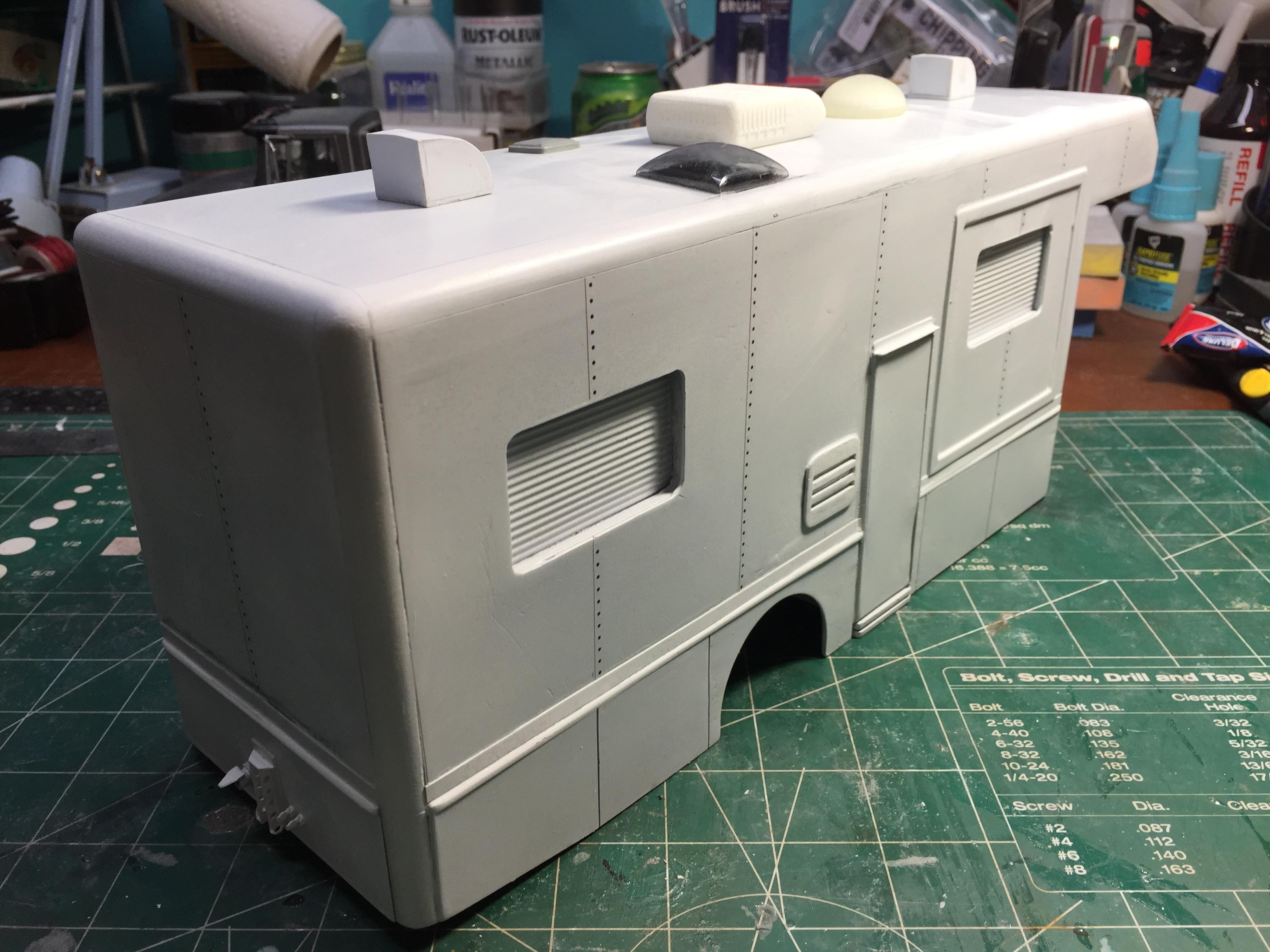

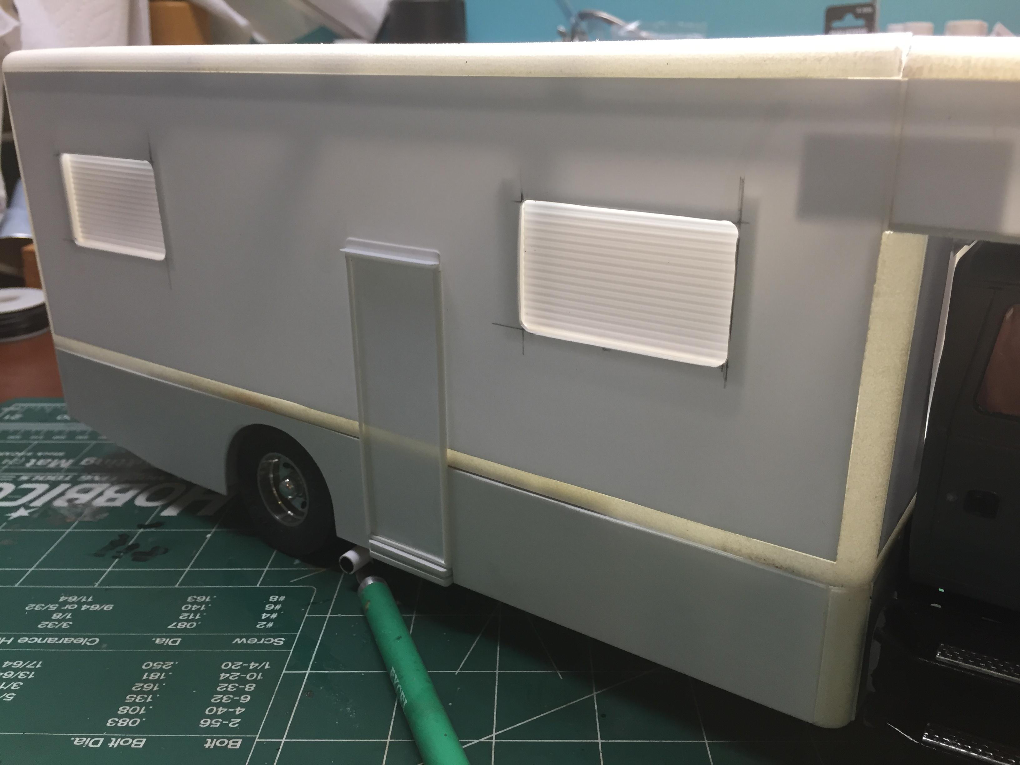

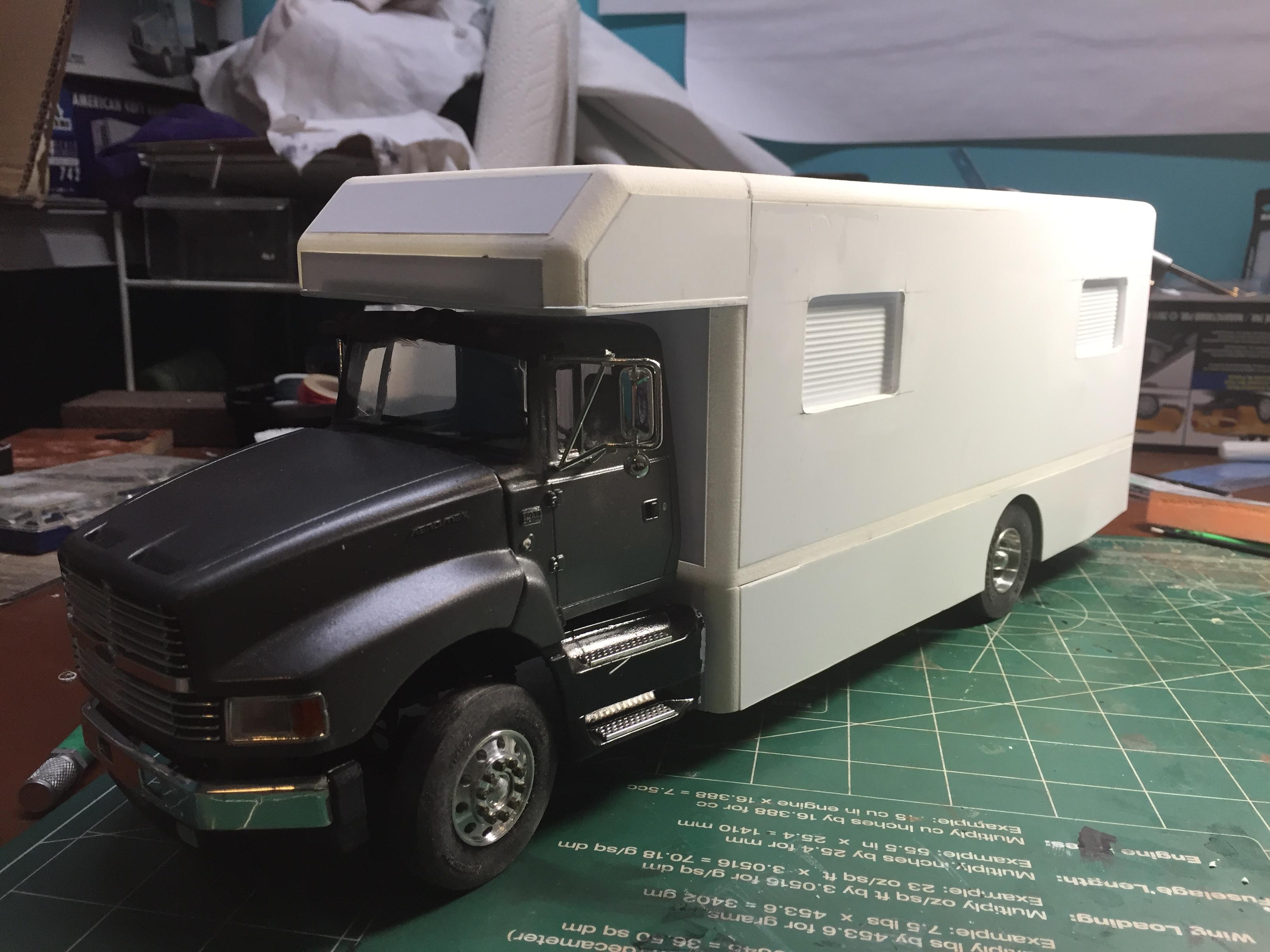

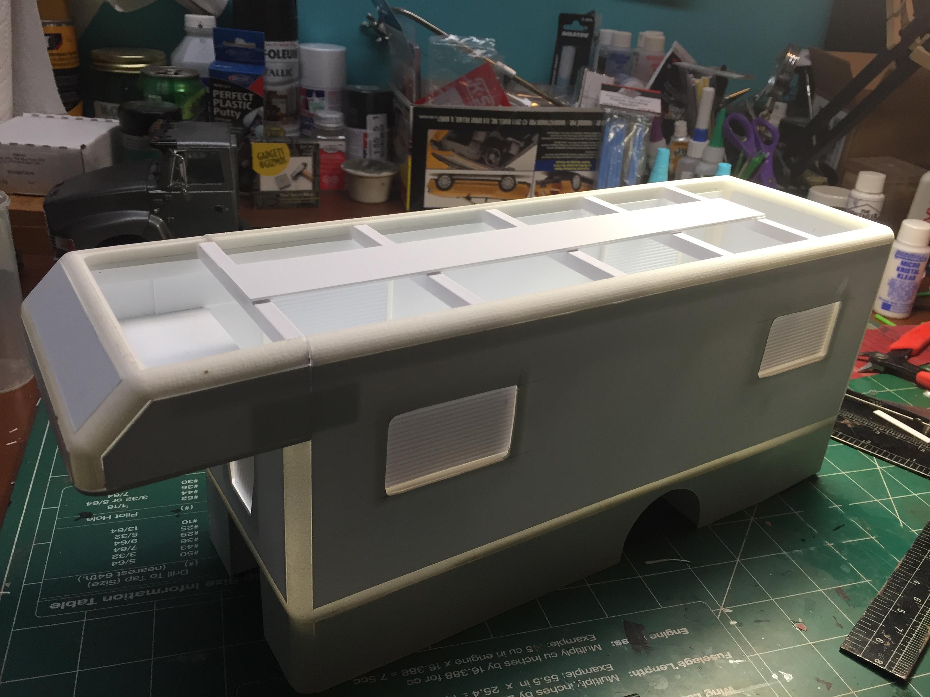

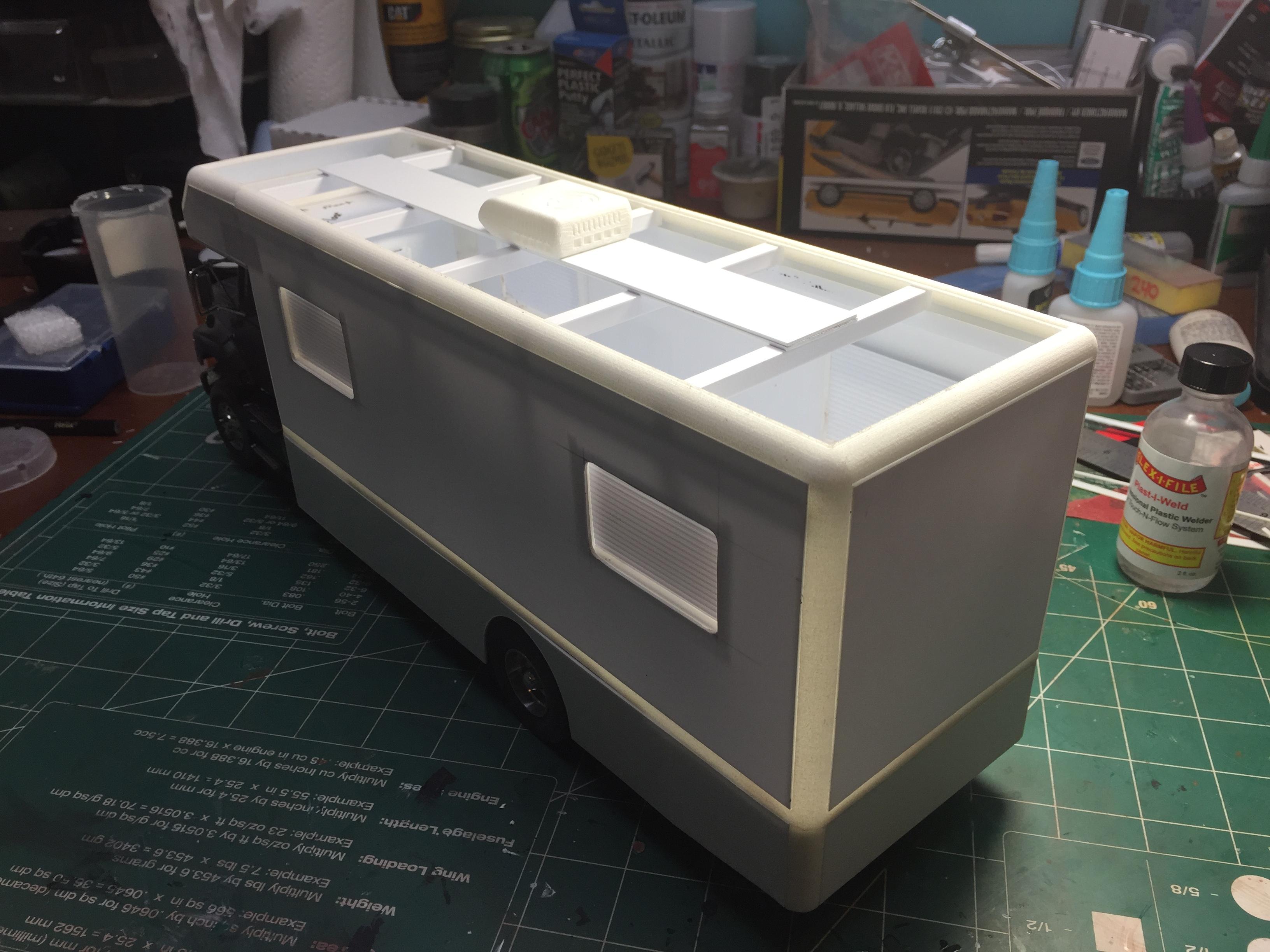

vincen47 Posted January 23, 2020 Author Posted January 23, 2020 Got more work done on the RV body, mainly below the floor line and the side door with the retractable step. I also made the interior window frames and shades. Next will come the roof and bay doors/lower trim. Lots of sanding and filling. But, I’m loving this project. I hope it’s the first of several enjoyable conversions.

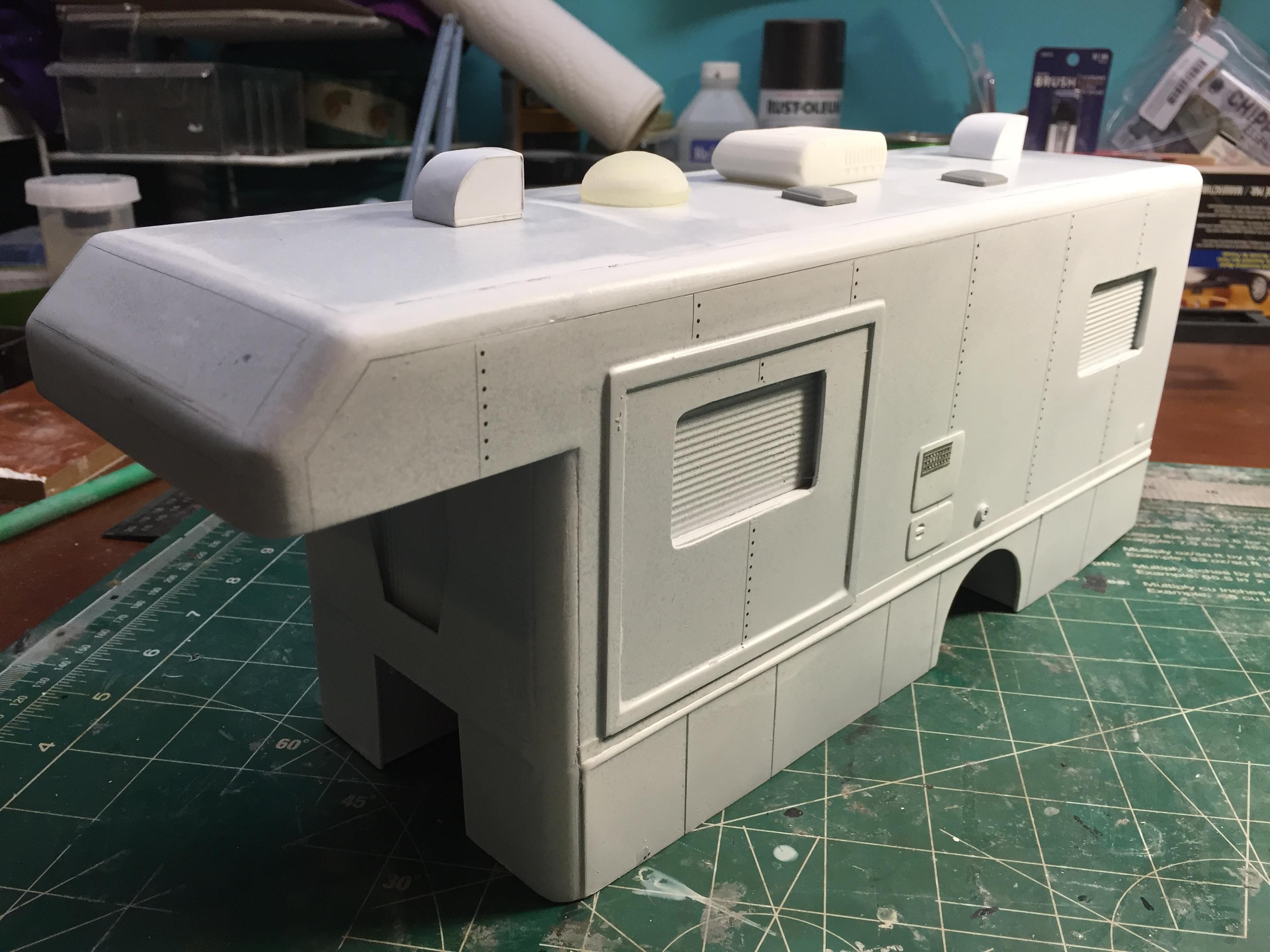

vincen47 Posted January 30, 2020 Author Posted January 30, 2020 The coach body is just about ready for paint. The hobby gods should be pleased with all of the sacrifice in sanding I’ve had to do. Still a lot more to go, but I can see the finish line.

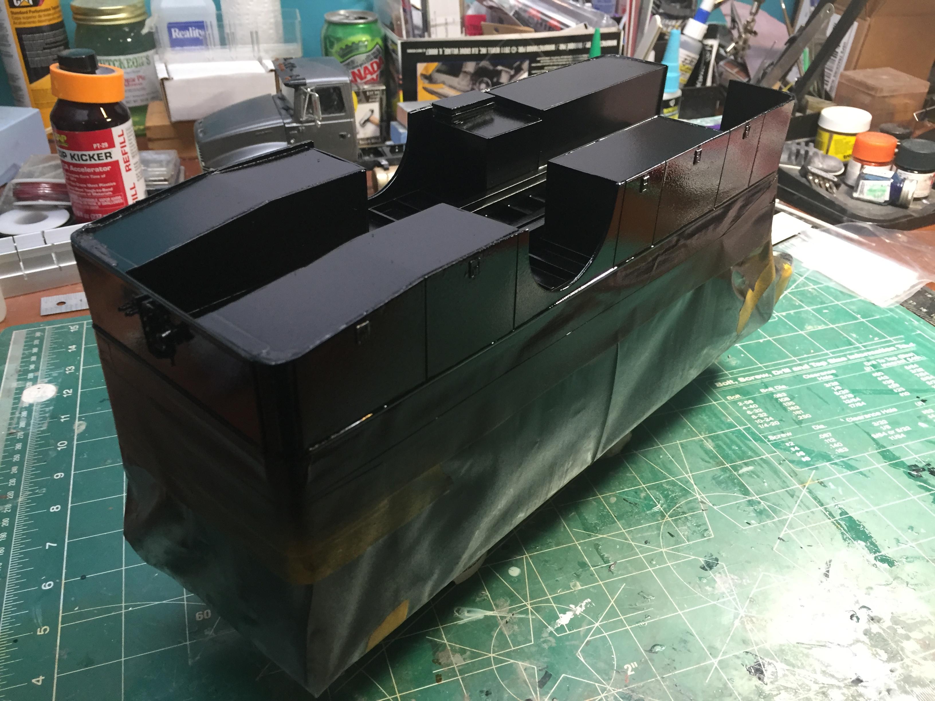

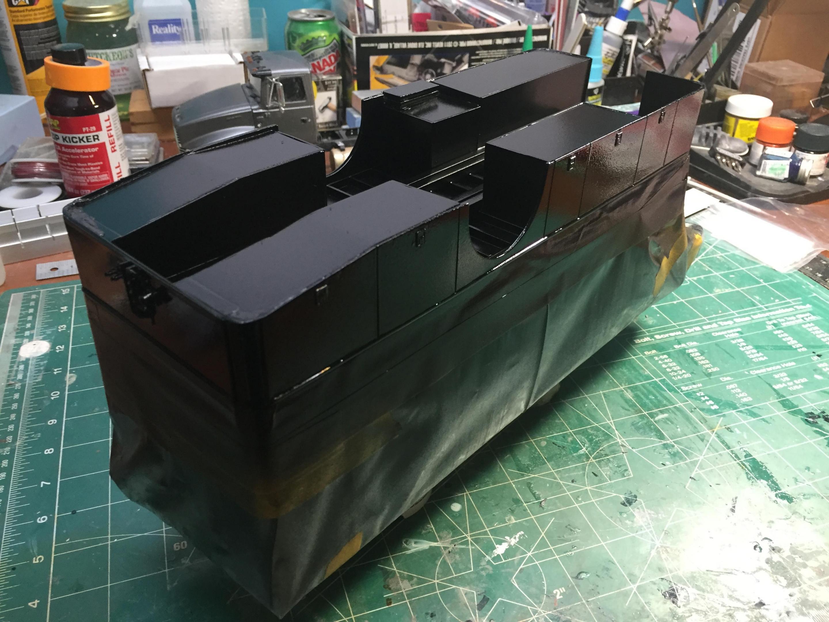

vincen47 Posted February 16, 2020 Author Posted February 16, 2020 A quick update, I’ve got the two tone paint laid down, just did the black below the floor line. Watching the paint dry...

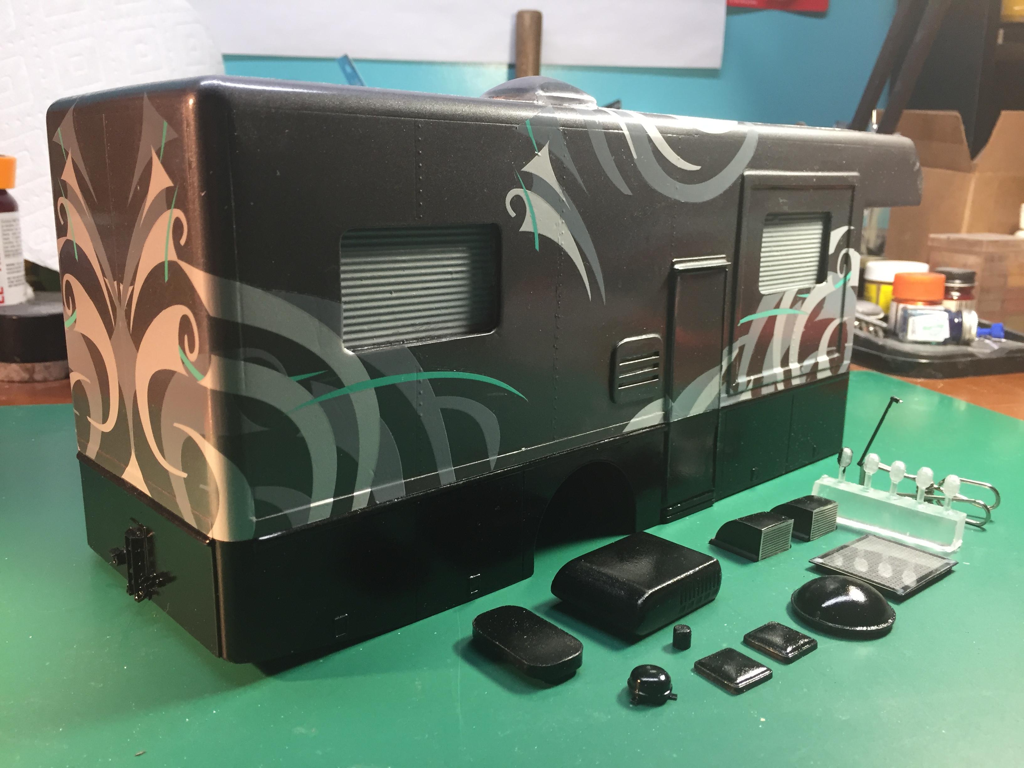

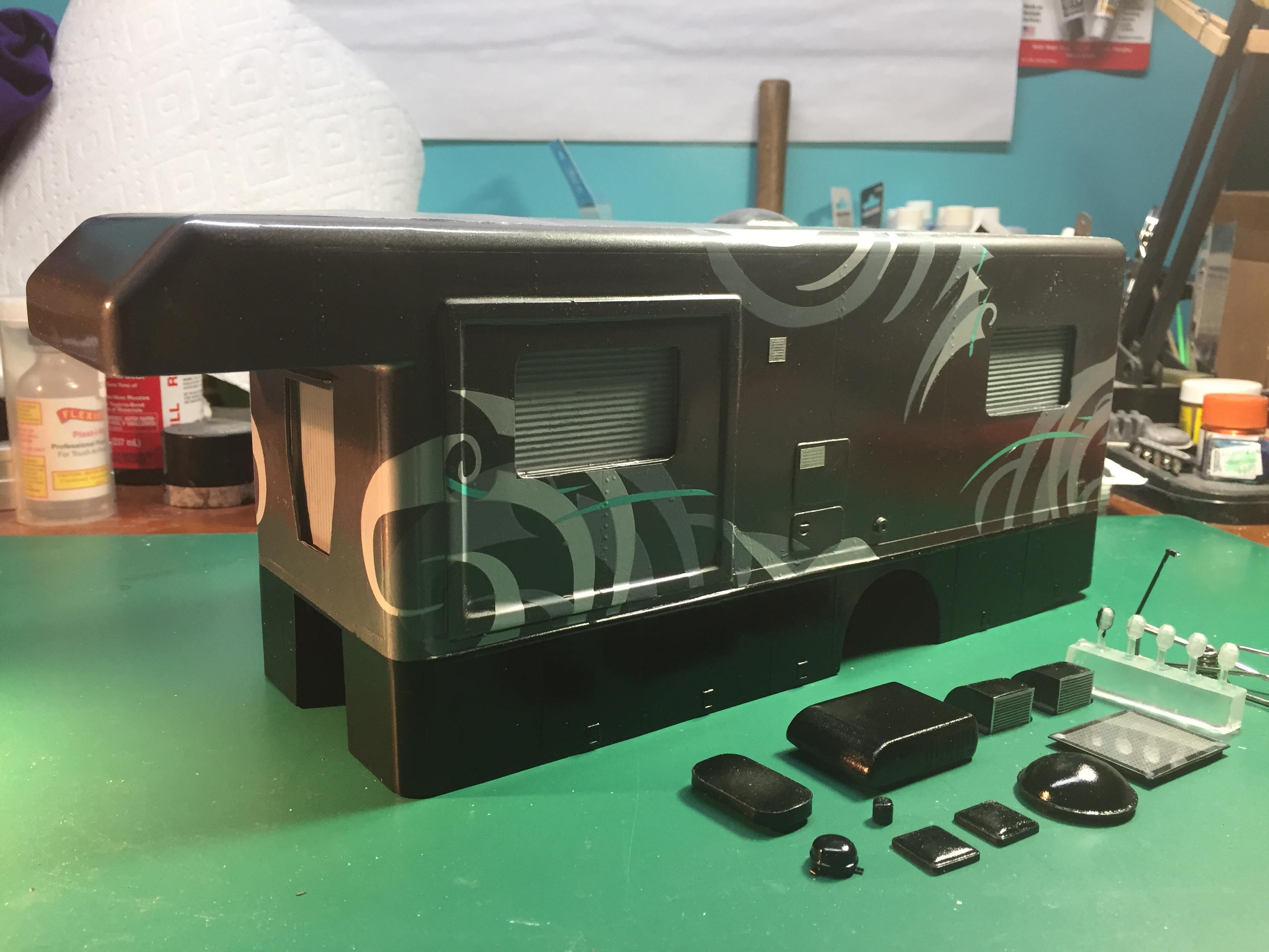

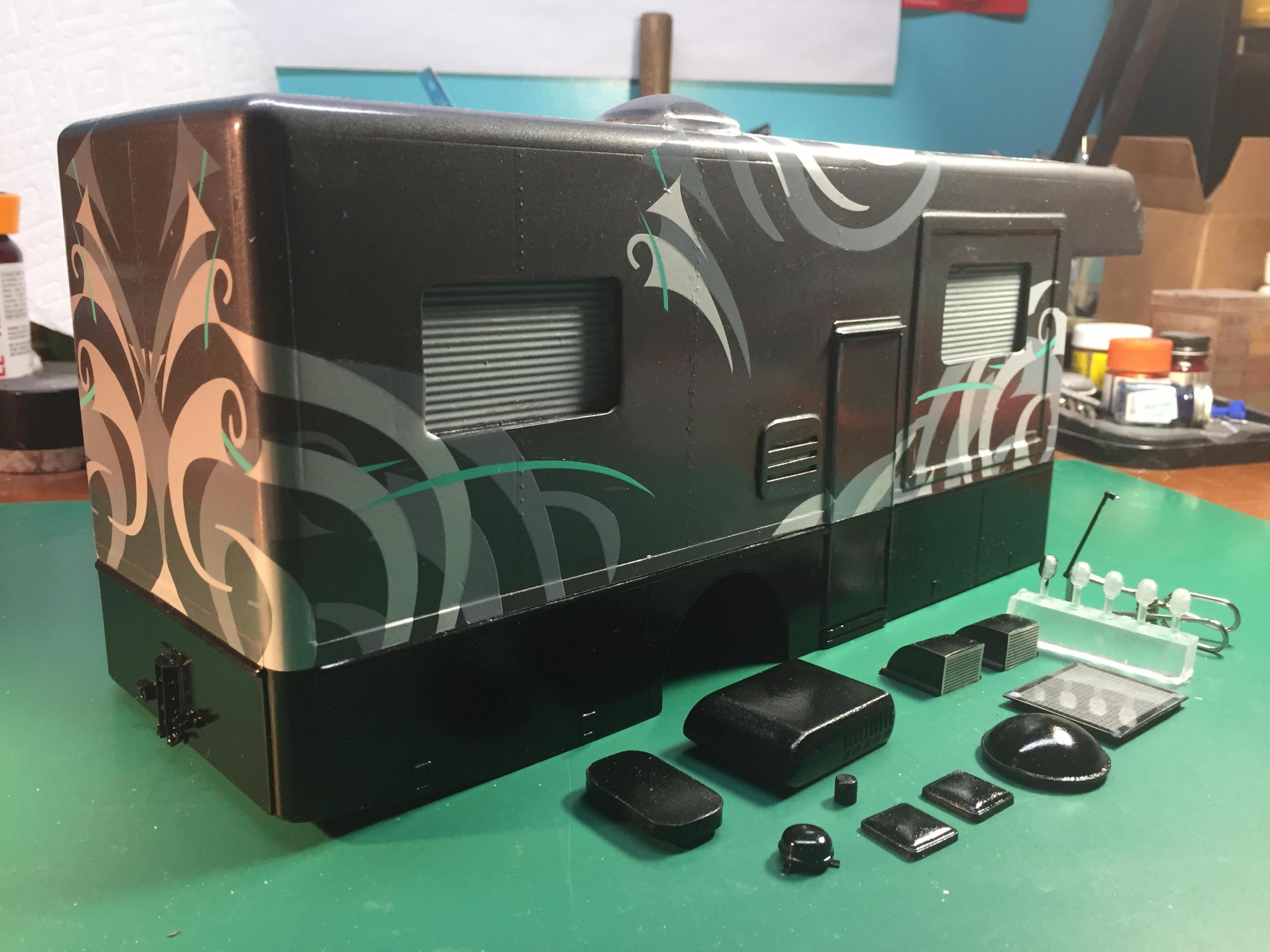

vincen47 Posted February 19, 2020 Author Posted February 19, 2020 Thanks guys! Another quick update... Paint and decals are done, I think. Now I’m on the final lap with adding mostly rooftop parts, awnings, and the windows. There’s also few things to do on the cab and chassis before it joins the RV body. On a side note, I finally turned over the cutting mat. It was fairly new when this project started (and stalled), seen it’s share of glue drips and paint spills since.
