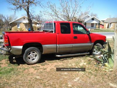

addicted2modeling Posted September 14, 2014 Posted September 14, 2014 (edited) I'm in the process of building a '99 Silverado model kit, the stock version without the drop package. I want to paint it in Duplicolor's GM victory red over pewter metallic...I have a few questions to ask before I paint the body. 1. Should I use another brand of hobby-grade clearcoat, like the rare Tamiya TS-13 Clear or Testor's "Wet Look" clear to cover my Duplicolor'sbasecoat paint? 2. Since "Perfect Paint" by Alex Kustov mentioned that metallic paint is best clear coated before polishing, should I take heed to his advice? The lower portion of the truck will be painted in a metallic paint, Duplicolor's pewter metallic. And since the top portion is non-metallic do I have to clearcoat it together with the lower portion before polishing? 3. If I were to go against Kustov's advice and just polish the whole thing prior to clear coating, should I mask off the top end so that the removed paint on the polish cloth won't smear the bottom part? 4. And are Gundam black markers are idea for painting the fine black trim lines the front window outer gaskets? This is how I want to paint my model truck like. Edited September 14, 2014 by addicted2modeling
